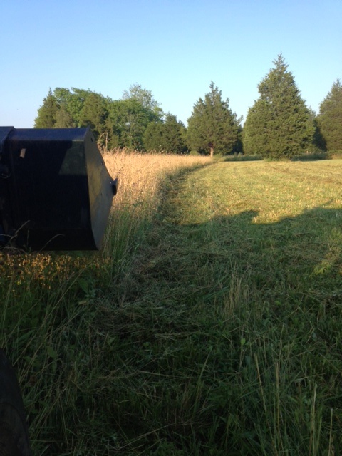

the streaking grass in the pictures above look to me like tire tracks from the tractor, the tires pus the grass down and it does not spring back up for the blades to cut it in time,
It may be one side has a higher lift type blade on it and or the rotation is opposite and show more on one side,
Exactly. ... Try reverse. ... OP tractor has tires in line, running over grass twice before the mower. For all we know the tractor that produced good results was a tricycle.

Hello all, I have a New Holland 4835 with a unknown problem and I need your help. I use a 12' Landpride Mower on this tractor. For some reason the mower started streaking grass 2' from the left wing. I thought it was the mower. I bought this mower new and this occurred my first year using it. I thought it was a leveling problem. I had the mower at two dealers and everything checks out fine. I connected this mower to another tractor and it did fine, no streaking in the grass. This past winter I replaced the pto clutches and plates. I did find one clutch that was shaved half the way around to the metal. I thought for sure that I had fixed theproblem. Well no I have not, it is still doing the samething. I checked the hydraulic pressure and it is what it supposed to be. I have changed the filters and fluid. I did hear a noise after running the tractor for awhile and it sounded like a rattle, but when I press the accelerator the noise quits. I tried to pin point where that noise is coming from and its hard to determine. I have included a picture what I am talking about. I just wanted some advice on what is causing this or what I need to do next. View attachment 377691

What I am saying is the problem is fixed and it had nothing to do with the tractor. Don't know how swapping the gear boxes including stump jumper and blades from one side to another fixed the problem. Nothing to do with rpm of tractor or cutting direction. We all know that streaking will occur on turns but mines was in a continuous straight line.

No, sorry sound guy but it is not the operator. In fact a technician came out and used my tractor and he cut with it and no changes. Full throttle did not change anything. Off setting the mower did not change anything, going in reverse did not change anything, but what did was the swapping of the gear boxes, that fixed the issue. That recommendation came from the manufacturer. It worked that's all I know and now I am happy.
