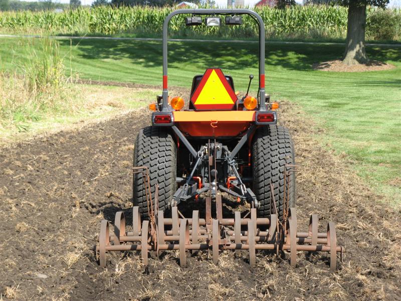

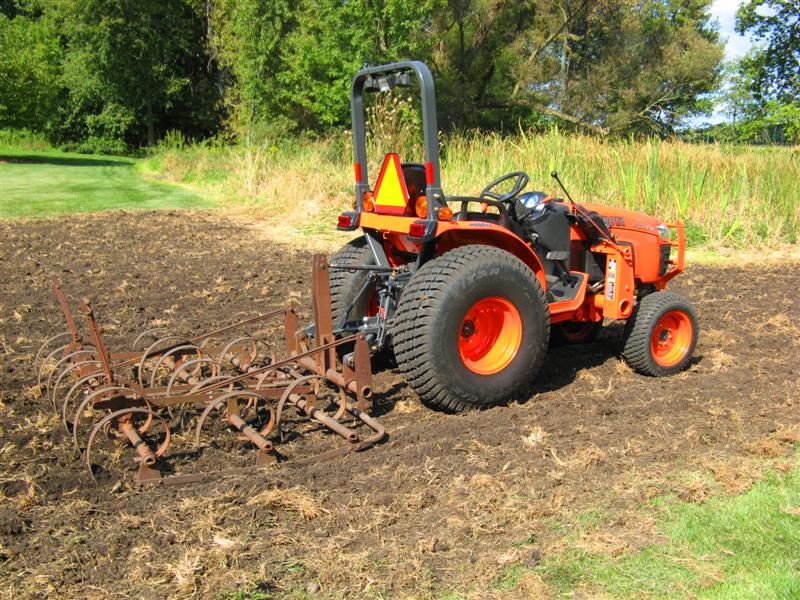

They can be hard to find these days but a spring tooth drag works much better than a spike tooth for leveling ground, IMHO. They work pretty good for breaking up clods, too. My dad used both and says the springs are much better. I know the springs do a good job but I personally have no experience with a spike. All we used on the farm when I was a kid was springs. I have used a small section that I could pull with my garden tractor for years on lawn projects. Last summer I salvaged an ancient Ford 3PTH spring tooth from my neighbors fencerow. I plowed and then leveled off some reclaimed swampland with it and a roller. I could easily drive a car on it. Good luck.

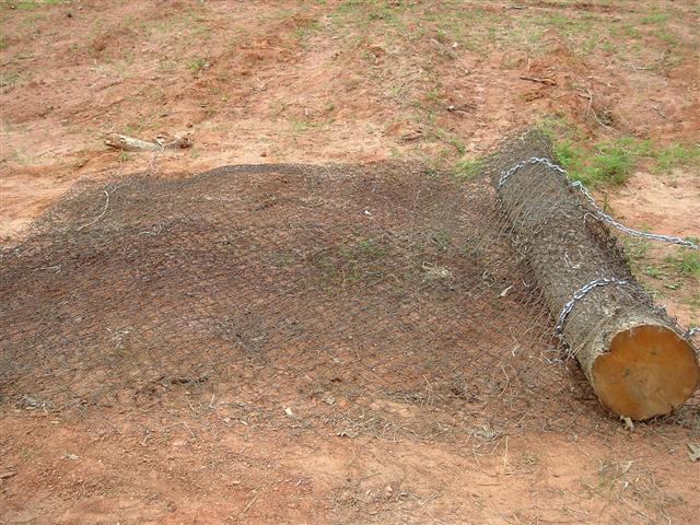

I'd build a log harrow. Find a straight lenght of oak, or something heavy, and cut it as wide as you can pull behind your tractor. I pull an 8 foot one that's 18 inches thick behind my 35hp 4wd tractor. I have a length of chain wrapped around each end of the log that I loop over my tow bar. Then I have a length of cyclone fence wrapped around the log to help smooth things out.
The disk breaks up the dirt. The more you disk the land, the softer the soil will be and the easier it will be to smooth out. The log will plow the high spots and fill the low spots. It wont move allot of dirt, but it will move some. If you have really bad areas, it will ride up over them and make the smoother, but it won't take them down. You'll need to do that with a FEL or box blade. Then go over it with the log drag.
I've been using mine for 4 years, and it's one of my favorite implements. Also my cheapest!!!!

I understand about over thinking these things, but in this case, I don't see how you will gain anything with more then one log. The key to the log drag is the log being big enough to work as a plow on high spots and to be able to push dirt forward to fill in the low areas.
It wont level a field, but it will make it allot smoother. I've tried and tired, but my log just isn't big enough to move enough dirt to remove a real high area. For those, I use my FEL or backhoe and dig them away. Then the log drag is awesome at smoothing it out.
More logs wont do anything for pushing the dirt, but having the largest, heaviest one that your tractor can pull will.
My neighbor tried to build one out of channel iron. The idea was that the front of the iron would break off the high spots and spread the dirt back to the the rest of a frame that he welded up. Unfortunately, it was too big and if part of it lifted up, it didn't do anything.
A length of railroad track would work great, as will some I beams or just about any heavy iron with sharp edges. My other drag is a pair of oversize forks for a very large forklift. Each fork is over 300 pounds. I can pull them with my 35 tractor on solid, dry clay, but if I hit anything soft, I'm not moving. With my 80hp backhoe, I can pull it through just about anything. It's heavy, but it does a great jog at smoothing out my roads.
