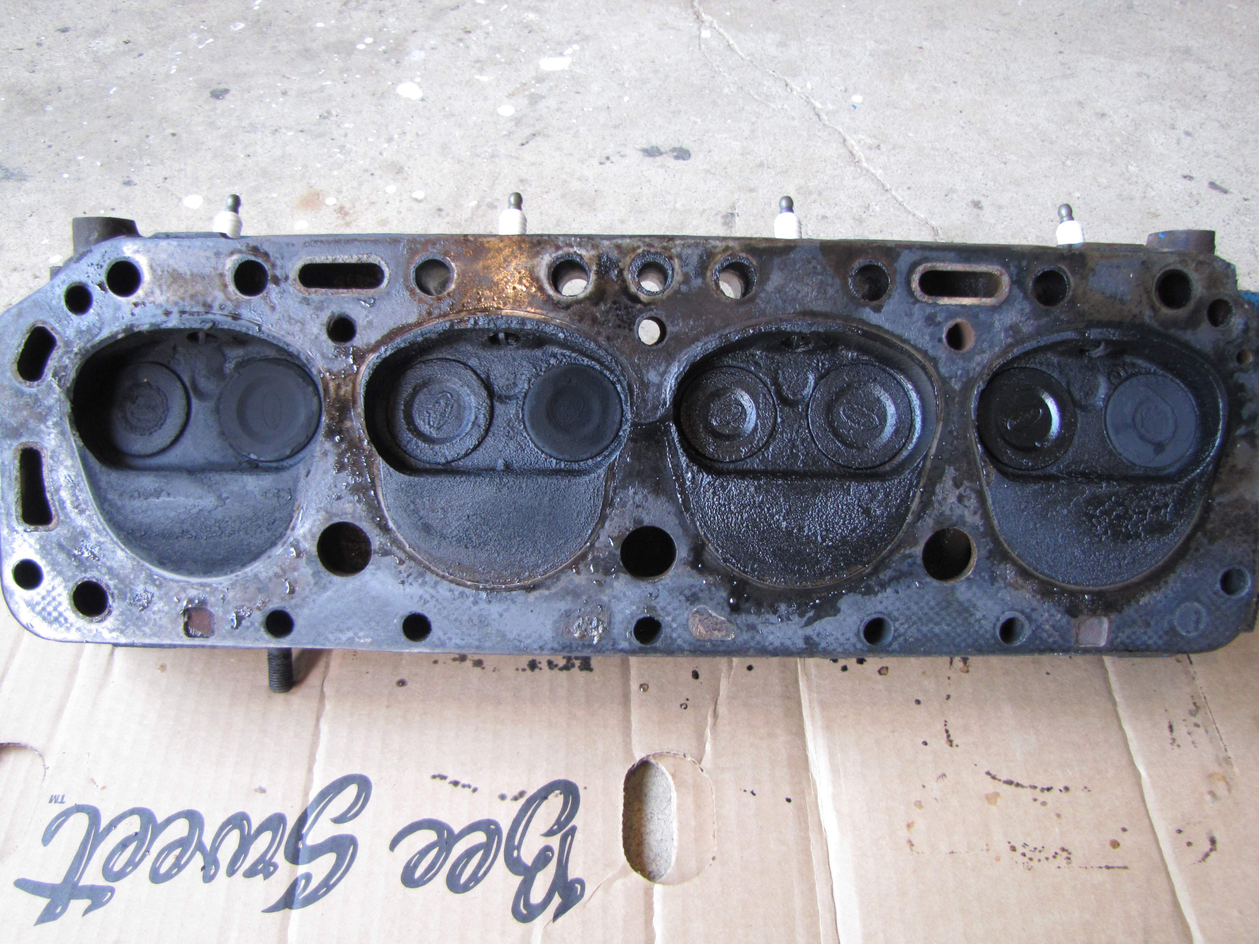

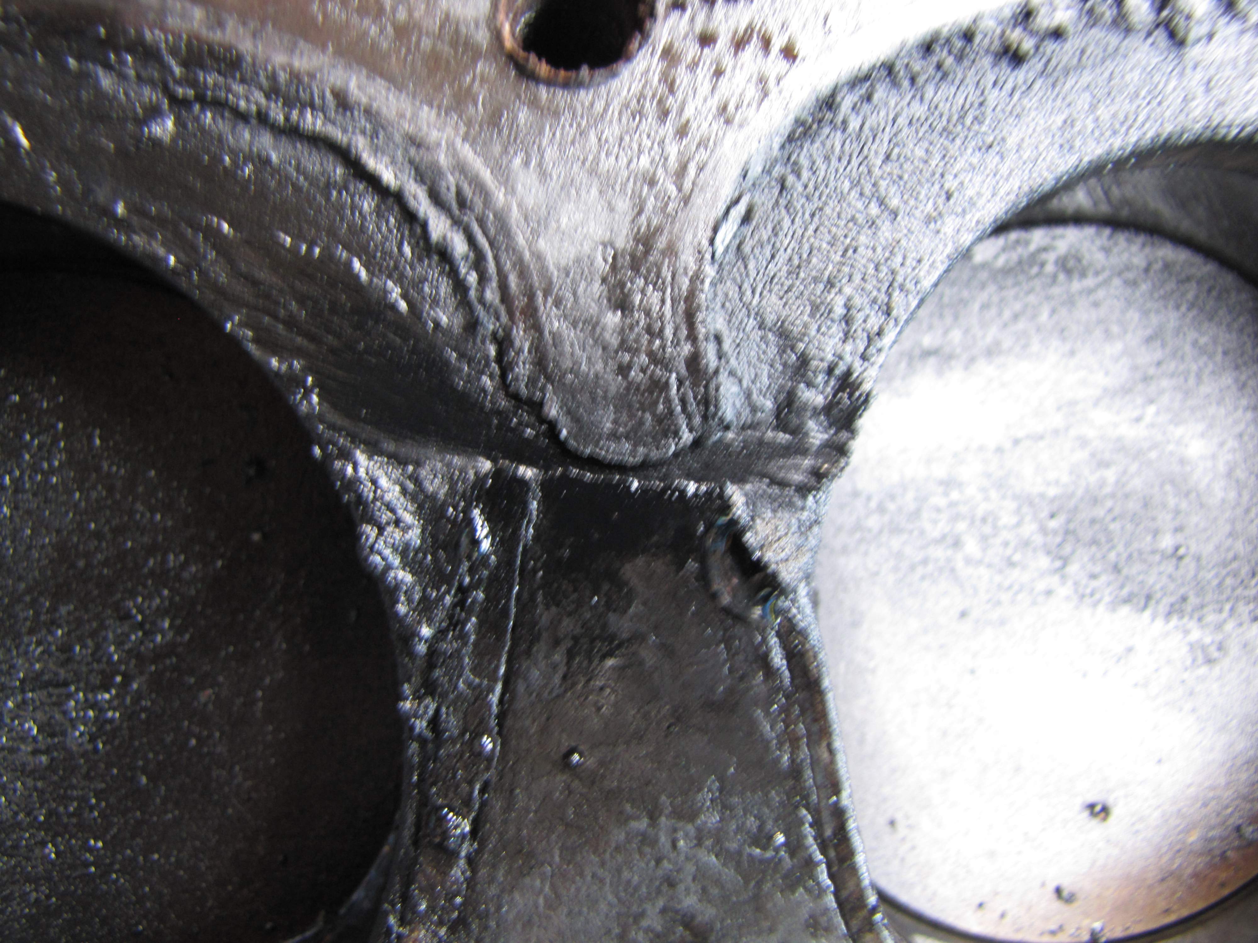

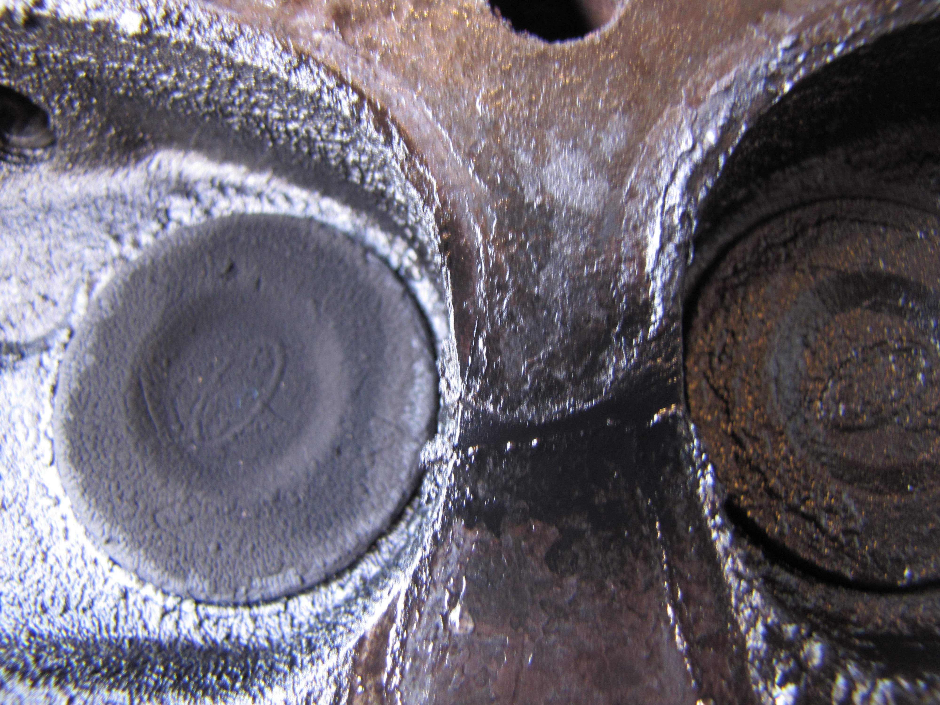

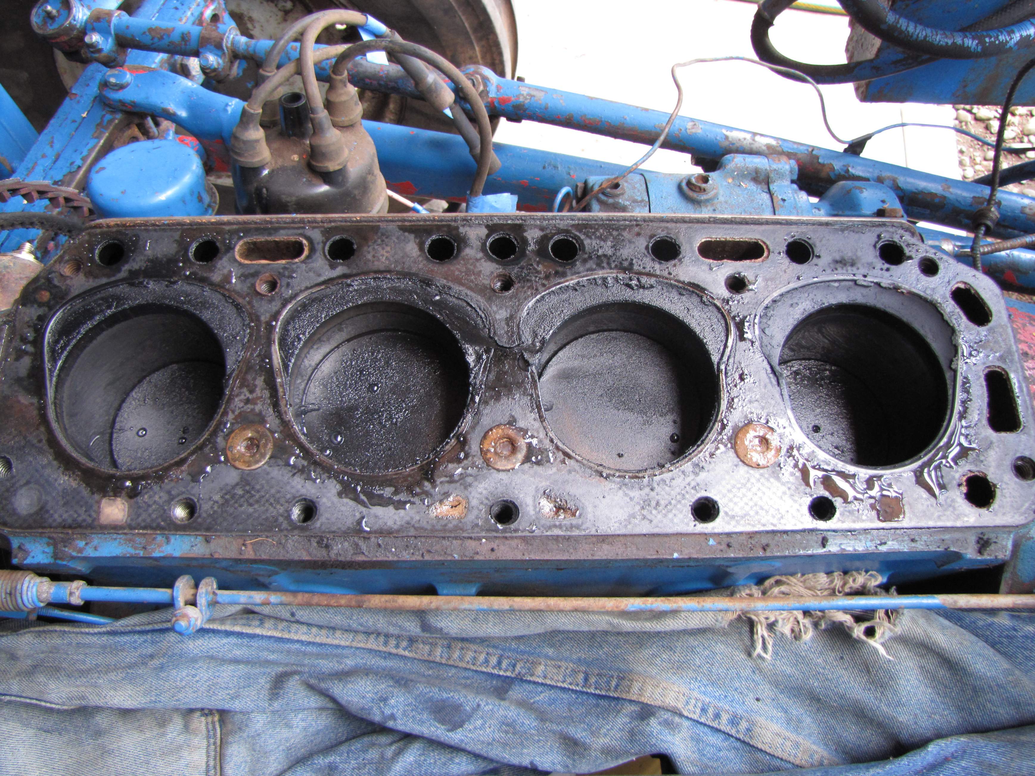

Well I flushed out some gunk from the cooling system. Looks like it wasn't nearly as bad as I thought. The low spots of the system (petcock on the block and the radiator drain) had lots of granular stop leak type stuff in it, once I got the goop out things started flowing pretty well. The radiator is a lost cause though.
Got the head off and found...(drumroll)...head gasket was blown between numbers 2 and 3! There doesn't appear to have any appreciable damage to the metal of the head and block.
So anyone have good ideas on prepping the head and block for the new gasket? I figured I'd run a tap in the bolt holes to clean them out. Carefully scrape any remaining crud from the surface of both head and block. With rags in the bores, clean everything with brake cleaner (or lacquer thinner). New gasket and some aviation liquid gasket around the water ports, and bolt it back up.

use a scotchbrite and gasket remover to clean the deck and head.. then clean up with carb spray.. then use a nice gasket like a felpro. I usually put em on dry.. but if you must, use something like indian head.. or the permatex spray on head gasket tak. I believe the avaition sealer may be fine .. install torque.. set valves.. warm.. reset valves retorque head..
make sure top end is oiling.. thus leave valve cover and push rod cover on loose. use a small 1qt gas tank run to the carb to run her during this..

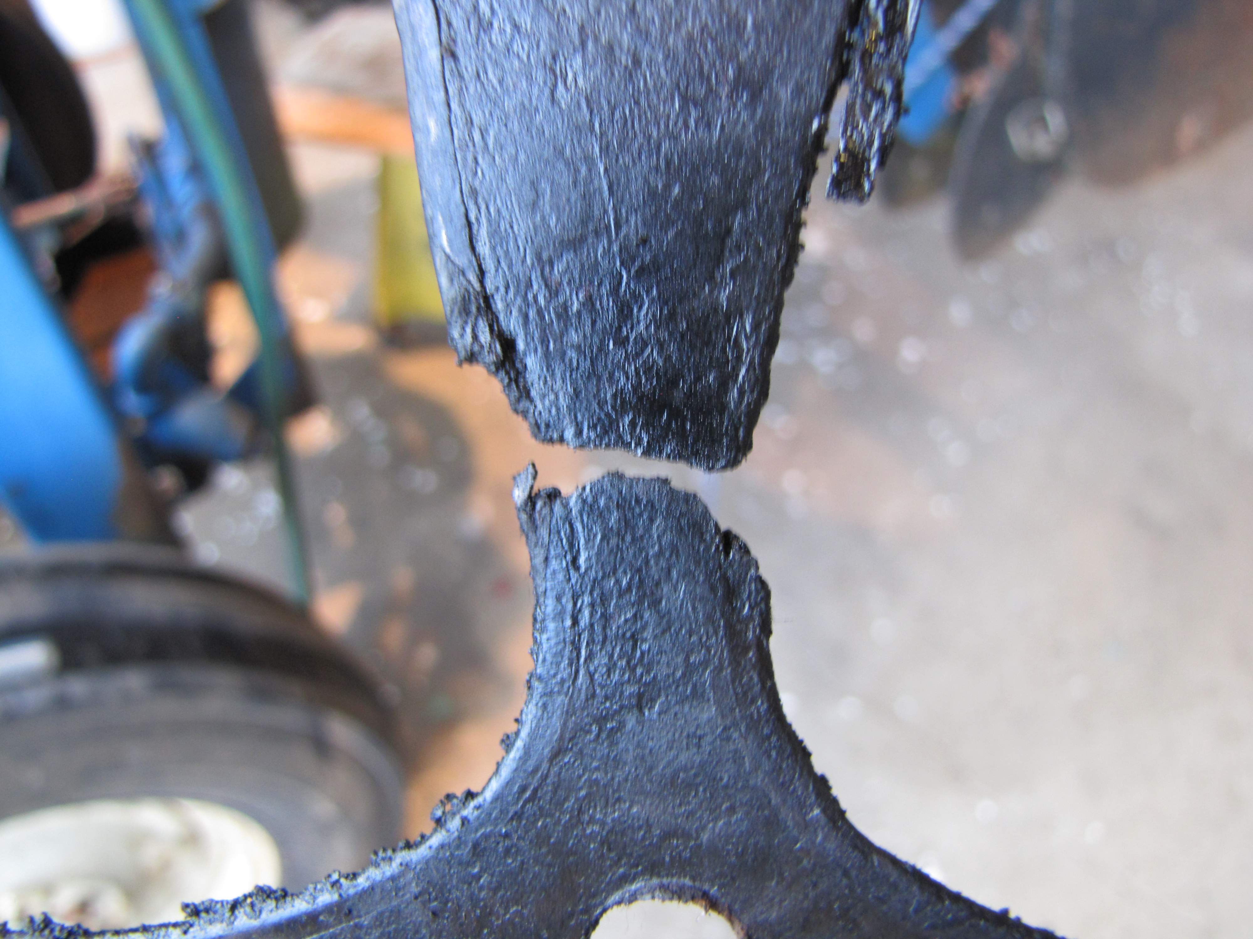

The latest...The head was slightly warped so I took it to the local machine shop. It is flat now but in the process he found a crack in the head. It is about 1/2 inch long and starts at the number 2 cyl exhaust valve. :thumbdown: That is just the one he can see. He is going to magnaflux it to see if there are other cracks to contend with and if the visible one extends down into the combustion chamber. Best case I'm looking at having the one crack repaired, worst case it is now a boat anchor.
I've got calls into the local tractor junk yard, and the guys at NAPA are poking around to find one.
If anyone has a good head with 7/16 bolt holes they want to sell me in the greater Salem Oregon area, (or at least in the PNW) shoot me a PM.

a good used one will be your friend.. new ones with bolt hole spacers will be spendy!
