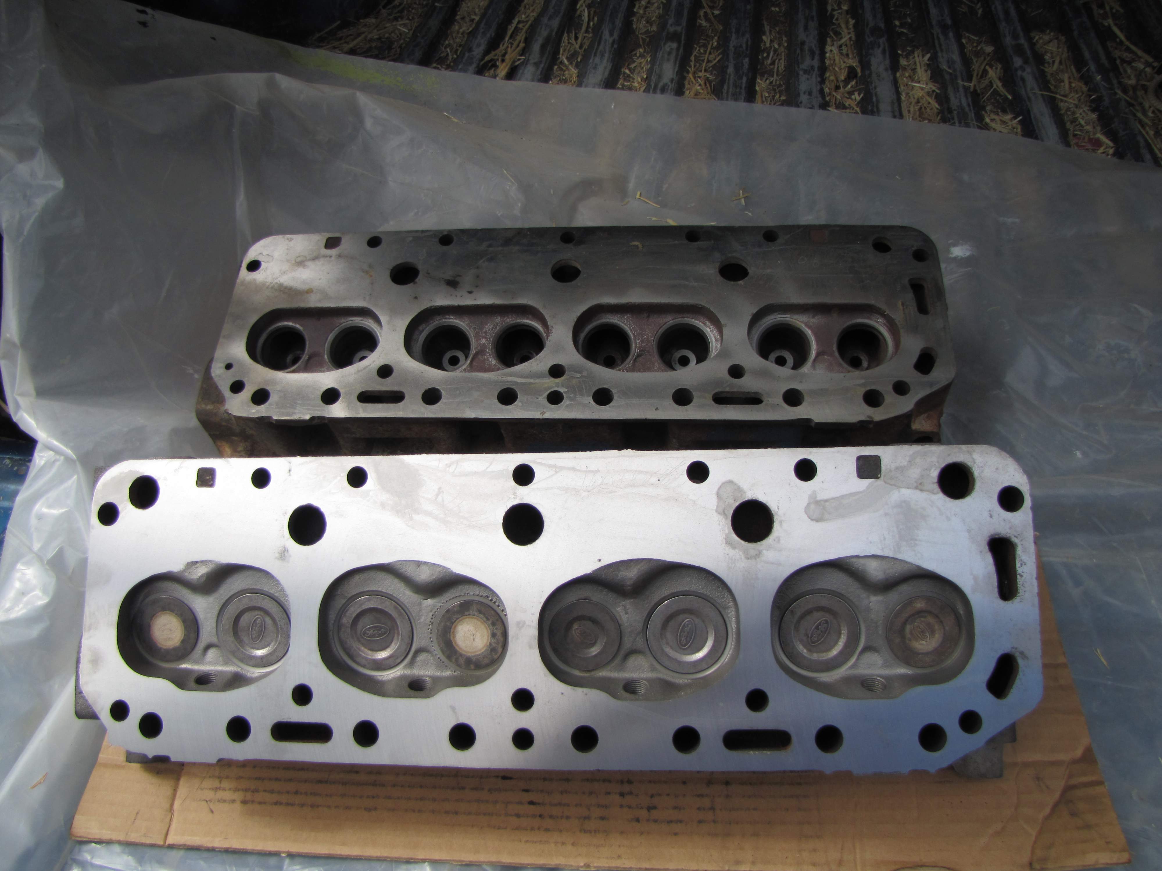

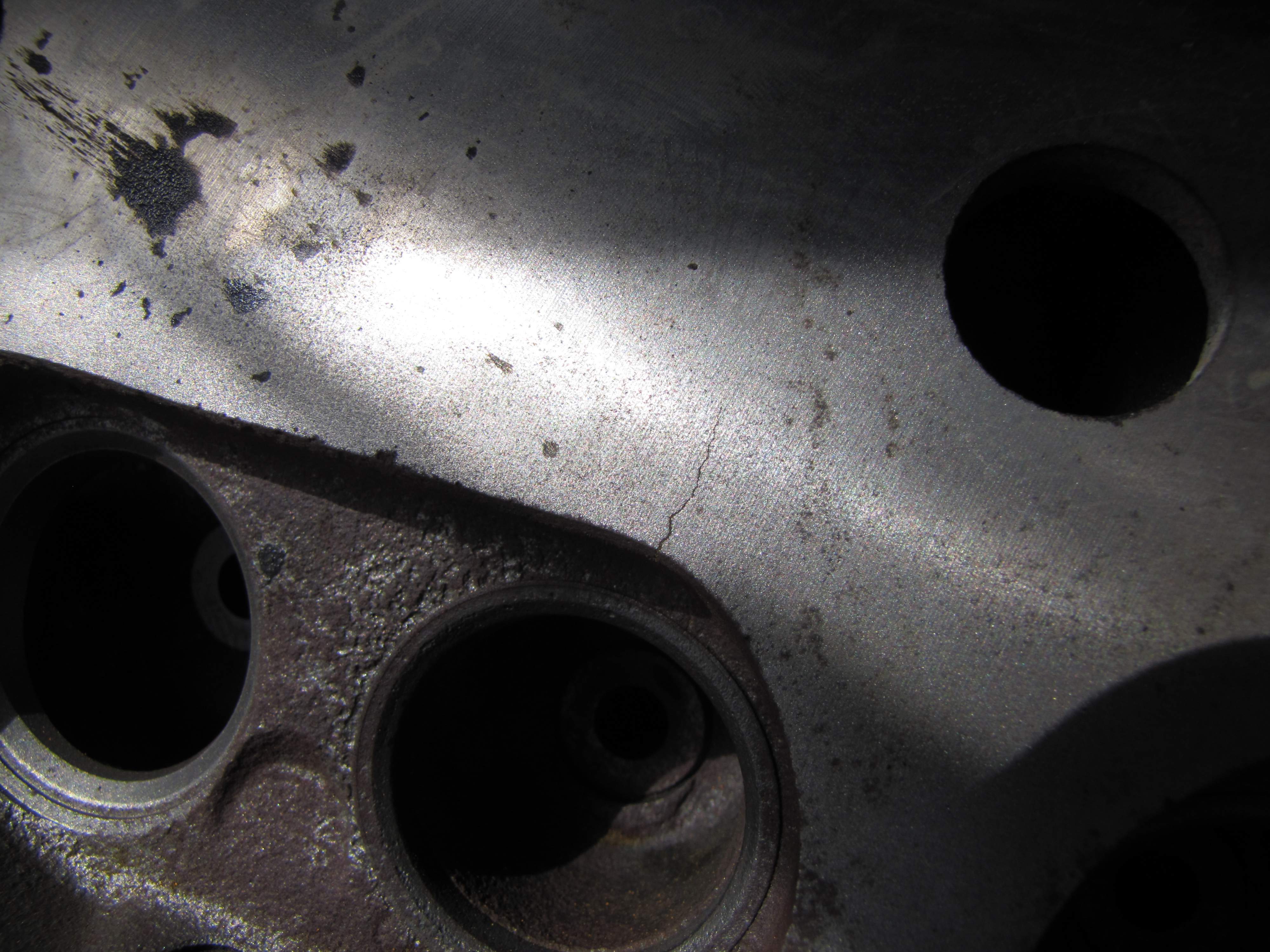

thus far here is what I have come up with:
Option 1. Bare head $385,needs a valve job, but has been magnafluxed for cracks, would require a 16 hour round trip to pick it up, or unknown shipping charge.
Option 2. Bare head $450, needs a valve job, status of cracks unconfirmed at this point but only an hour away.
Option 3. The machine shop I am using completed the magnafluxing of the head and confirmed only the 1 crack. While it does go into the seat of the exhaust valve on cyl #2 he thinks it is fixable. He also confirmed the valves are in need of guides, So for $411 he can weld the head and do the valve job.
I'd use him to do the valve job on any other head I purchased, So the question is do I go with the welded fixed head and keep the cost to a bit over $400, or to I pop for an uncracked head and end up with a final product in the $620 range? If I could get someone to sell me an uncracked head for under $300, I'd go with that but I'm not holding my breath.
I also need to confirm that the 2 head options I have found thus far are 7/16 head bolts.
   / A new NAA project now someday a new loader #24
sounds like fixing yours is the most economical.

Well I found a local head, for an only moderately high price. The oddest part of this is that when I called the local place they quoted me a price. When I dropped by and asked again they quoted me a price that was $100 bucks less, so I bought it. Customer service is certainly a bit odd at times. Any way I had my local machine shop do a valve job with my valves from my original head. Here are photos of the new and original head, along with one showing the crack. IMG_1987.jpgIMG_1986.jpg.
   / A new NAA project now someday a new loader #26
sounds like you are on your way!

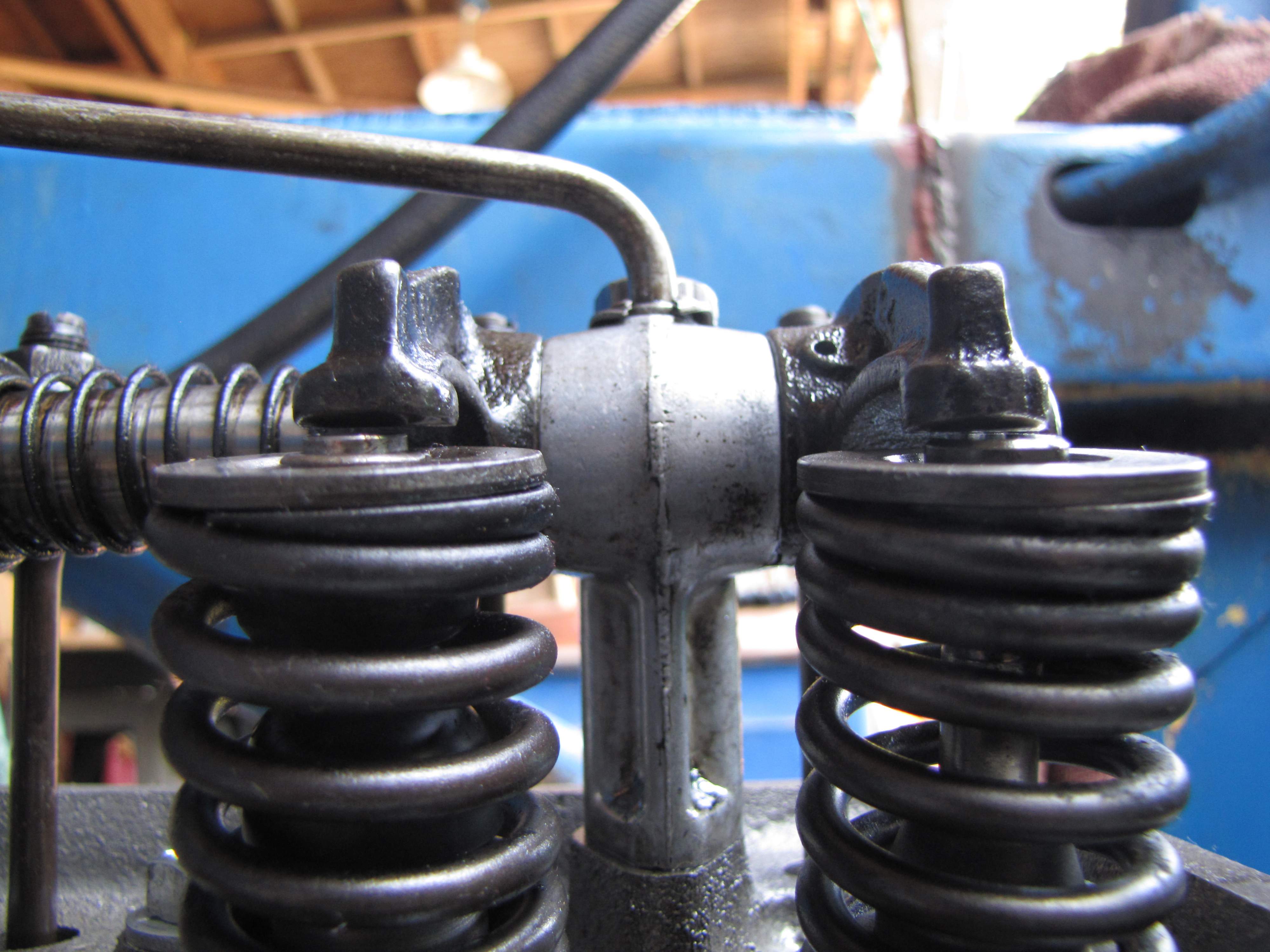

#27

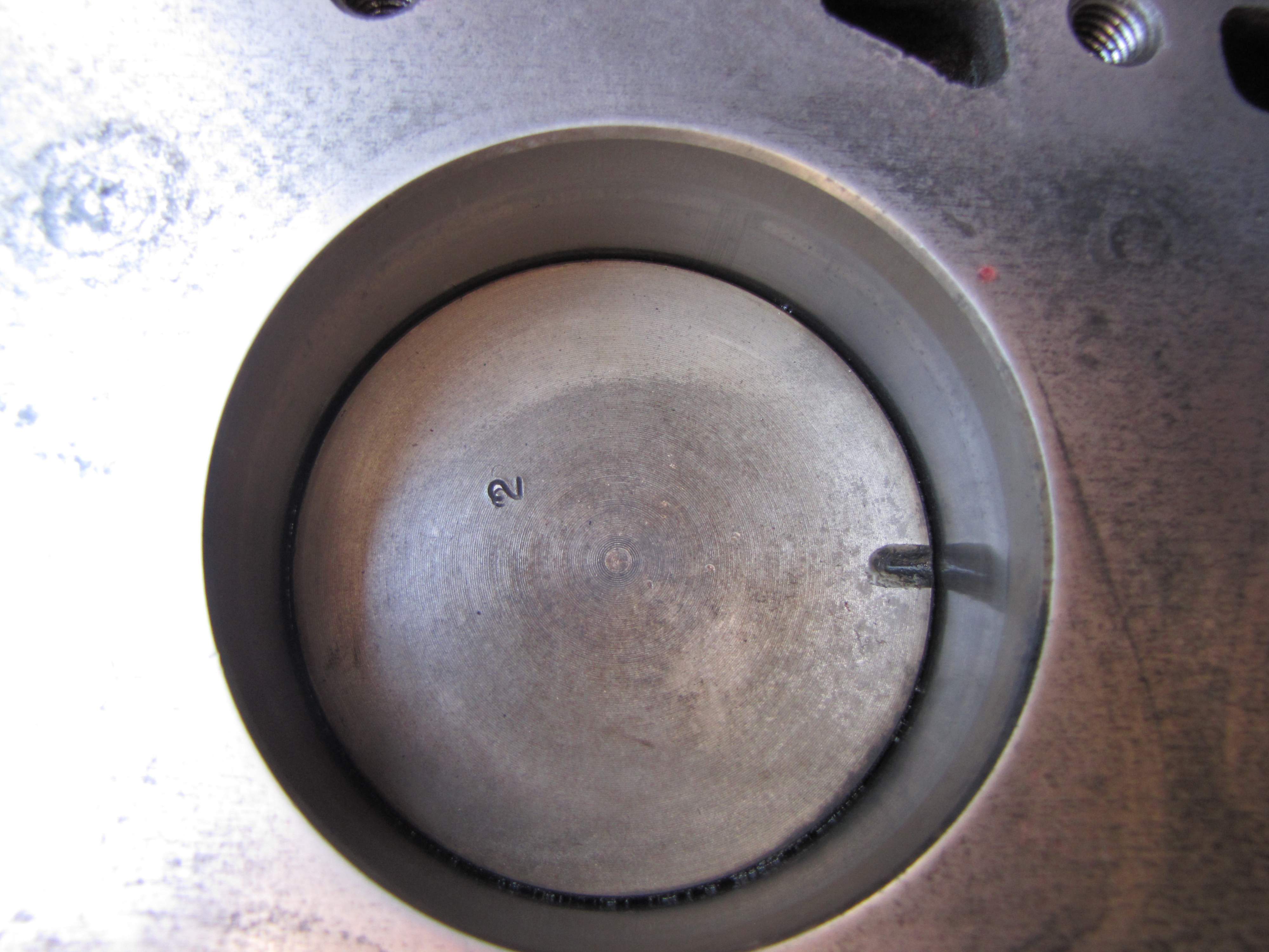

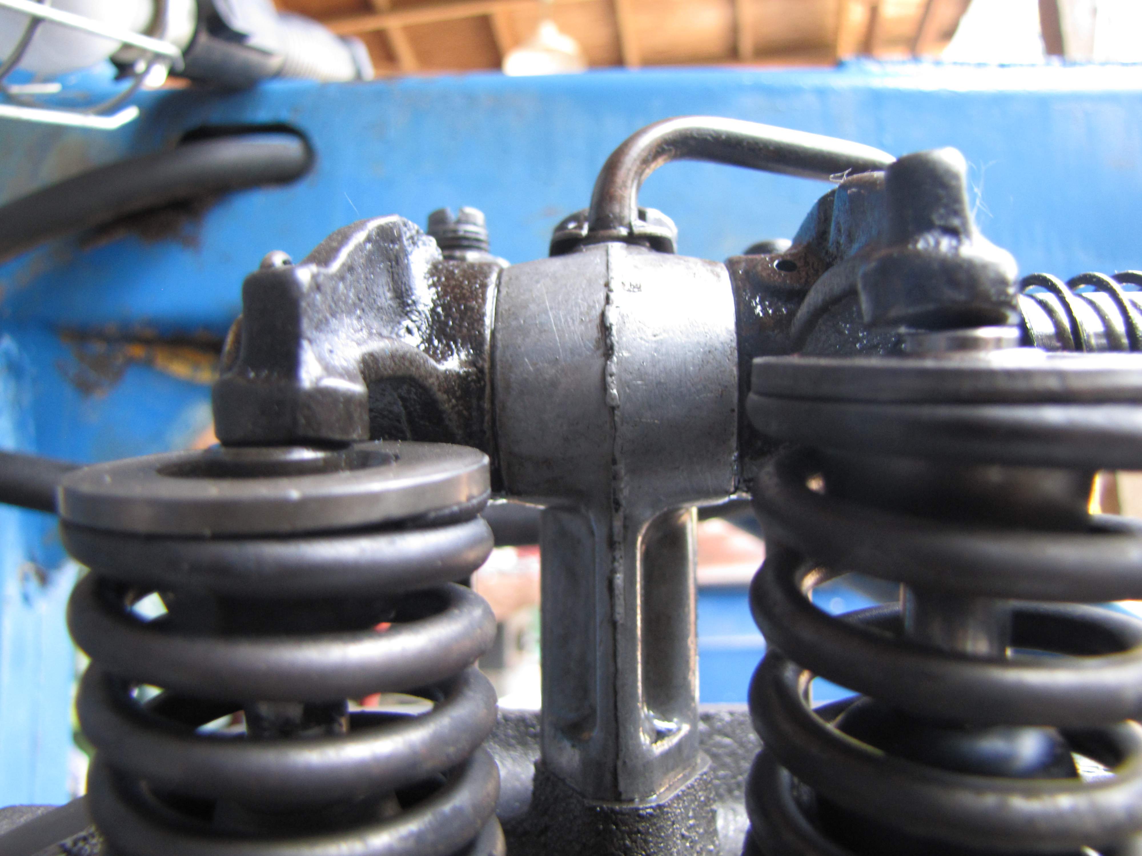

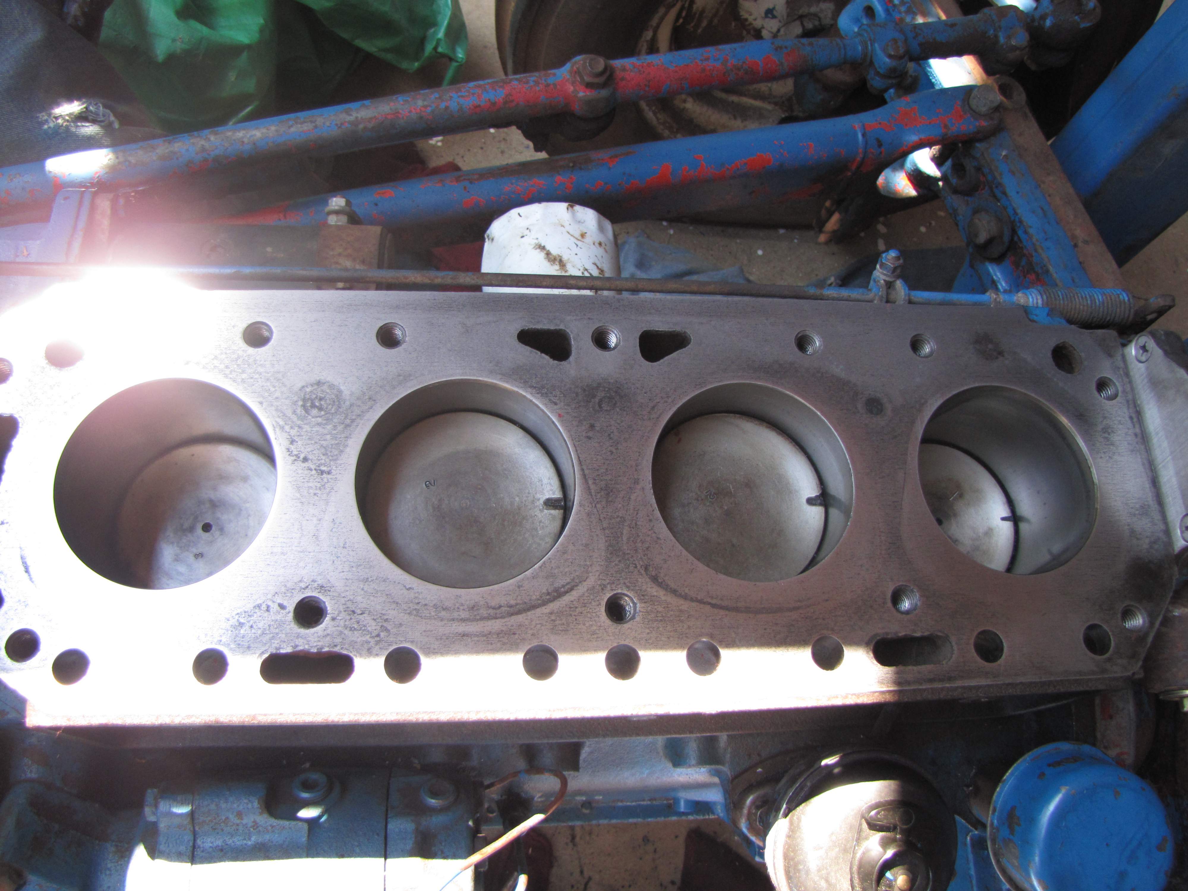

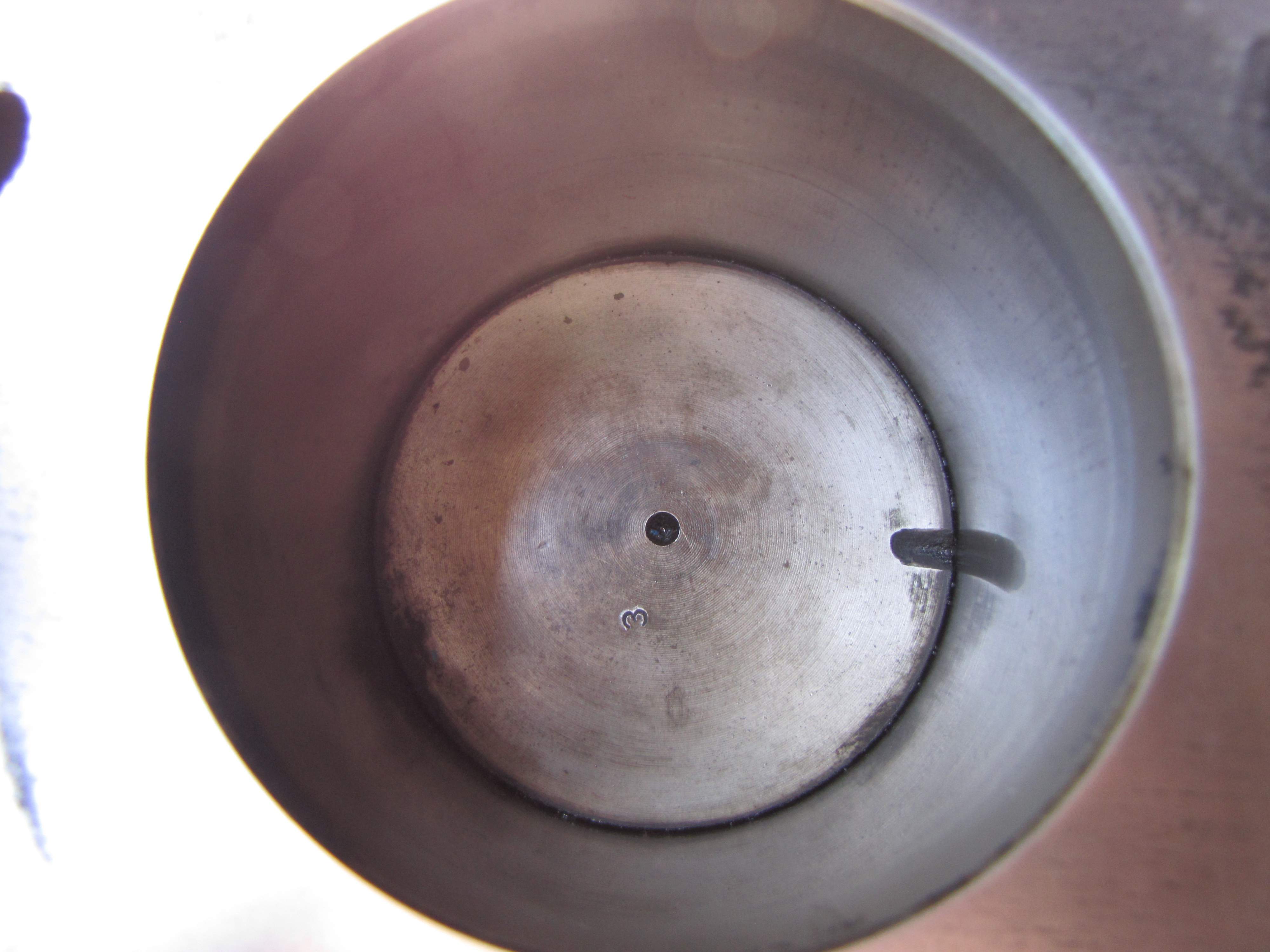

Well things are moving slowly as other projects take precedence. I have the new head bolted on, valves are adjusted. Got to get the manifold on and procure a radiator before a test run. Here are some pictures. I'm a little concerned that the rocker arms aren't very flat compared to the newly resurfaced valvesIMG_2003.jpgIMG_2005.jpgIMG_2007.jpgIMG_1998.jpgIMG_2000.jpgIMG_2001.jpg
   / A new NAA project now someday a new loader #28
Looking good, feels good going back together with it as with any project
   / A new NAA project now someday a new loader #29
rockers look fine to me....
