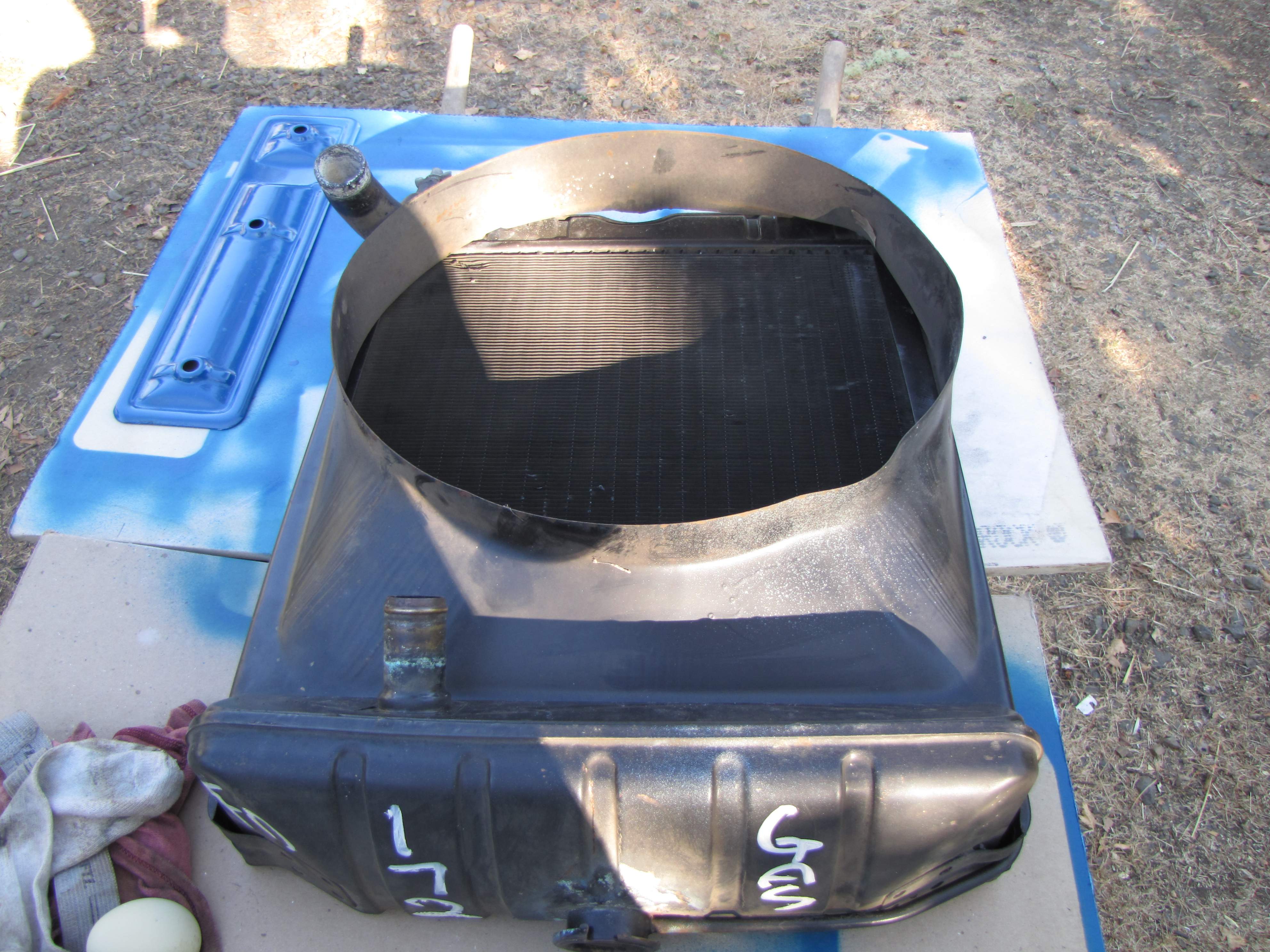

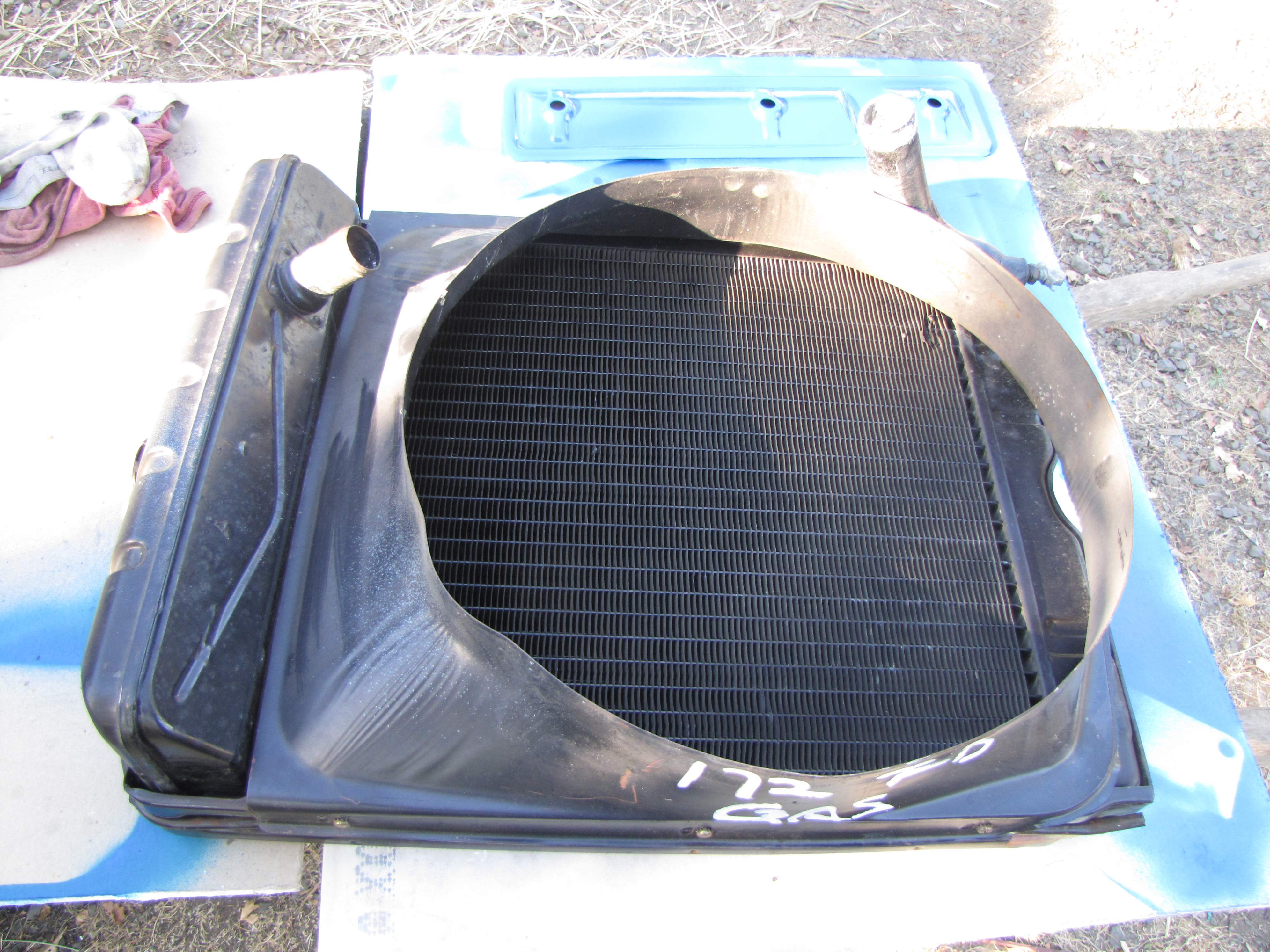

Here is the latest. I found a radiator. It is totally original (not aftermarket) and the story goes it came from a stationary power unit that had less than 10 hours on it. It is almost a museum piece:). It came with a shroud too. I had the local radiator guy check it out and it checks good. ( May have to have that guy fix something soon though). So that's the good news.

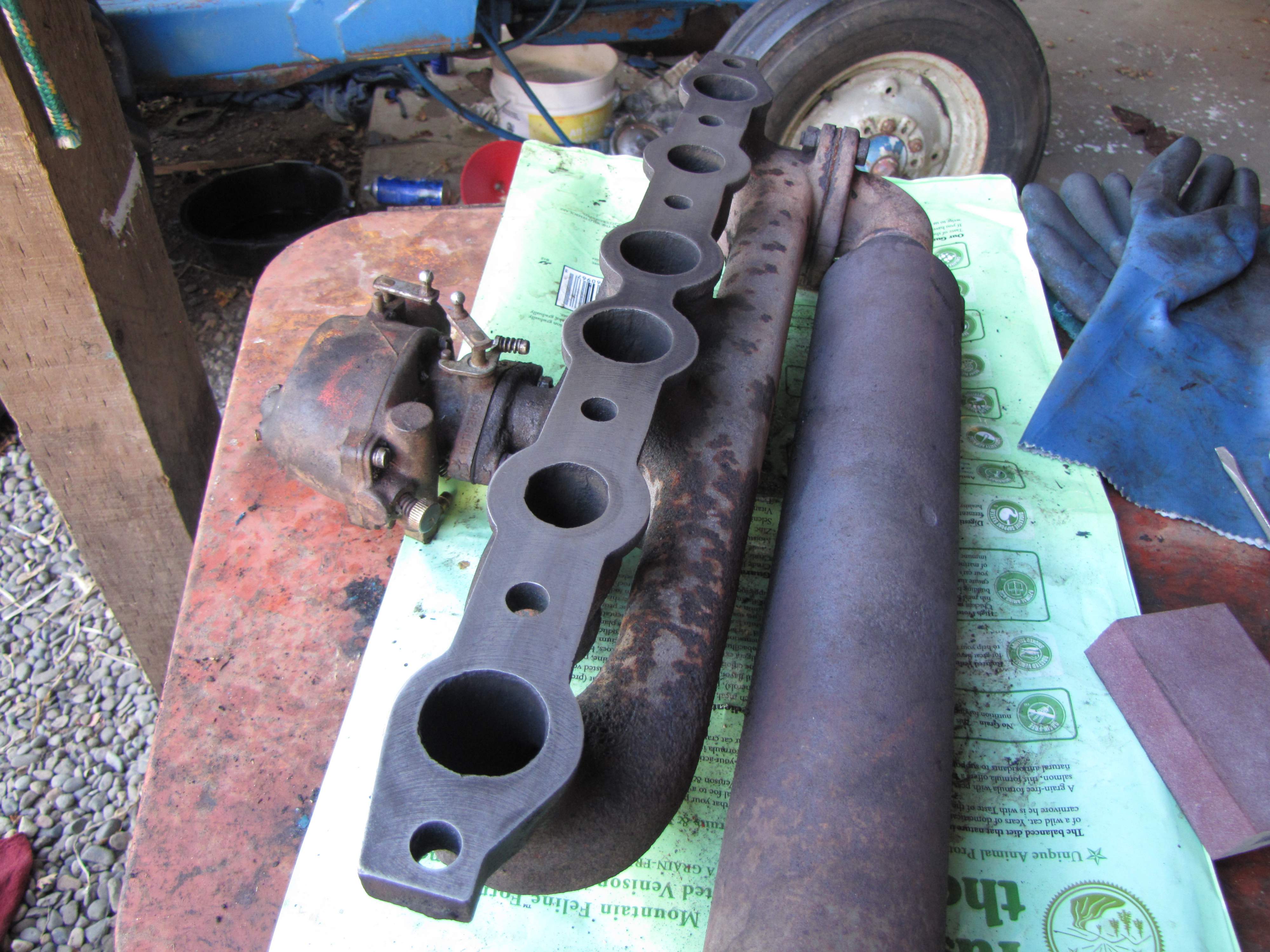

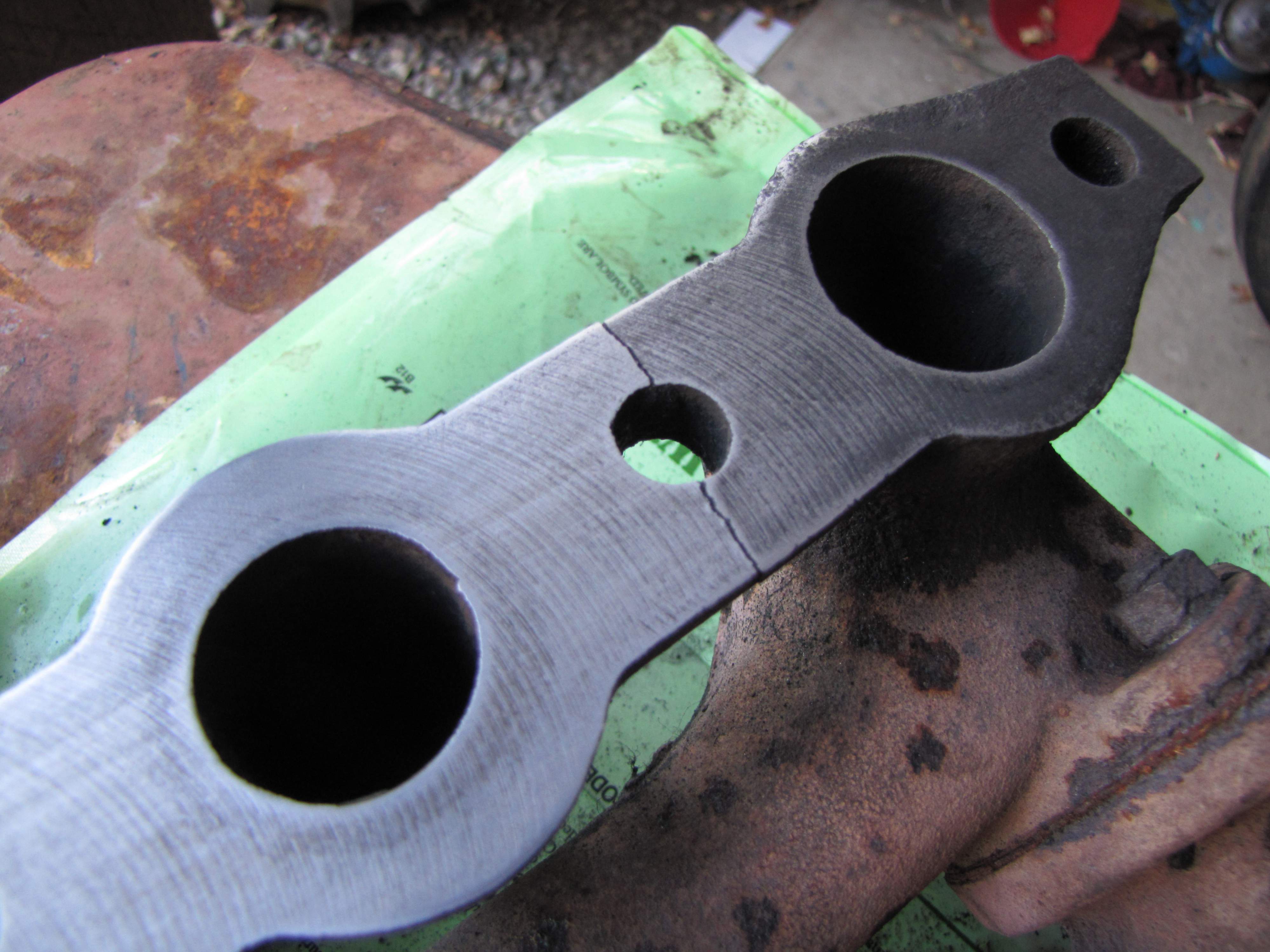

On less happy front my manifold is cracked. The crack runs right through the second bolt hole from the rear. I'm feeling like i might just try to use it anyway. Perhaps put an extra large washer on it and bolt it down. Alternatively I could try to find someone to weld it (my welding skills aren't up to that just yet). Or begin to chase parts again:(

i'd run the manifold as is with a large hard washer or piece of 3/16 plate cut into a washer / tie plate
