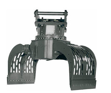

PAGuy - That is the raging debate. The problem with an ex and the bucket is that it drops the rock when you start to uncurl. So you get no control. We may end up having to hoist blocks into place with straps and the bucket.
Obed - the quarry pretty much just breaks them out. They are pretty consistent within a layer of the rock, but they do nothing to them to make them flat. "They grew that way" essentially....

No problem for an excavator with hydraulic thumb. You will need to size it accordingly based on lift height, needed reach and lifting weight.
Your other option is an extending boom hi lift rough terrain forklift (telehandler)

I'm not as sure about the excavator with thumb as I used to be. It is not as good of a tool for this as you might think base don my experience. The proper tool is a large Excavator with a rotating clamshell like below but they are rare and very spendy.

In regards to the excavator and thumb, a good operator wouldn't have any problems. Now he would set the rock and the bucket would be on the backside, so there would need to be enough room between the rock and the dirt. It's possible he could rotate the rock out away from the machine - but he would lose come control.
The telehandler - yeah the lower row might be tougher. Your could move some dirt for it to ride up on. Also, different brands are constructed differently - with a higher mast connection location. You might find one that would work better than another.

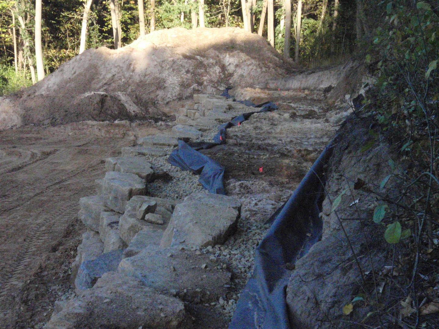

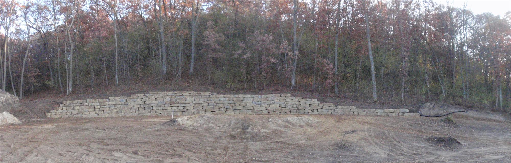

I realized I haven't posted the final results of the wall. Here are a couple pics of the final result. This was wrapped up in Mid Oct. The guy who sold me the rocks did the placement of the upper deck with his excavator (Deere 312L, I think?). It is amazing to watch someone who is an artist with an excavator work. He did things I really didn't think were possible. I was making backup plans for when his idea of placing the blocks with his ex didn't work. He did the last part of the wall (the upper deck) in a day and a half with help from me and another guy. Wow. I did the other 2/3-3/4 of the wall basically myself with the tractor and a rented skidsteer in a week or so.
Here's the stats:
Blocks: 200 tons
Backfill crushed rock: 180 tons
Length: 170'
Max height : ~10'
Here is the front view. Most blocks are about 36-48" wide, 14-18" tall, and 20-30" deep. Roughly 1500-2000 lbs each or so, I guess, though I never weighed any of them.
There are two tiers to the left side of the wall. Here is a side shot that shows the second tier. Hard to see on the frontal shot, but you can if you look.
