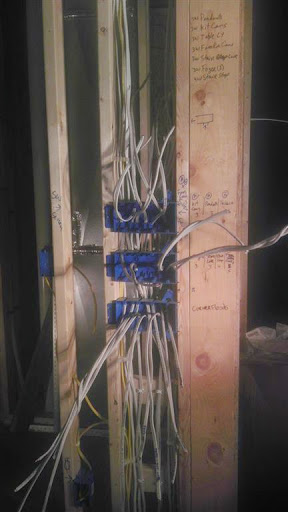

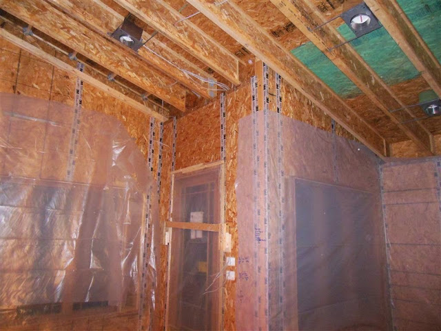

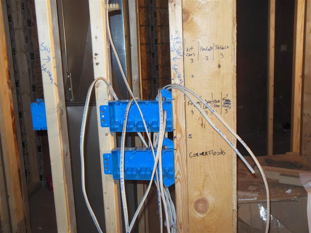

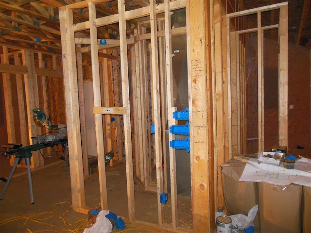

So here is a look at the electrical and the HVAC duct work. A lot of time went into all that. I did all the electric and low voltage wiring, and a guy I know from work who used to be an HVAC tech did all the duct work and furnace install. I can say for sure I underestimated how much time the duct work would take. Were I to do that myself, I would not yet be up to the point of being ready for insulation. It is good to have help.
A look at some of the early rough wiring in the house. Another thing you see here is plastic over all the doors and windows. Very early in the winter I was having huge frost issues on the woodwork of the windows and doors due to the stupid-cold temps so we had to cover them up to fix that. It did work, and has some other benefits like protecting the windows from dirt and minor damage. Plus we have to cover the walls with poly for vapor barrier at some point, so we did as much of that as we could at the same time.
Rough%u00252520wiring%u00252520-%u00252520early%u00252520%u002525281%u00252529%u00252520%u002525.JPG

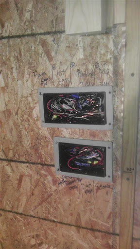

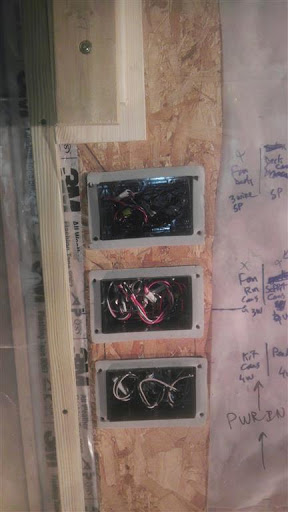

Before the big wiring push you can see the main switch box array in the hallway.
Rough%u00252520wiring%u00252520-%u00252520early%u00252520%u002525282%u00252529%u00252520%u002525.JPG

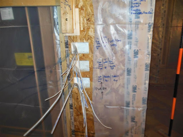

Starting to get wires pulled in place. Lots of labeling to keep it all straight...
Wiring%u00252520main%u00252520switches%u00252520in%u00252520Great%u00252520room%u00252520%u00252.JPG

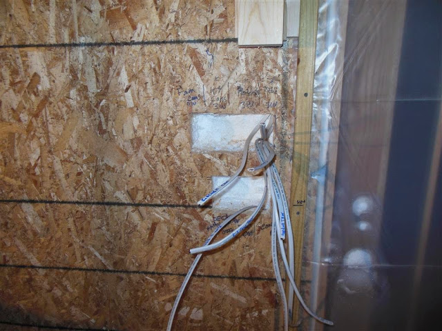

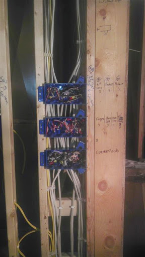

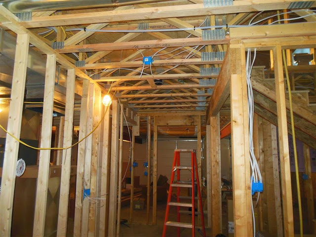

A look at the wires in the basement.
Rough%u00252520wiring%u00252520basement%u00252520%u002525281%u00252529%u00252520%u00252528Medium.JPG

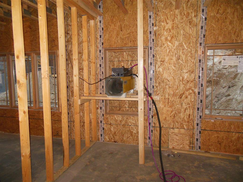

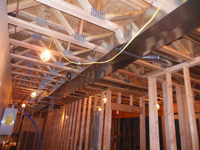

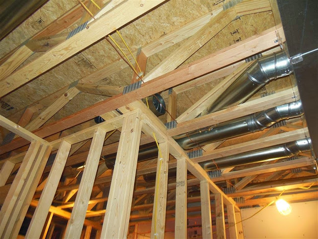

Here is some detail on the HVAC work (Heating Ventilation Air Conditioning). Primary heating is through radiant water tubing in the floors. This got complicated in several places. We also put in a full forced-air furnace mainly for the AC, but it is also nice to use as heat at times. Radiant is great for the winter, but it is slow response, as you have to heat a slab of concrete for example, before you really get heat out of it. If the days or nights are just a little cool, as typically happens in the spring and fall, you might not want to run the radiant for just one or two nights but need a little heat. A forced air furnace is great for this.
I will say upfront that I greatly underestimated the required time for ductwork. I lucked out though in that I work with a guy who used to be an HVAC tech around the cities. He has done the whole thing for me, and it has come out much better than it probably would have from a commercial outfit as we could discuss items as they came up, and at probably less than half the cost. It took him a lot of time, but I had too much else to do in the same time and there is no way I could have done this too. Plus not knowing some of the key details in how this is done would have hurt a lot. He has a couple details he is finishing up this weekend (4/12/14) and we will wrap up final inspection on that early next week. Then we move onto full drywall work. All other inspections are complete for now (rough electric, rough plumbing, insulation, framing).
Here is the temp gas manifold feeding "The Dragon"

You can see some of the main ductwork runs here, including after insulation. Lots o' ducts. They foamed under all floors as it fills in easy and helps keep the radiant heat going where it should.
Start%u00252520duct%u00252520work%u00252520%u002525281%u00252529%u00252520%u00252528Medium%u0025.JPG
Start%u00252520duct%u00252520work%u00252520%u002525282%u00252529%u00252520%u00252528Medium%u0025.JPG

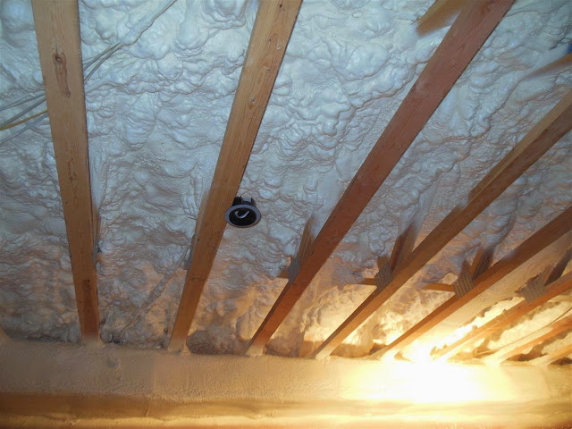

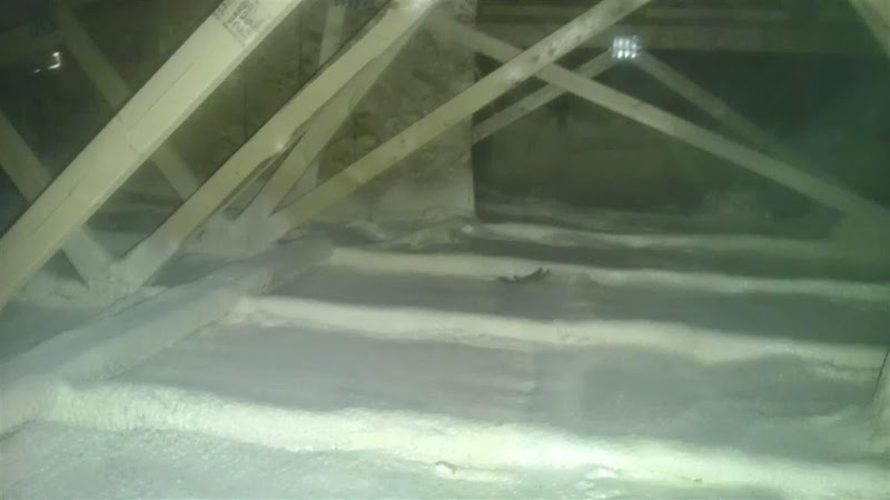

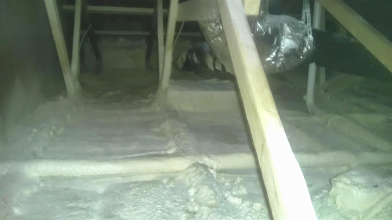

We did a lot of foam insulation to seal things up well. Here is a shot of the foam in the attics where they sprayed 2" of closed cell foam on the ceilings to seal everything up nicely. They did a very nice job of this. I was very impressed with the insulators overall- very good and professional. This was a very tight space to work in so it was all the more impressive what they did.
Foam%u00252520seal%u00252520ceilings%u00252520%u002525281%u00252529%u00252520%u00252528Medium%u0.jpg
Foam%u00252520seal%u00252520ceilings%u00252520%u002525283%u00252529%u00252520%u00252528Medium%u0.jpg

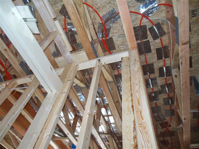

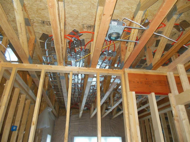

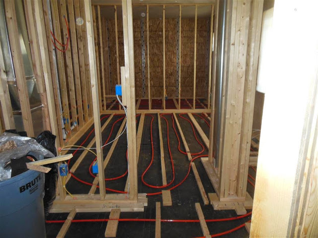

Let's talk radiant... The primary heat will be radiant heat. In the basement we buried the tubing in the slab. The main floor will be covered in detail below. The upper floor was done with a technique called staple-up. You basically staple the tubing to the bottom of the floor from below. You use thin aluminum plates to help distribute the heat and hold the tubing up. This is a hard way to do radiant but works OK for small areas, like the upper floor in this plan. This was a full weekend of work for two of us.
PEX%u00252520staple-up%u00252520bathroom%u00252520and%u00252520BR%u00252520%u002525282%u00252529.JPG
PEX%u00252520staple-up%u00252520library%u00252520%u002525281%u00252529%u00252520%u00252528Medium.JPG
PEX%u00252520staple-up%u00252520library%u00252520%u002525282%u00252529%u00252520%u00252528Medium.JPG
PEX%u00252520staple-up%u00252520library%u00252520%u002525283%u00252529%u00252520%u00252528Medium.JPG

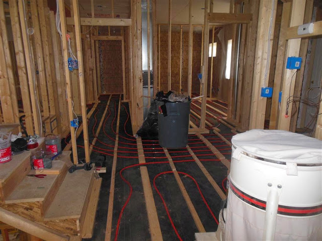

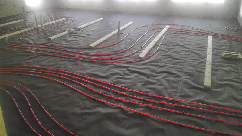

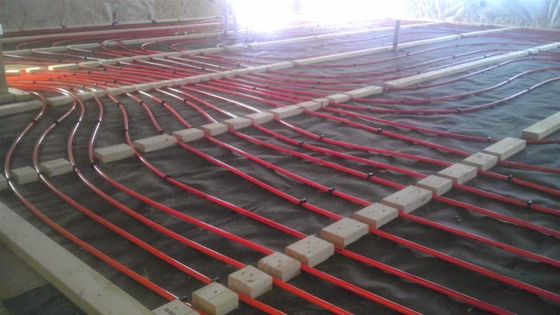

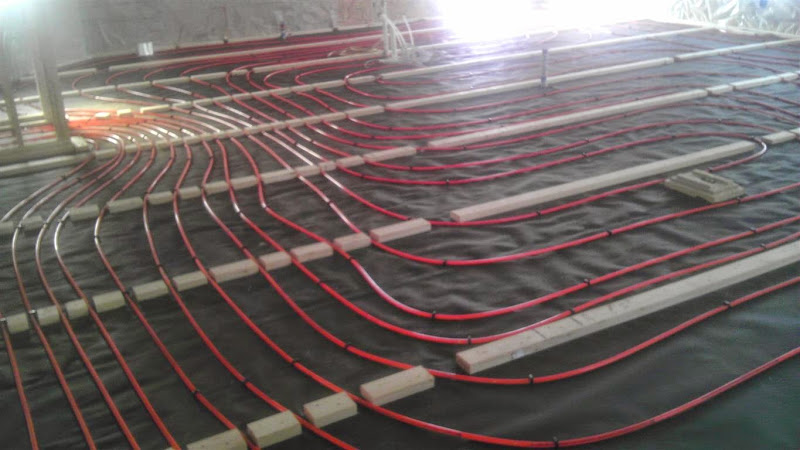

Now for the main floor. This one is a bit different as we are doing it on top of the main floor deck. The techniques is to put the tubing down between 2x4 sleepers and the fill the space with concrete. then you put a subfloor of plywood/etc on top of that to ready the place for the finished floor. The house design was adjusted for this extra height. We had to wait on this as a lot of other things had to be in place first, but we have now knocked out the main level in just a couple weekends. Layout and the head scratching took some time, but once we figured out how we wanted to do it, it came together pretty quickly.
Main%u00252520floor%u00252520tubing%u00252520%u002525281%u00252529%u00252520%u00252528Medium%u00.JPG
Main%u00252520floor%u00252520tubing%u00252520%u002525282%u00252529%u00252520%u00252528Medium%u00.JPG
Main%u00252520floor%u00252520tubing%u00252520%u002525283%u00252529%u00252520%u00252528Medium%u00.JPG

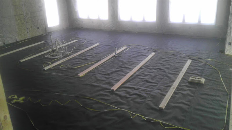

Here is the progression of the great room. 1st step - layout and figuring it all out. Nothing nailed down yet.
Tubing%u00252520Great%u00252520Room%u00252520%u002525281%u00252529%u00252520%u00252528Medium%u00.jpg
Starting to layout tubing.
Tubing%u00252520Great%u00252520Room%u00252520%u002525282%u00252529%u00252520%u00252528Medium%u00.jpg
A couple pictures of the completed great room. I still need to do the intermediate sleepers in between the main ones shown, but that will happen this weekend. Then we will be ready to pour concrete there some time soon - in the next couple days.
Tubing%u00252520Great%u00252520Room%u00252520%u002525283%u00252529%u00252520%u00252528Medium%u00.jpg
Tubing%u00252520Great%u00252520Room%u00252520%u002525284%u00252529%u00252520%u00252528Medium%u00.jpg

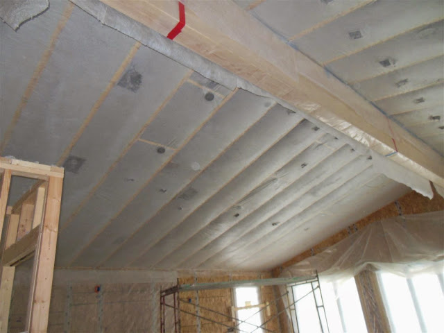

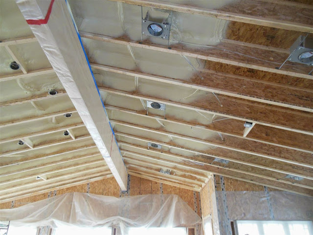

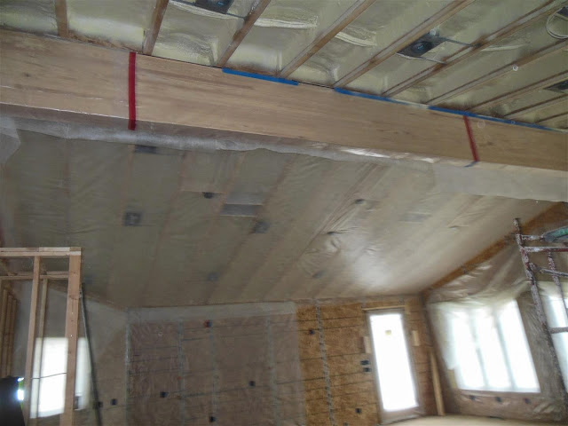

Here are some shots of the great room insulation in process. The first shot you can see the one side of the Big Beam is done with foam, and the other side was started. This was the end of day 1 which included a lot of prep and setup time.
great%u00252520room%u00252520ceiling%u00252520insulation%u00252520%u002525283%u00252529%u0025252.JPG
Here both sides are done foaming and they have put up netting on the first side that was already done with foam. This netting is air permeable so when they blow the cellulose in, the air that is used to blow it can come out through the netting to allow the cellulose to settle fully in.
great%u00252520room%u00252520ceiling%u00252520insulation%u00252520%u002525284%u00252529%u0025252.JPG
Here you can see the netting is all complete, and they have finished blowing in cellulose. The holes near the ridge beams are where they stuck the hose in to fill it up. If there was an obstruction, they poked in another hole to finish it off. I placed speaker boxes in the ceilings for future speakers for a general sound system or possibly for surround sound in the TV area. I just made these boxes out of some sheet foam.
great%u00252520room%u00252520ceiling%u00252520insulation%u00252520%u002525288%u00252529%u0025252.JPG
great%u00252520room%u00252520ceiling%u00252520insulation%u00252520%u002525289%u00252529%u0025252.JPG

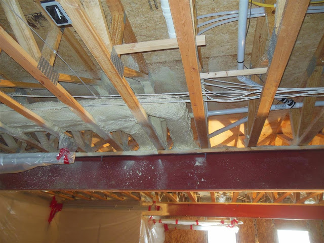

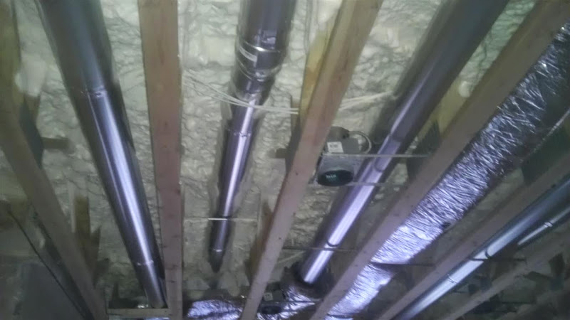

They also foamed in under all floors to help the radiant heat go the direction it is supposed to (up). One thing that also had to happen was the duct work that was in the garage space needed to be foamed in with closed cell first to seal it in. This is the first picture. Note the ducts covered in foam above the red steel beam.
foaming%u00252520ductwork%u00252520in%u00252520garage%u00252520%u002525282%u00252529%u00252520%u.JPG

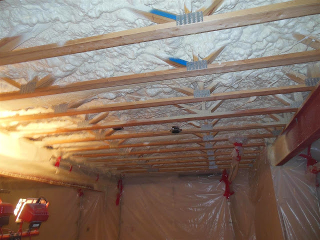

Then since the tuck under garage is considered unconditioned space, they foamed in 10" of the open cell foam for an R50 floor in the great room (directly over the garage). The open cell is really wild to watch them place it as it expands an incredible amount - a lot more than the closed cell. In the first pic you can see the main trunk duct below the trusses at the very bottom of the pic that was already sealed with closed cell. That was later enclosed in a soffit.
Ceiling%u00252520foam%u00252520lower%u00252520level%u00252520%u002525285%u00252529%u00252520%u00.JPG
Ceiling%u00252520foam%u00252520lower%u00252520level%u00252520%u002525286%u00252529%u00252520%u00.JPG
There was a whole lotta foam going on for a few days...

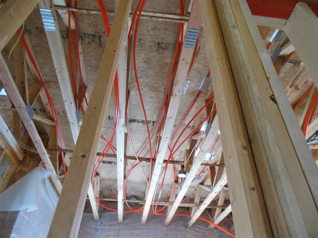

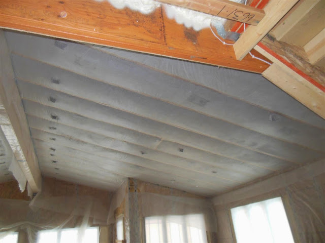

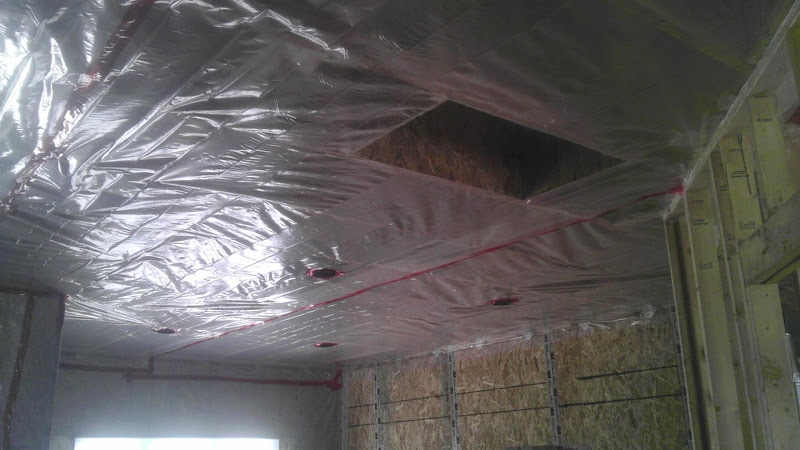

As for the Truss ceilings, the original plan was to just blow in cellulose. After talking with the insulation guys, and thinking it over, it made a lot of sense to first put down a seal coat of closed cell foam first on top of the ceiling drywall so everything would be totally air tight. No sense making the rest of the house perfect and leaving this without a good seal. So they did that first. But there was a wrinkle. I had been putting up plastic vapor barrier on the upper floor while they were working elsewhere in the house. Once I got that done was when we discussed foaming it first. And the guy told me the plastic was not very compatible with the foam so it was better to leave it out. So after nicely covering the entire ceiling, I tore it all out. I love tearing work out - NOT! But it will be better in the long run and only wasted $50 of poly, so such is life... Here it was before I tore it down. Figured it was worth a pic at least...
2nd%u00252520Floor%u00252520vapor%u00252520Barrier%u00252520%u00252528Large%u00252529.jpg
More radiant tubing next
Interesting. Any reason you sprayed the "attic floor" rather than the underside of the roof? We are looking at foaming the attic in the future but I had only looked at foaming the underside of the roof deck (vs foaming the "floor" of the attic).
