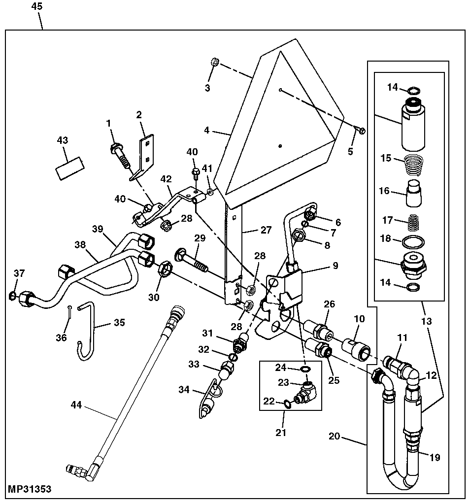

As long as you get the valve to match your pump flow or greater is good.
They make tractors with gangs of valves at the back, and they are used all the times.
As far as restrictions, any fitting or hose after the pump will cause some heat.

The difference here is that the valve will be required to flow oil continuously to power the backhoe. No matter what the valve is rated at, there will be added heat when oil flows through the valve at a steady rate, and the oil still must flow through the valve on the hoe also, plus do work. This new valve will also require more real-estate that a loop hose also. If this was a better choice, then how come no OEM offers it?

The OP has a Kubota B7500 with an after market backhoe.
When the hoe is mounted and in operation the hydraulic supply comes from a power beyond port. The return should go to the hydro case.
When the backhoe is removed no hydraulic flow is required. If the OP puts a quick disconect at the power beyond port and another at the hydro case the long hydraulic lines can be disconnected there and stored with the backhoe.:)

On my JD 4200 with factory frame mount for the backhoe the three point is used to lift the backhoe into position and then disabled by closing a valve. Then the backhoe hydraulic lines are connected to the quick disconnects mounted at the rear of the tractor. There is no hose to complete a loop when the backhoe is removed.:)

What?
Pictures below from JDparts clearly show the loop hose in both the original and revised PB kits.
Part #13 for the older kit, and part #19 for the newer kit.
