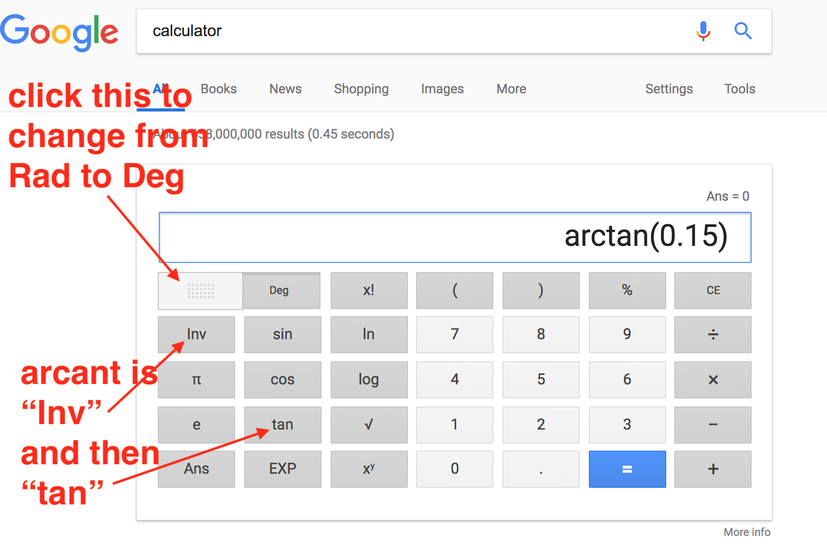

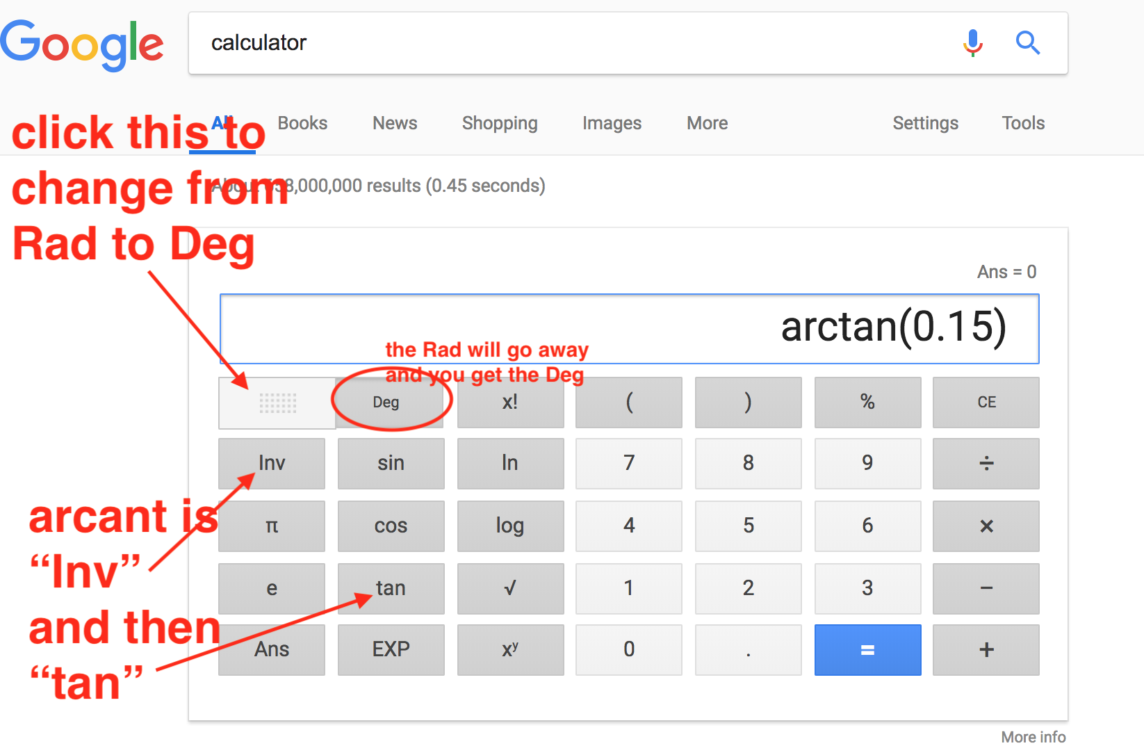

what is the difference between slope and grade?
A slope is an incline, with no typical measurement. "That's a steep slope."
A grade is also an incline, and also a measurement. "That grade is 6%, gear down."
Grade is measured in percentages, and is equal to (Rise) divided by (Run).
So, if your hill goes up 15 feet in elevation for each one hundred feet of distance (distance measured horizontal : LEVEL), you have a (15/100) = 0.15 = 15%
If you have a consistent hill, you can most easily measure the grade by choosing a point, pulling a tape down the hill as far as you can go down and hold the tape level (a bit of help here holding the level please); note the length of the tape (that's the RUN), and the height you were holding it at off the ground (that's the RISE). Divide rise by run. Few hills are totally consistent but this can give you an idea.
You can convert a grade to a degree measurement by taking the arc-tangent (inverse tangent) of the grade, or arcan(0.15) = about 8.5 degrees. If using a calcutor, make sure it's on degrees setting and not radians.
If you have degrees and you want to get grade, take the tangent of your degrees. Example: tan(8.5) = 0.15.
