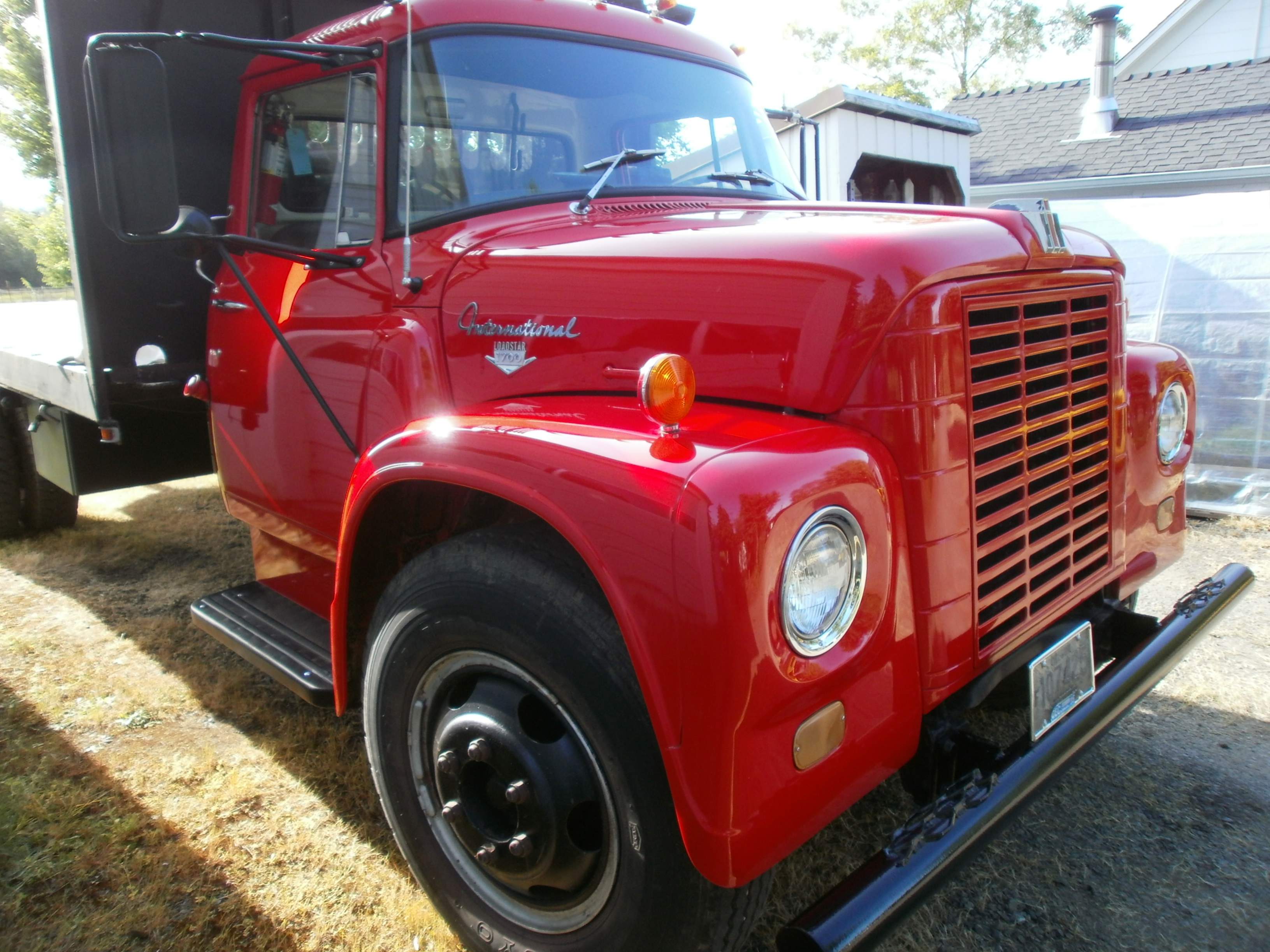

I am a biased Cornbinder man. The Loadstar is heavier built from the ground up. Parts are always obtainable in wrecking yards for either of these trucks. The Loadstar will have either a 304 or 345 in it. Not a lot of the 1600 trucks came with a 392. I would make sure they both have power steering and crawl under them, check the Emergency brake assembly and dash components and interior for wear or abuse. IHC doors can be in bad shape. The cowl right under the windshield is prone to rust and rot, INSIDE, ie the fresh air vent going in to the cab. That can be rotted badly. Dash parts and switches for the Chev will be easier to find new. The most important thing if you buy the International, take the serial number to a dealer, pay them twenty bucks or what ever they want and get the factory line setting sheet. It tells what each component is and is the key to replacement of parts and components in the drive train.
