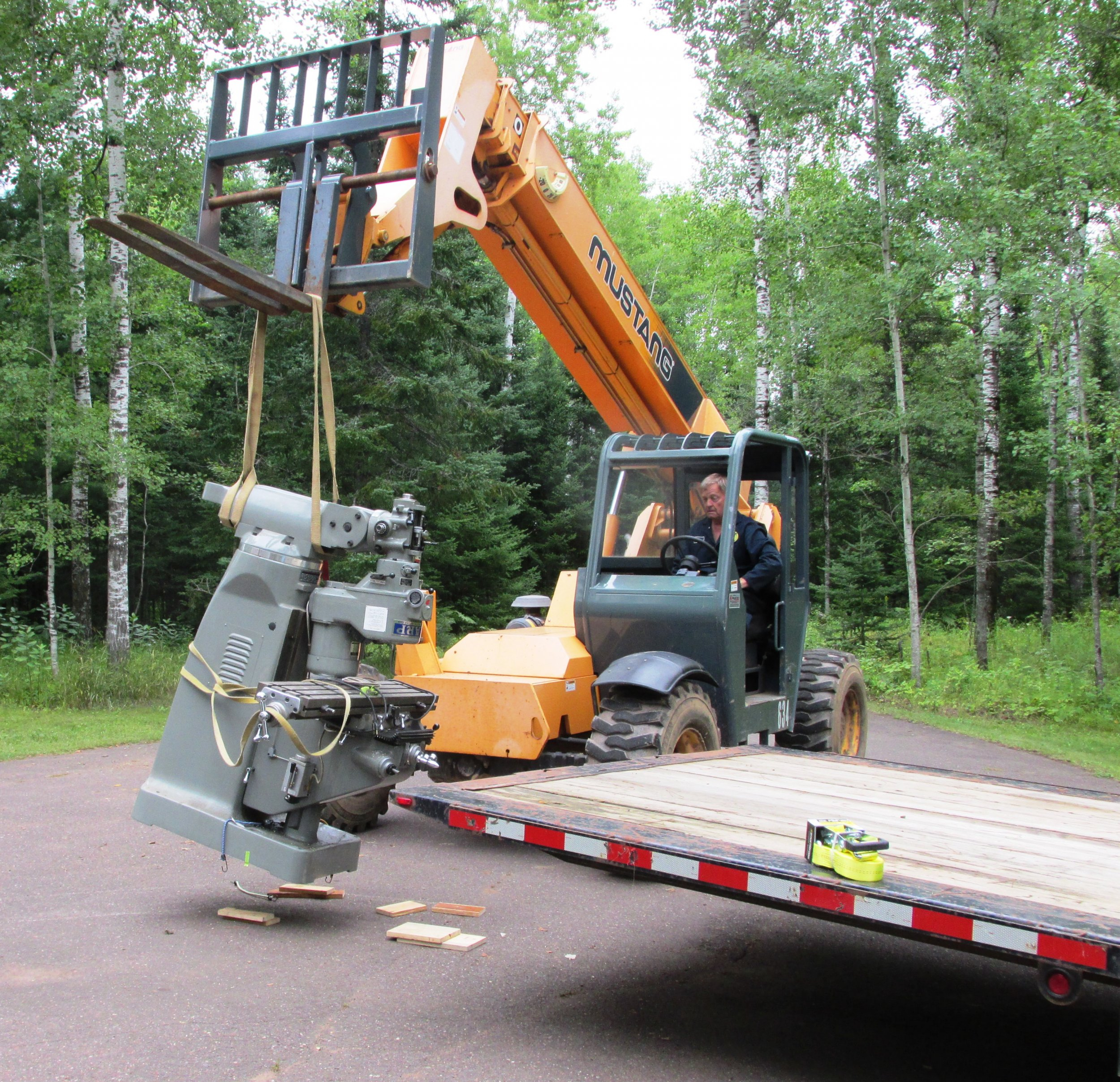

There have been a few time larger FEL lift capacity would be welcomed. Like having a piece of heavy equipment delivered and needing it removed, moving a large piece of equipment, vehicle, or extra-large rock. I’ve rented /hired out the real heavy lifts.
