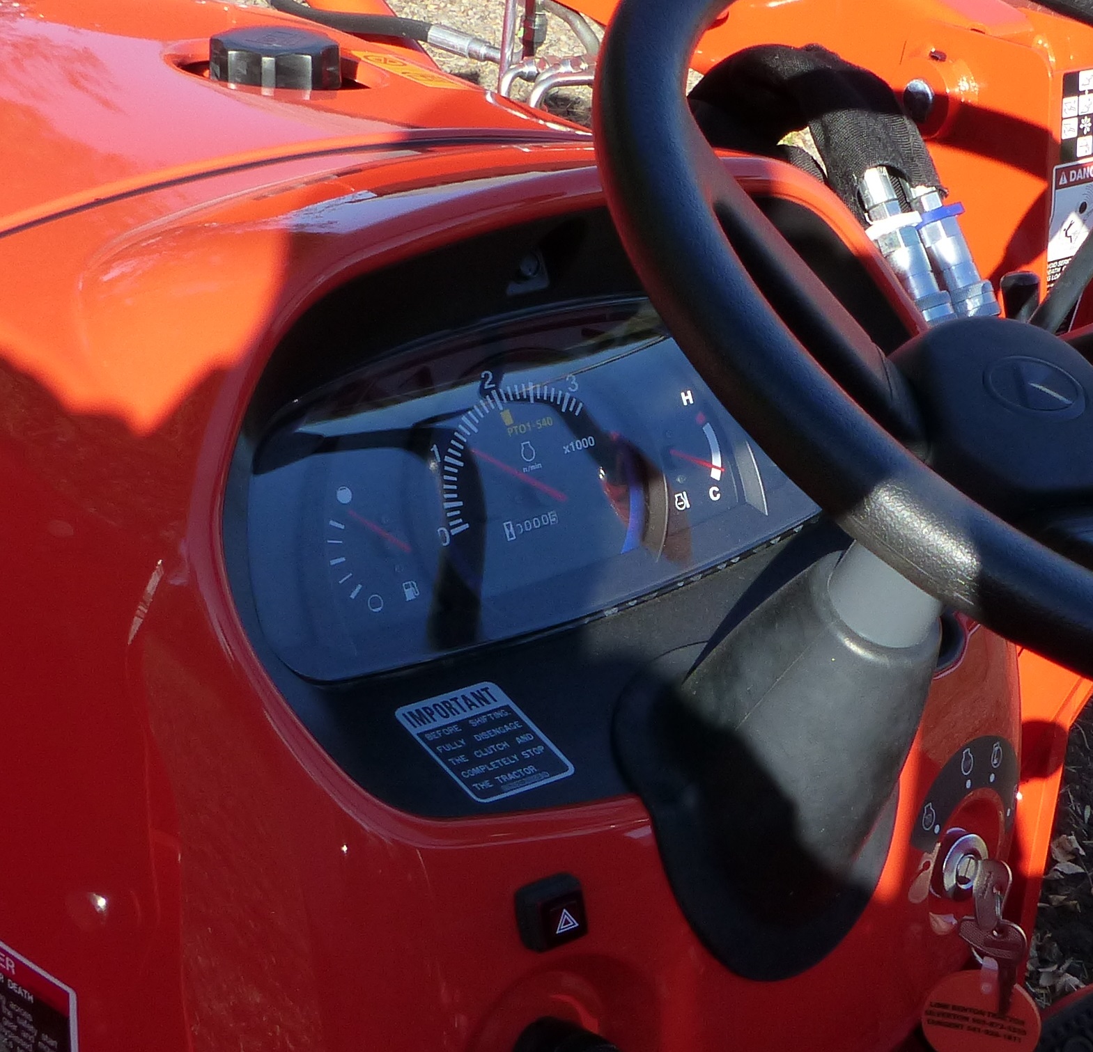

The salesman who sold me this tractor sells a lot of lines of big farm equipment -- not just Kubota compact tractors -- so not terribly surprised that he didn't know all the details. He had told me that he thought the L2501DT has a 2 stage clutch, which was still in its crate from the factory when I bought (I did the demo drive on a L3301). When the tractor was delivered and I _lutc.jpgsaw that sticker on the instrument panel, I thought "uh oh".
John Deere provides electric-independent PTO on pretty much everything nowadays, so coming from that side, Kubota makes the customer/salesman work harder because they have a unique PTO/transmission situation by tractor:
L2501 gear (nonlive, 1 stage clutch),
L3301 gear (adds synchro shuttle but still has nonlive PTO),
L3901 gear (adds live PTO), and
L4701 gear (adds a electric independent with a knob that you twist).
What other mainstream manufacturer has so much variety in one compact tractor line? Choice is good, but the setup is unique to each one, so it really raises the burden on the salesman and customer to make sure they know exactly what they're getting.

The salesman who sold me this tractor sells a lot of lines of big farm equipment -- not just Kubota compact tractors -- so not terribly surprised that he didn't know all the details. He had told me that he thought the L2501DT has a 2 stage clutch, which was still in its crate from the factory when I bought (I did the demo drive on a L3301). When the tractor was delivered and I View attachment 484059saw that sticker on the instrument panel, I thought "uh oh".
