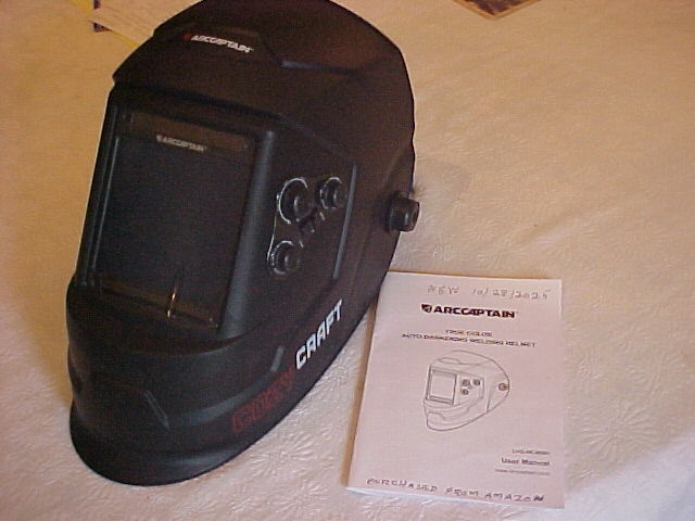

Finally some photos of my helmet.
This is the overall view:

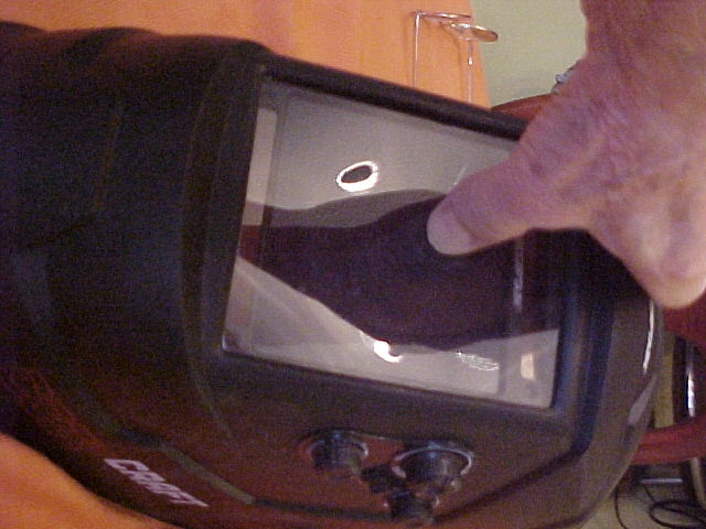

Here is a photo of the flexible, convex plastic cover in front of the solid, replaceable lens shield.
Today, I sent off an e-mail to Arccaptian and ask about these plastic piece.
Richard

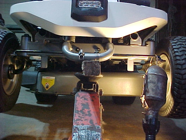

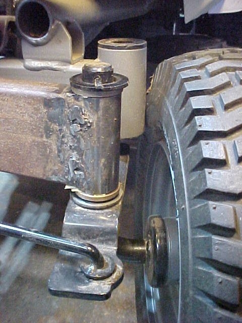

An over all view of the stock front suspension.
Close up of the stock left front wheel support

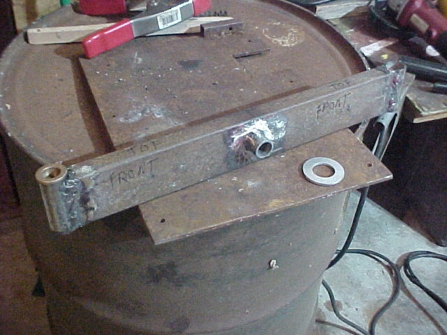

My pivoting front beam with 3/4" Id pivot tube.

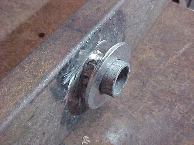

This washer will be welded on to the bean and the pivot tube to re-enforce the beam. The bean is 1X2.5"

Got some information back from Arccaptain sales:
Dear Richard,
Thank you for your patience over the weekend while awaiting our response.
We appreciate your detailed questions - here are the answers for you:
  1. The flexible plastic part is the outer protective lens, which should not be removed. It serves as an essential shield, protecting the inner auto-darkening lens and sensors from sparks, scratches, and debris to ensure clear vision and long-term durability.
  2. For storage, please set the mode switch to the "Grind" position.
  3. The helmet has an operating temperature range of -5°C to +55°C (23°F to 131°F). For storage, no specific temperature is required – simply keep it at room temperature.
We hope this information is helpful.
I had ask what is the purpose of the flexible plastic on the front of the helmet. I think he is mistaken about it, as I have some flat solid plastic parts that are replacement for the shields that are in there now.
Sales, what do they know?
The user manual did not have the operating temp range or any info on what to do for storage. So now I do have that info.

Think you got wrong answer from tech support person who does not even know its own product....

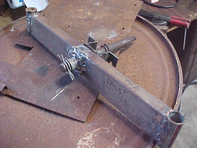

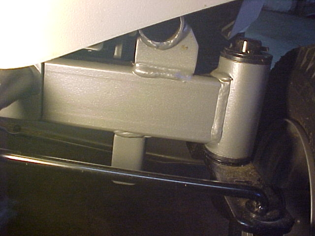

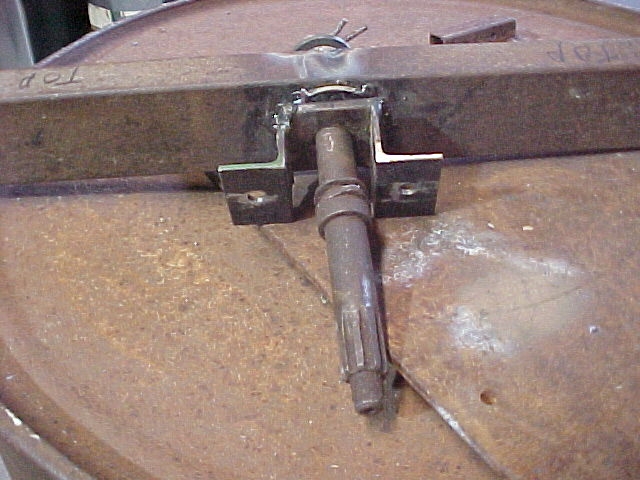

I finished the welding. This photo below shows the new beam and the support that bolts it to the original front beam on the mower. The shaft is from an outboard boat motor that I repaired a long time ago. And yes, I cut it off and it is welded in place. I didn't get a photo of the finished mounting bracket.
Here is the front view of the new beam

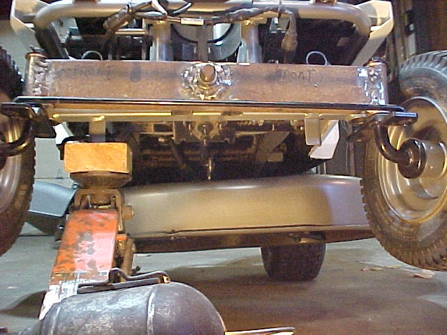

Here it mounted on the mower with the wheels in the new beam.
And here is the problem I didn't foresee. I wanted to keep the same track width as the original, but as you can see from the photo, the original beam limits the turning radius, the inside of the wheel hits the original wheel support.
With the cool/cold weather coming on, this will mark the end of the work for this year.
