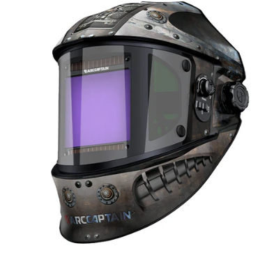

I just got the Accaptain auto-darkening helmet model LYG-0K-800H and it came with two larger plastic replacement lenses. But the outside of the viewing area has a curved plastic cover. I don't see any mention of this in the owners manual. So is that part a consumed part and is to be discarded after it gets weld splatter on it?

Yes, I understand that the flat plastic part can be replaced, the helmet came with two of those, I am reffering to the convex thin plastic part that is in front of the more solid plastic part. See this photo:

Funny.... The new set of model number does not match what you posted in post #1..... Do you really know what you have....
Yeah, I know. The photo I posted is cut and paste from their website. I did not have a photo of my helmet at the time.

Finally some photos of my helmet.
This is the overall view:
Here is a photo of the flexible, convex plastic cover in front of the solid, replaceable lens shield.

Got some information back from Arccaptain sales:
Dear Richard,
Thank you for your patience over the weekend while awaiting our response.
We appreciate your detailed questions - here are the answers for you:
  1. The flexible plastic part is the outer protective lens, which should not be removed. It serves as an essential shield, protecting the inner auto-darkening lens and sensors from sparks, scratches, and debris to ensure clear vision and long-term durability.
  2. For storage, please set the mode switch to the "Grind" position.
  3. The helmet has an operating temperature range of -5°C to +55°C (23°F to 131°F). For storage, no specific temperature is required – simply keep it at room temperature.
We hope this information is helpful.
I had ask what is the purpose of the flexible plastic on the front of the helmet. I think he is mistaken about it, as I have some flat solid plastic parts that are replacement for the shields that are in there now.
Sales, what do they know?
The user manual did not have the operating temp range or any info on what to do for storage. So now I do have that info.
