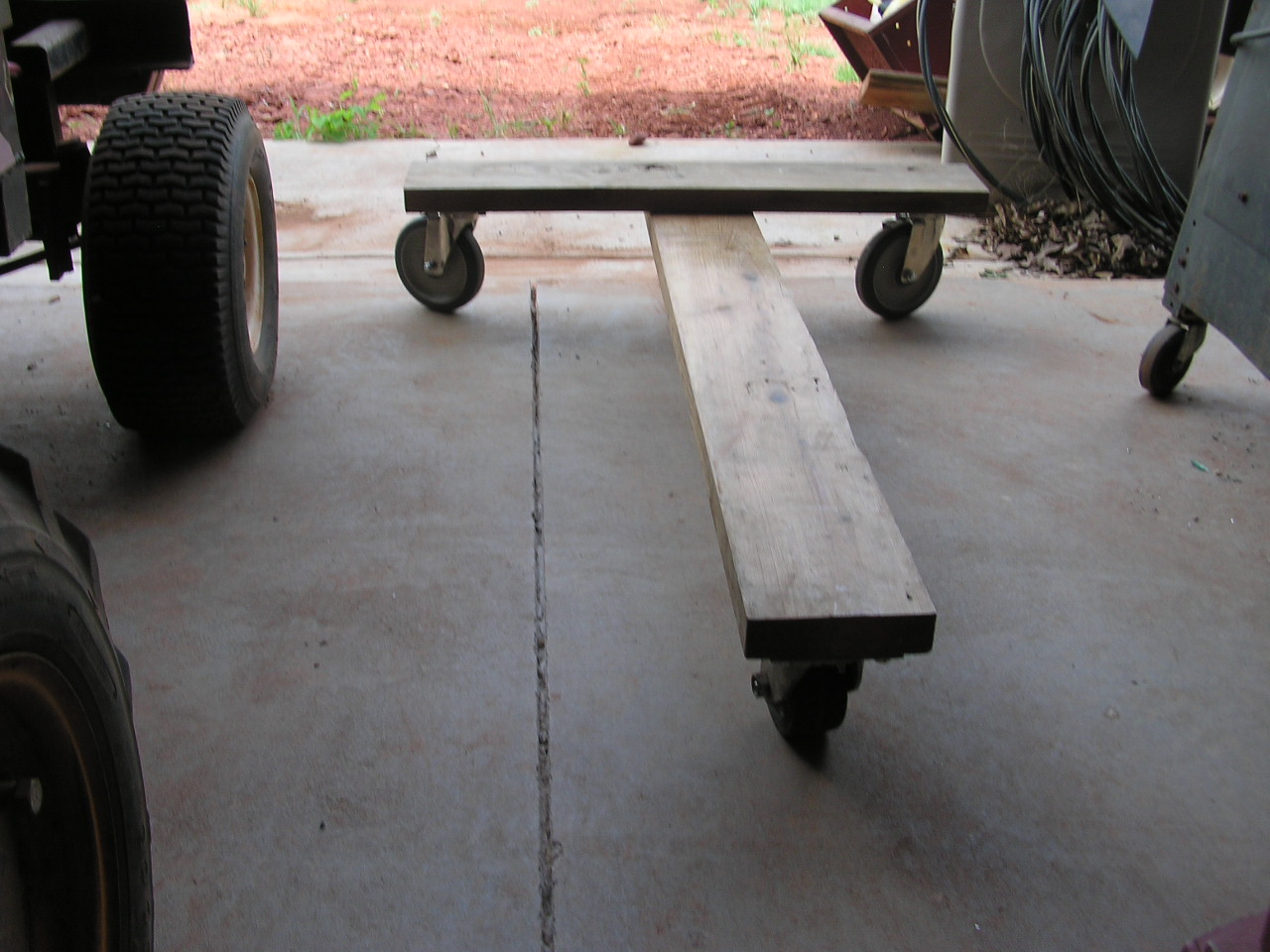

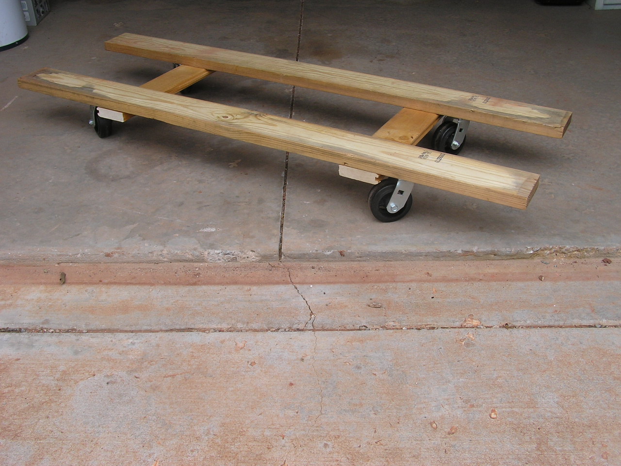

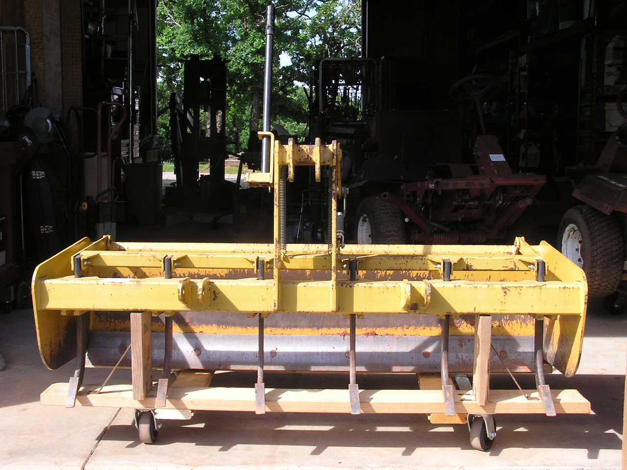

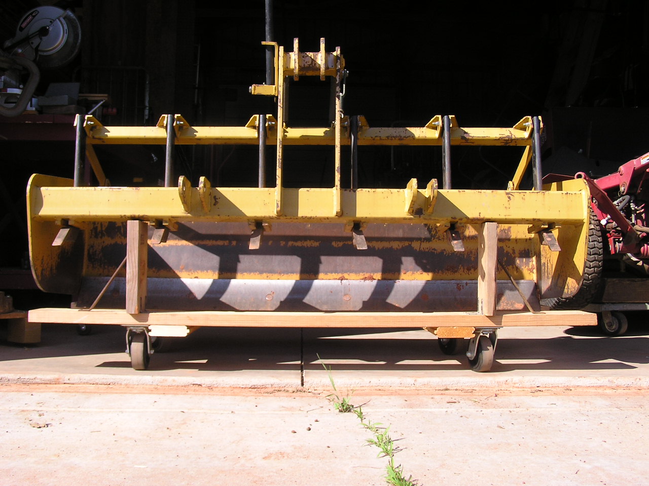

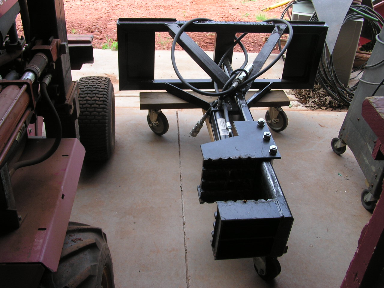

I use the small and large castor dollies from Harbor Freight under most things in my barn. I made a large wheeled frame for my 7' tiller, and everything else gets 1 - 4 dollies for storage and ease of moving. Even my BCS tiller and snow blower are on dollies. I keep the center of my barn open to move tractors in and out, and then roll all implements out from storage along the sides (some stacked several deep). I even have my kerosene heaters on dollies. Everything can be rearranged by hand with ease, within minutes.
/ Actual Turning Radius #6
All of my attachments are on 2 by wood dollies. Got the castors from Surplus Center.
Xfaxman, the last picture- vertical log splitter?
Also, thanks for the pictures
