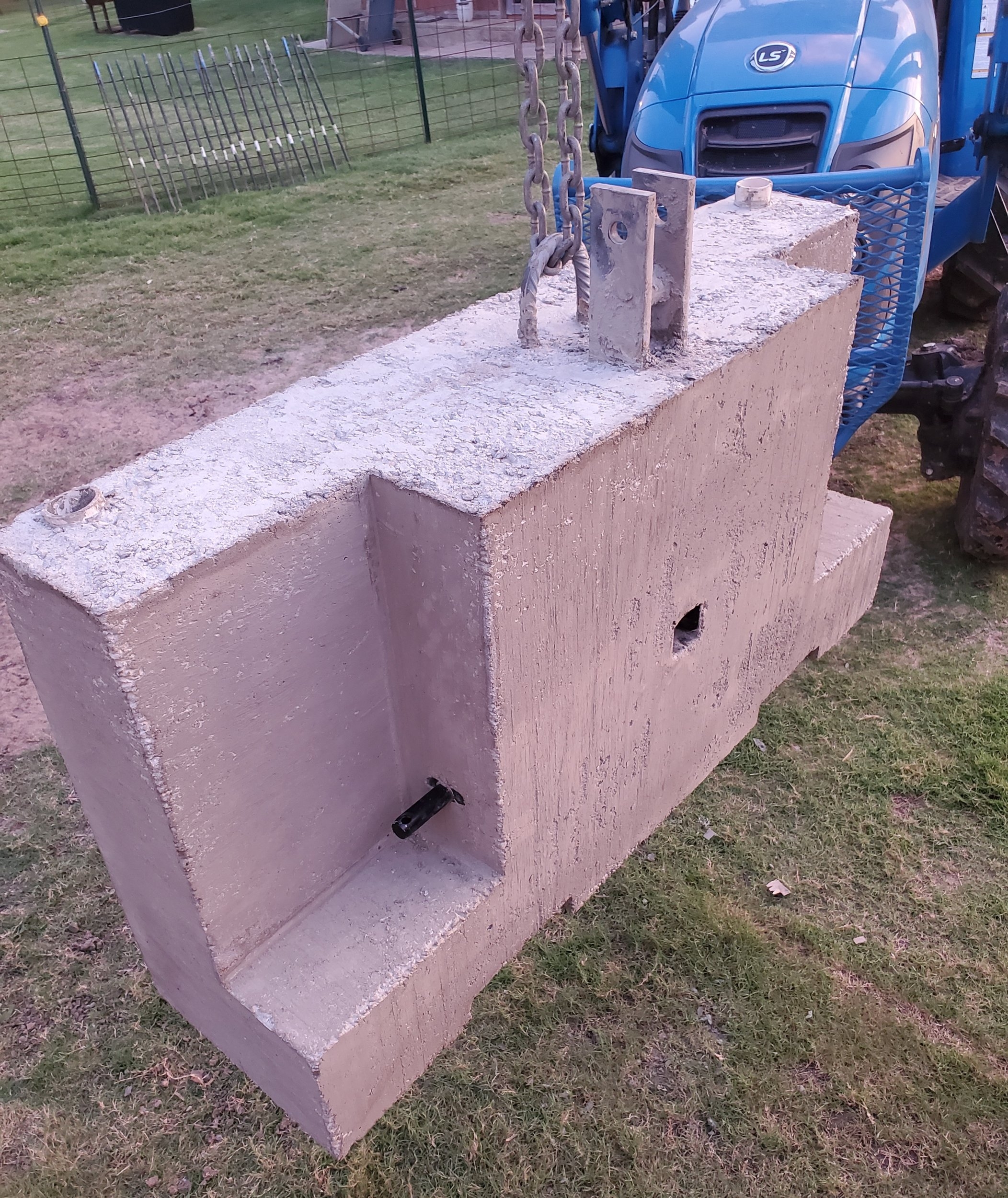

I watched a couple more YouTube videos on rear ballast box builds last night. It's interesting the things I'm noticing now. Most don't put a hook on the top to pick it up if they have to move it. One guy could barely get his quick hitch under the lower pins while the ballast box was still on the forms. I guess he will have to place it on something when he's not using it so he can disconnect it. I'm also taken back by how many guys post videos on how to build something without any experience mixing concrete. I get the feeling this is their very first time doing it, and they are very unsure on what to do. "Good Enough" is also used a lot do describe what they do.
   / Rear Ballast Weight DIY Build #49
I did the loop for when I did need to move it without having to use the 3pt or in case it somehow fell over as well as a tie down anchor for things. I put my tractor on the concrete drive and lowered the arms all the way down then raised them up 4-6 inches and made that my pin height when I made the form (I actually used a 3pt drawbar and welded everything else to that as I felt it was the strongest option for the money) so I knew I should always be able to connect or disconnect anywhere.
I have mixed my fair amount of concrete over the years, but I am not an expert. :)
#50
The loop on top is my favorite "extra" that I've seen. Even if I never use it, I like the idea that I can pick it up with my loader with a chain and move it anywhere I want without having to disconnect what's already on the back of my tractor.

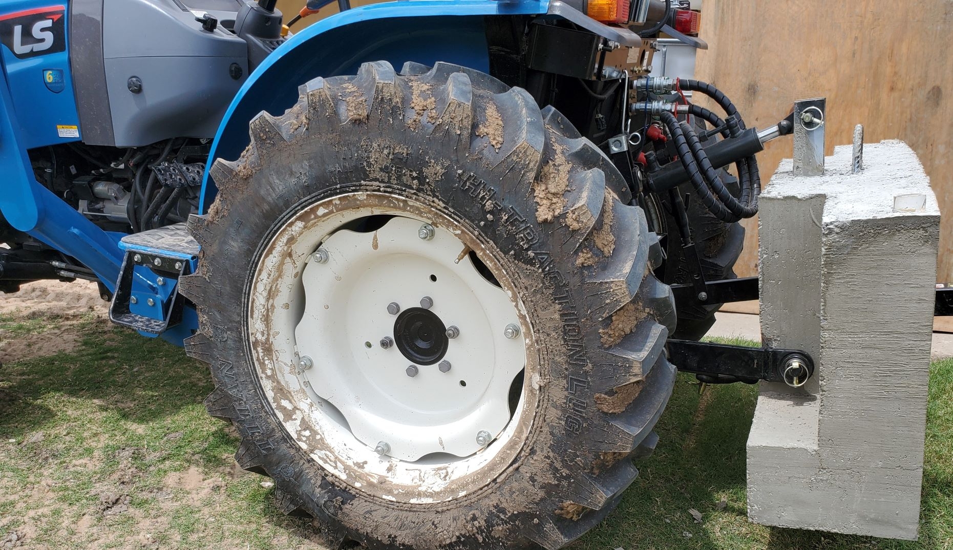

It's been a few months and I finally got started on building my rear ballast last week.
After buying the 3 point hitch from Amazon for $52, I discovered that it wasn't wide enough for my lift arms.
I cut it and welded on some angle iron to make it 8 inches wider. I measured how low my lift arms go on my tractor, and decided to make the Cat 2 pins be 18 inches from the ground.
I used scrap metal that I had in my storage container to create an internal frame. My thinking was to give the concrete something to form around so it was well supported. Might not of needed it, but it makes me feel better knowing it's there.
Total weight for the metal frame is 104 pounds.
#56

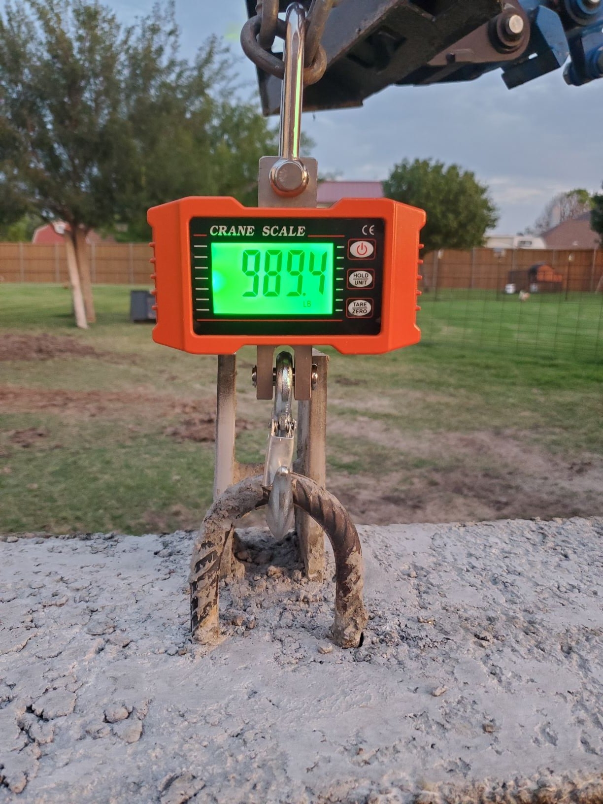

Yesterday morning I built a wood frame for the concrete. I used a single sheet of 3/4 plywood and made it 24 inches tall, 24 inches deep and 33 inches wide.
I used an online concrete calculator to figure out how many 60 pound sacks I needed, and started buying them ten at a time. For the calculator, went with 24x24x36 to be safe, and it said that I needed 27 sacks. I bought 30, and ended up using 25.
Total weight of concrete is 1,500 pounds, and with the 104 pounds of metal, it's just over 1,600 pounds.
I could probably take off the forms today, but I'm in no rush and I'll wait until the end of the week to do that. My goal is to use it next Saturday.

I hooked up the rear ballast today, and took it for a spin.
Right away, just driving down my driveway, I noticed a huge improvement in the ride. It was less bouncy and more comfortable.
I went to a dirt pile that had been there for awhile. I've gotten dozens of bucket loads of dirt from there, but never this easily. It just seemed like I had unlimited power. Zero rear wheel spin, and the tractor just gripped the ground like nothing could stop it!!!!
With a full load of dirt in the loader bucket, I drove to where I had take out some trees yesterday, and started to fill the holes from the root balls. It was angling downhill, and this is where I've had all my issues. A full loader bucket going downhill would lift my rear tires off the ground.
I was glued to the ground. It was more stable, more solid, more comfortable then I ever thought possible. The rear ballast has made my tractor more fun to use, and more powerful, if that's possible. It just goes and goes. There isn't any bounce at all, and I never felt like it was tippy, or scary. I was pointing down hill, and I would even get on weird side angles without any issues.
I'm impressed!!!
