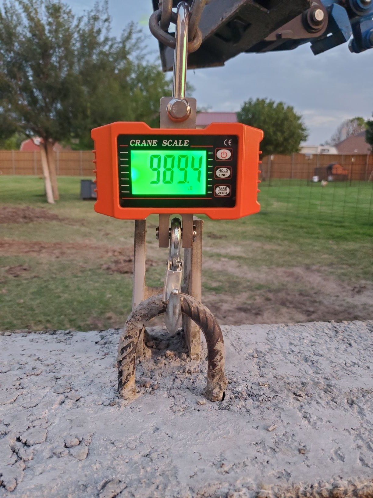

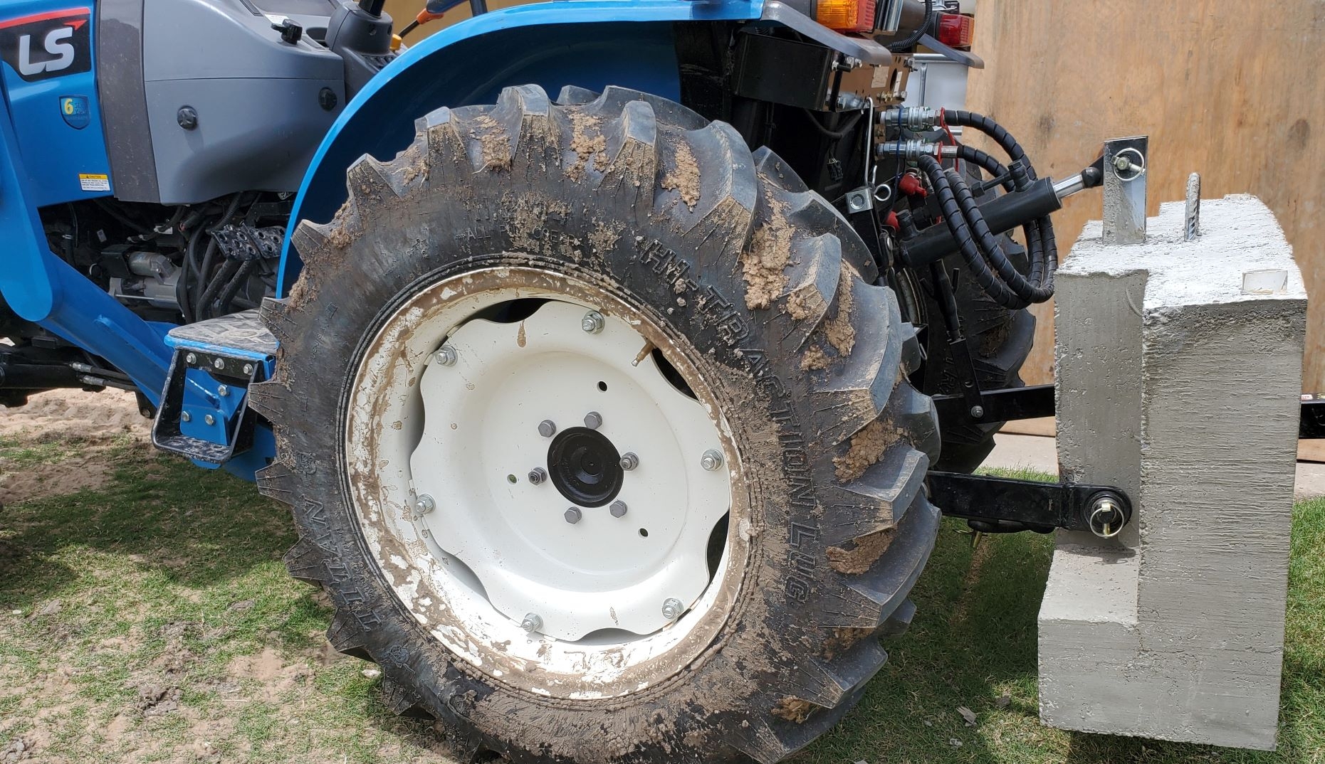

I was pouring a slab and figured to have excess concrete so I had the ballast box built and ready. I wanted something that didn't stick back far or wider then the tractor for manuevering in tight spaces.
I calculated the dimensions and was aiming for 1,000 lbs (~50% of what my loader lift capacity is). I got close enough for me :).
To me the ideal weight of the rear ballast should be 50-70% of your loader lift capacity.
Your tractor will lift a lot with no ballast, so with 50% or more on the 3pt, you can lift all your loader can handle and the rear tires will stay planted.

Thanks for the pictures. I didn't think about having a way to lift up the ballast and move it around when it's not on the tractor. Having the rebar sticking out like that would make it easy to pick up with a chain and move it out of the way if I needed to!!!
   / Rear Ballast Weight DIY Build #25
You're welcome.
I do recommend spending more time placing and SECURING the PVC pieces for tool holders (Shovel, pitchfork, rake, etc). I last minute threw in 2 scrap pieces that were too short and didn't secure them. I had to position them and hold them in place while the concrete went in. I should have had pieces long enough to go to the bottom board and secured them in place so that rain water would just run out the bottom. One day I'll use a mason bit with an extension and drill them on through the bottom.
I also had planned to install a small board in the form with a 45 degree bevel by the lower 3pt links to provide hookup clearance in the concrete. I forgot and had to use a mason chisel to remove some concrete.

I've seen where some people put tubes in their ballast to hold shovels, or something else. What do you use the shovel for? Do you haul stuff around in the ballast box? It's been my experience that if I need a shovel for something, it's part of a bigger project like fencing, and I have a big load of stuff that I'm hauling to where I'm working.
It would be simple to add some PVC tubes to a ballast box, I just don't see what I would use it for.
   / Rear Ballast Weight DIY Build #27
...I just don't see what I would use it for.
I removed the tubes from mine, wasn't worth it. I didn't put a drain in the tubes, so they just filled with water. Also found a manhole cover that fit perfectly on the top of the 55 gallon drum that I used.
I'm thinking of modifying mine to set out even further back away from the tractor to increase the effect of the ballast. I need to relocate the 3PH pins anyway, so trying to kill 2 birds with one welding job.
Luckily, the guy that built my welding table thought ahead and added a lifting loop.
That top is double 1/4" steel sheet, plus structure,,
my estimate is that the top weighs 700 pounds.
I can move it with forks, (my 48" forks reach beyond the center of the 6 foot width/length)
but, lifting off that loop on the side is MUCH safer!!
The legs are kinda flimsy,, probably only 150 pounds total,, but, it survives!!

My 2720 with cab weighs about 2200 lbs.
My ballast box weighs 600 lb with some concrete in it. It balances out the front mount snowblower, but only I only need it when the snow is very deep, otherwise I don't need it.
I add about 500 lbs of steel to it when using my pallet forks.
Both weights (600lbs & 1100lbs) seem about right...not to heavy and not to light.

JD 2720 bare tractor 2000lbs (according to tractordata) you find 500-600lbs good ballast. Thats about 25%-30%
My old L3400.....bare tractor 2600#. I liked 1000# on the back. Thats 38%
My MX I find 1000# not enough for my MX.....bare tractor 3800. 26% not sufficient.
George2615 in post #3 has a 3200lb bare tractor and likes 927# ballast. Thats 29%
Steven Gables post #5 has a 7000# tractor and likes 1700#....24%
Bearsizty7 has 989# on a 2900# tractor....34%
Dont get any more real-world results than this. Seems 25% of bare ROPS tractor weight is what people use on the lower end of the spectrum. And 35%ish on the higher end. I know I personally tend to favor the heavier weight, especially for a heavier machine that can handle it.
For eddies 4707....t-data lists bare ROPS tractor weight at 7734#. So the 25%-35% range would equal 1933#-2700# for ballast. Maybe able to favor the lower end of that number because he has a cab which adds a tad over 900#.
But in either case, I think the initial 1000# idea is just a bit too light. Especially given so many find 1000# about right for 2500-3500# tractors
