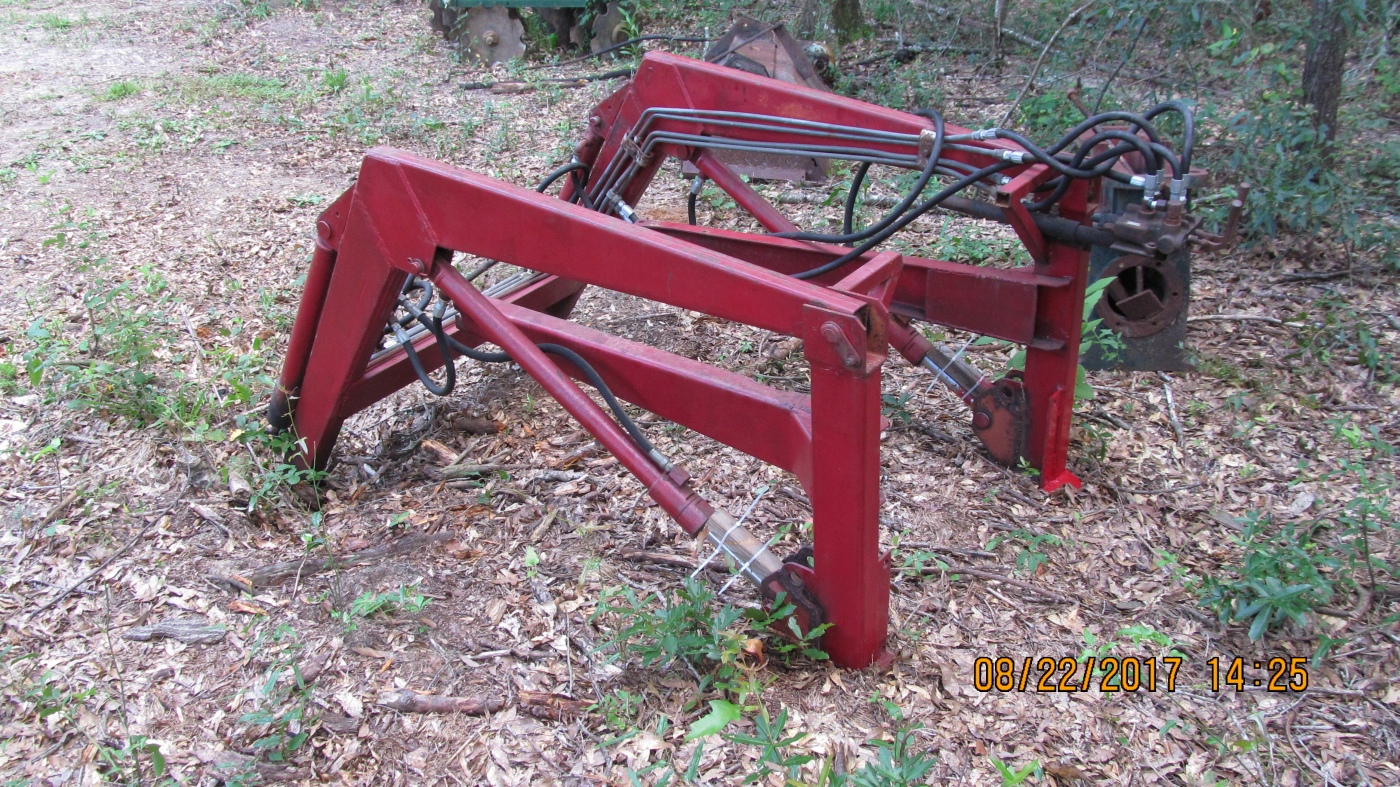

Here is a picture of the loader. It looks similar to modern loaders except for the controls. I am hoping to tie into the power beyond that is already on the tractor.

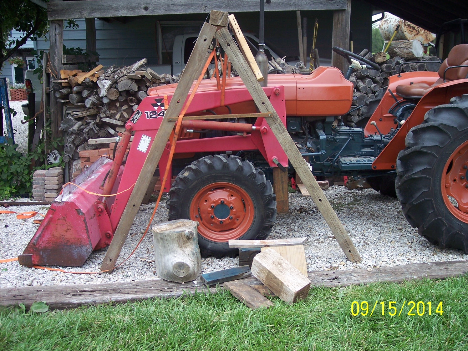

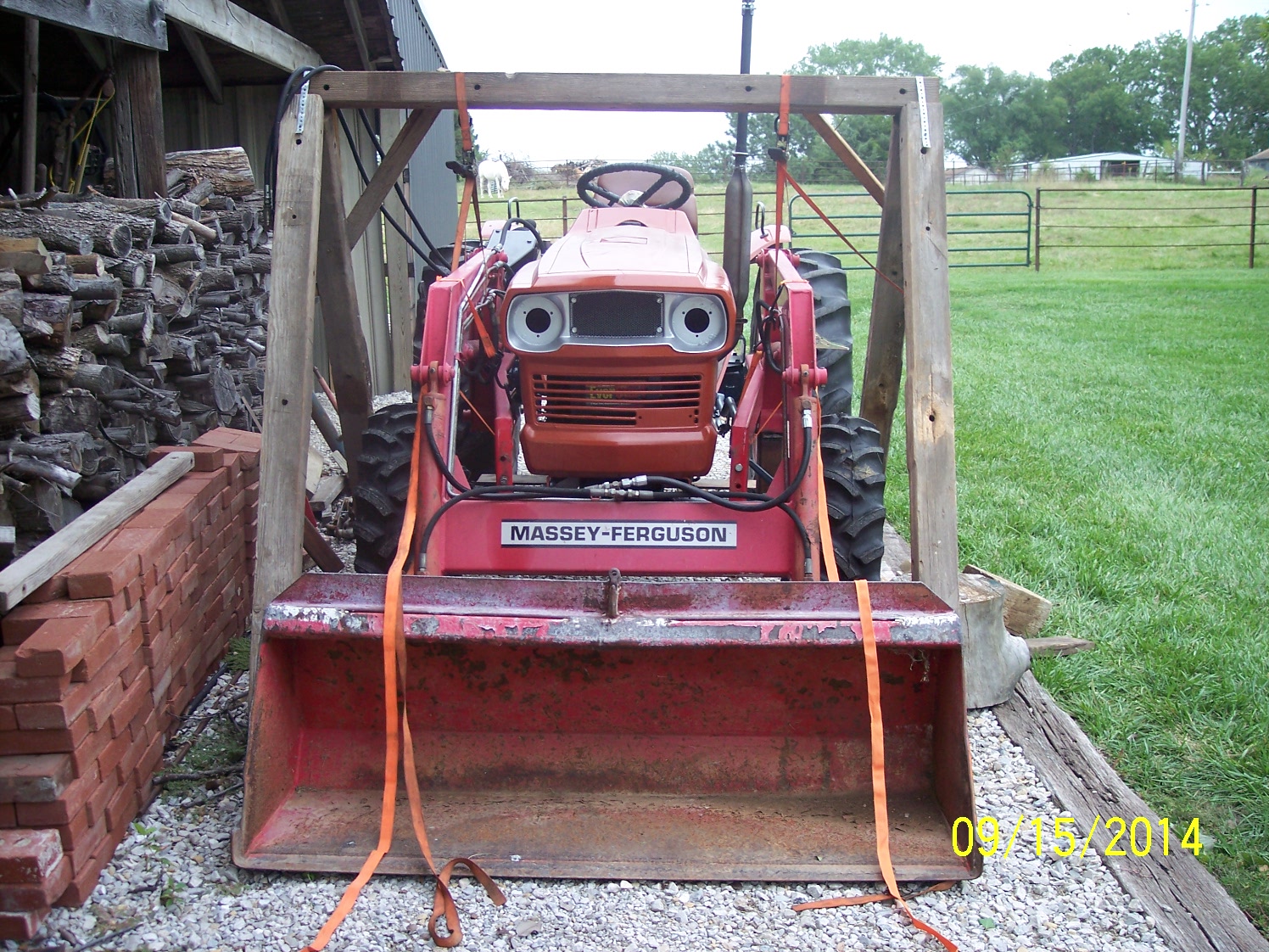

You have to get the loader towers in the correct position, not too far forward, not too far back. The steel under your tractor has to support the loader and everything you'll put in the bucket or pick up with any hooks. The front of the loader has to be anchored to the frame of the tractor for the same reasons.
You also need some support from the bottom of the towers to the rear axle on both sides. The width of the loader arms can't be too wide, and too narrow will interfere with tractor frame, steering, etc.
I was working outside, so I make an A frame from some 4x4's to hold the loader. Then I could move the tractor a bit as needed.
This is a Massey loader I put on a Kubota L305.L305DT loader mount 004.JPGL305DT loader mount 001.JPG

I don't think this loader is that much larger than a 70A but no way to weigh and compare. Most of the metal in this loader looks to be about 10 gauge with a few 1/4" thick gussets. The 8N it came off of had a Otis elevator gear case hanging off the back of it. I might make it more adaptable to the 3pt hitch but not sure the 855 will pick it up.
The A-frame is a good idea and I was thinking I would need something like that to hoist this off and on. I don't think I want to leave it on the tractor unless I am using it. The loader was attached to the 8N with 8 bolts and I was planning a similar attachment to the 855.

It occurred to me I did have a way to weigh it and that would be a very important aspect of the adaptation. Turns out it weighs 440# without the bucket. that is the loader, lines, and controls. Mounting steel won't weight more than 30#. This unit came with a light weight 48" bucket that I will either not use or will cut up to make a dirt sieve out of.
Looking online for weight references I found a shipping weight on a 70 loader of 700#. I also located a shipping weight estimate of 231# for a JD 48" bucket with lines and grill guard.

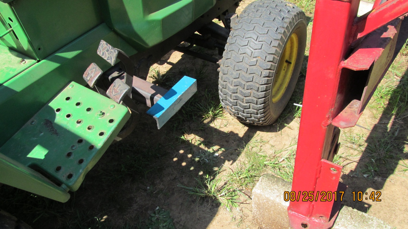

SOOOOOOOOOO it's looking like this may be a near perfect adaptation for my 855. I plan to mount it with the rear uprights centered over the square tube built into the tractor for the loader mount. I see the 70A loader mounts with the rear arms a little forward of that. My bucket location will be very close to stock. I need to go get some pins to attach it before final fitment since the previous owner took it off and lost the pins.

And here is the approximate mount for the rear arms.

Besides bolting the uprights to the blue angle iron on the cross-tube, will there be anchor points higher on the upright?
I wasn't planning any. This is the way it was being used on the 8N. There will be two additional supports on the front of the frame.

Um...is there room for that upper pedal to travel with that crossbar in place? It looks smack in the way from this angle...
Just checked both sides and it looks like there is plenty of room. Don't know why the angle of that first photo looks like it's almost touching.
