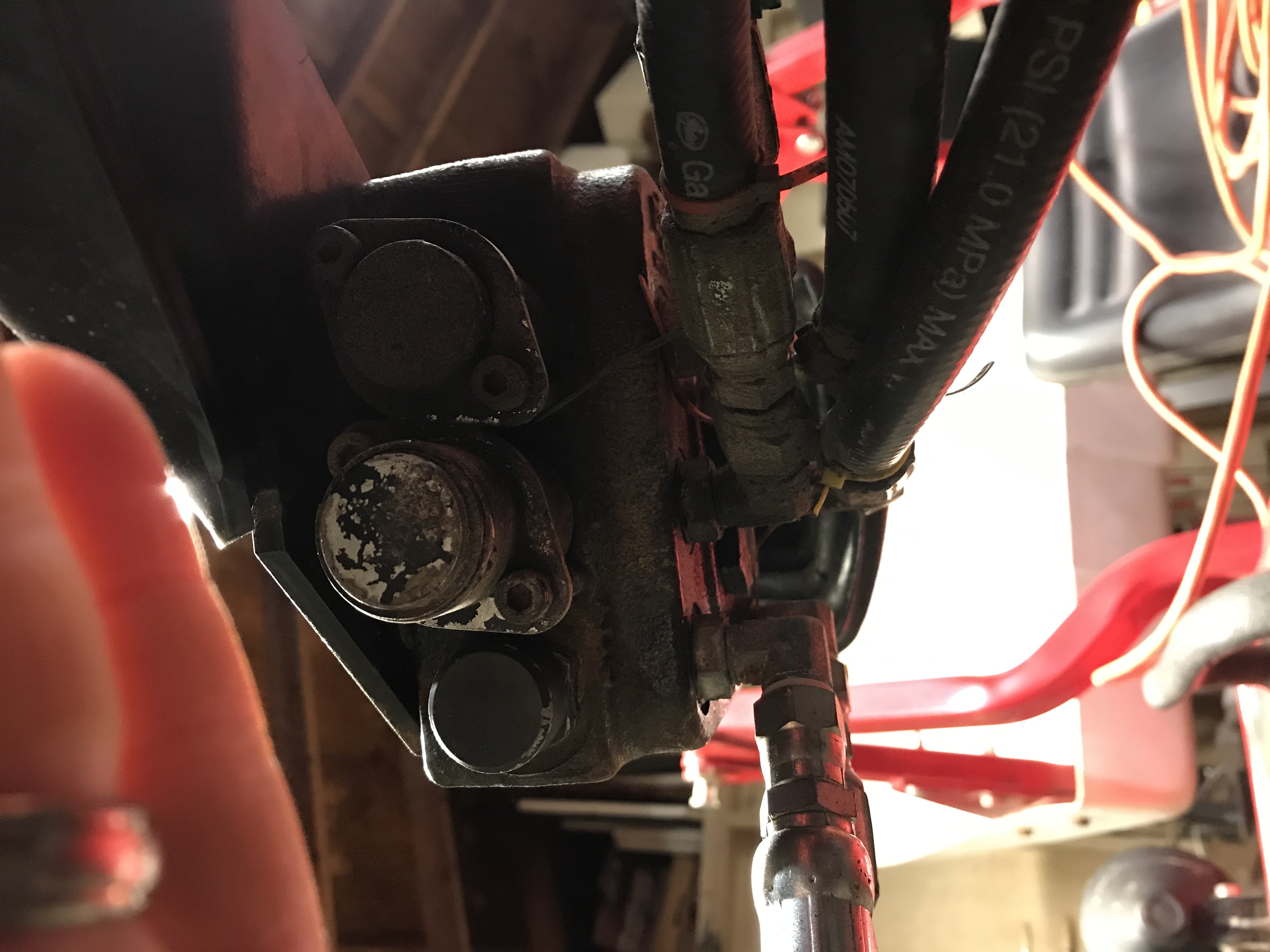

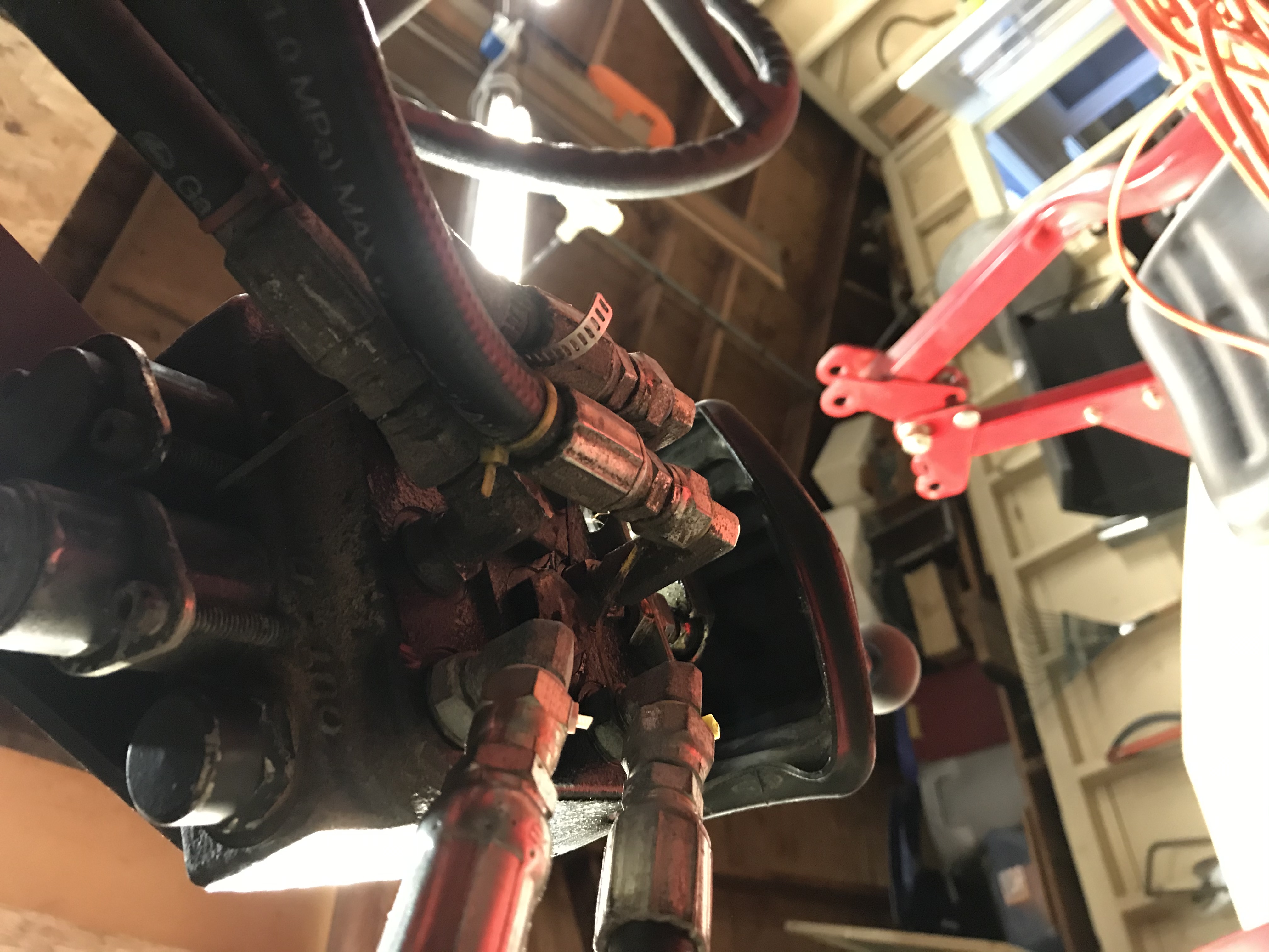

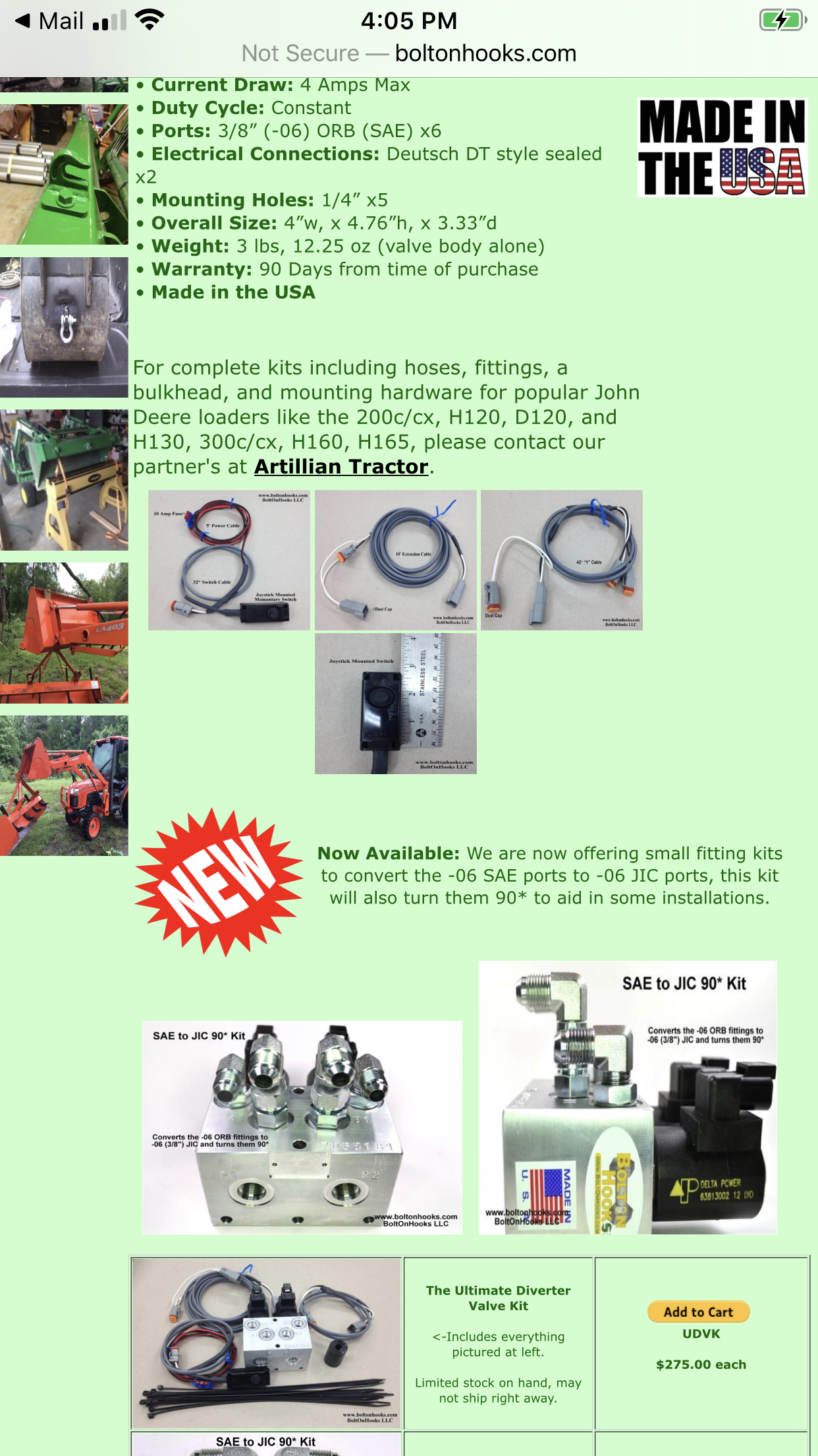

Has anyone used one of these diverter kits successfully on a Jinma/ Farm pro? I finally have my Spirit loader (similar to Koyker, with a joystick) installed and functional and I壇 like to add a grapple.
/ Add a diverter? #2
The big question I have is the valve, is it a 3-way or 4-way? 3-way valves often don't play well with diverters. A few more questions:
1) Is there a noticeable detent when pushing the valve to the right?
2) Does the valve have 6 or 7 hoses attached?

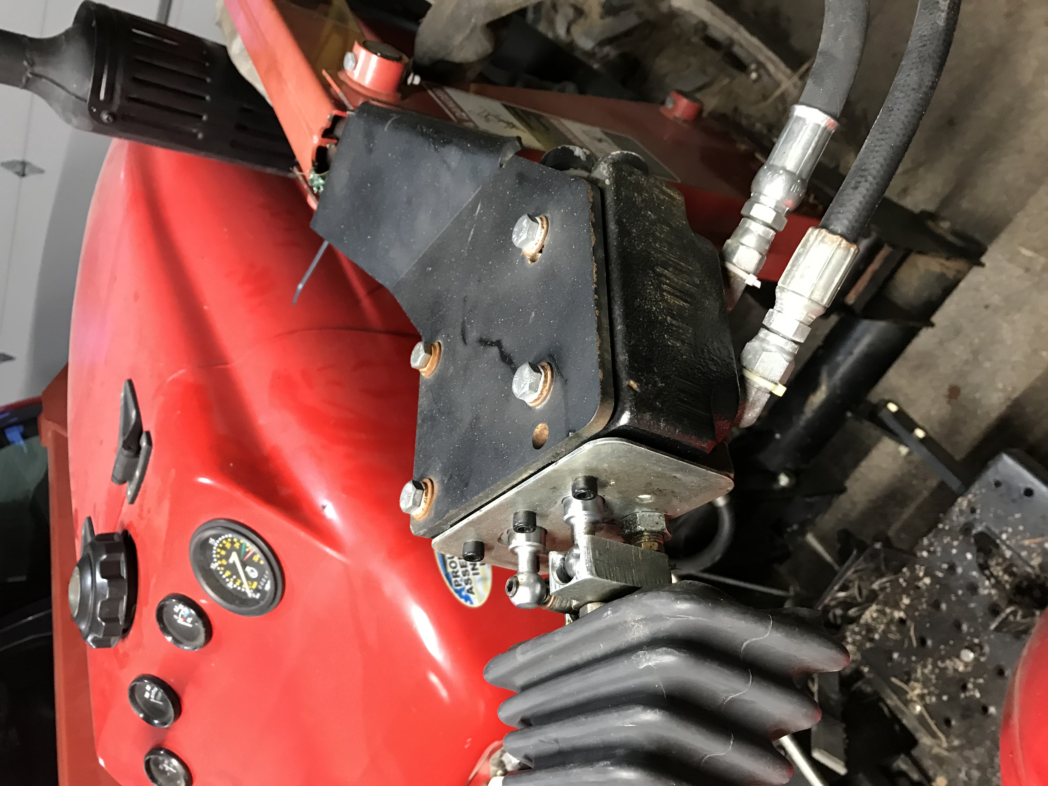

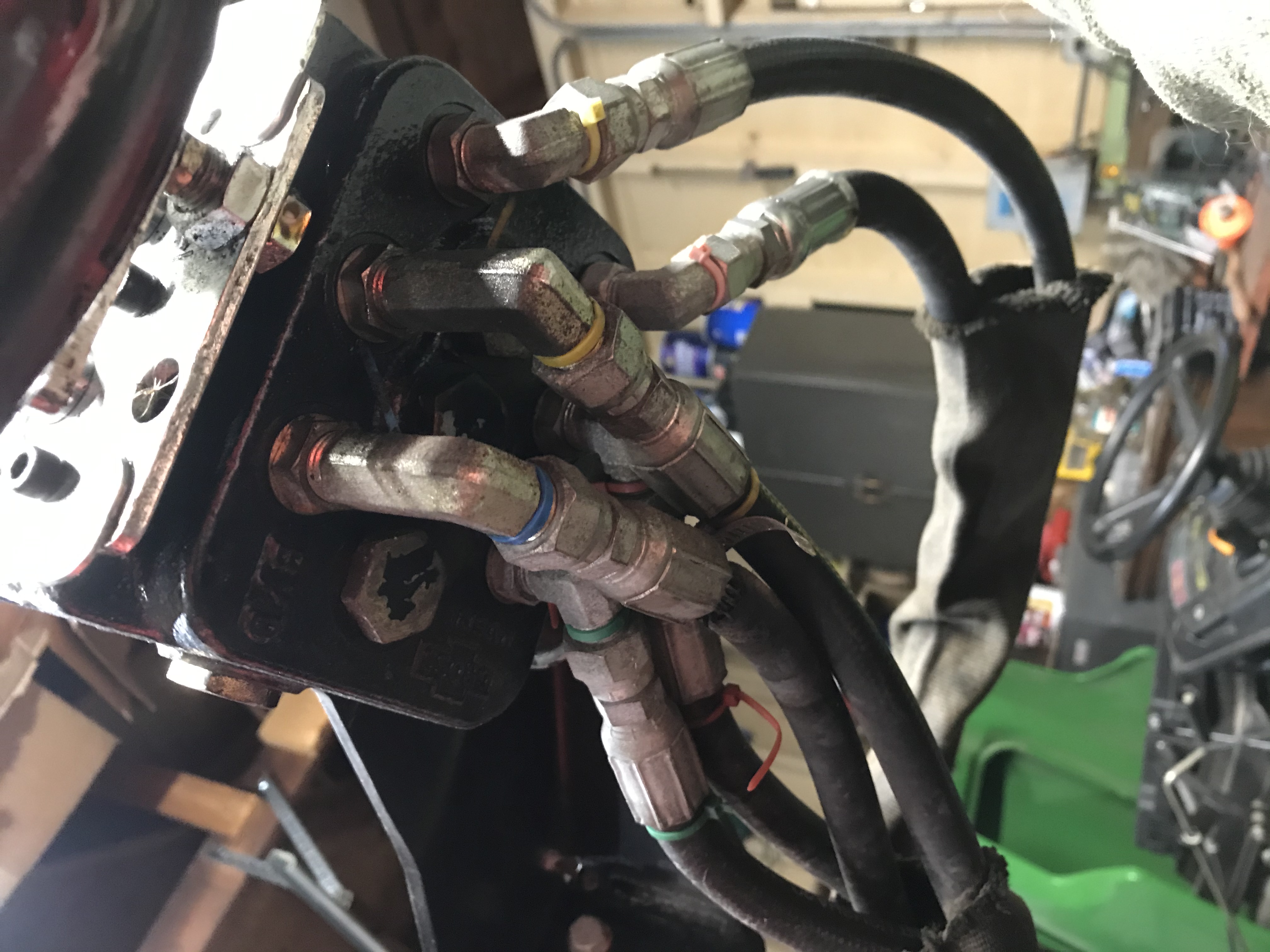

The only detent I feel is to lower the bucket- nothing to the side.

It's very likely that one of the flat faced hex plugs on your joystick valve stack is actually a power beyond port, and just a simple adapter installed in place of the plug will allow another circuit to be installed easily. The tricky part is finding a brand and model number of your joystick so the appropriate adapter can be found.

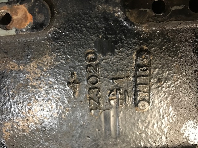

It's a Cross 4Z3020.
/ Add a diverter? #11
Cross tells me I need a conversion plug and can then tap the byd port with a 3/4 16 SAE-8 fitting.
