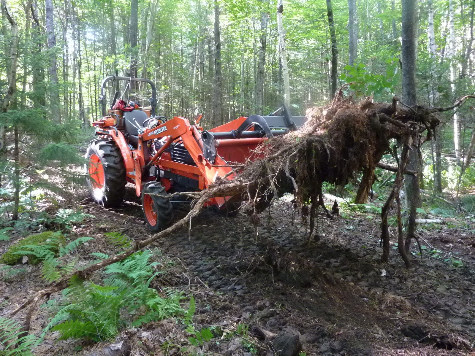

I put an Add A Grapple on my pin-on 48" bucket of my Kubota BX25D a few years ago. I also have a Piranha toothbar. Like you, I move dirt, logs, mixed debris, etc. I am very pleased with how it works. I removed the grapple once just to see how it went, but have not bothered to do it since. The grapple has stood up to some nasty use without bending or breaking. To pick up most effectively, dump the bucket so the bottom is vertical, then close the lid. The purchase through Agfolks was easy and pleasant.

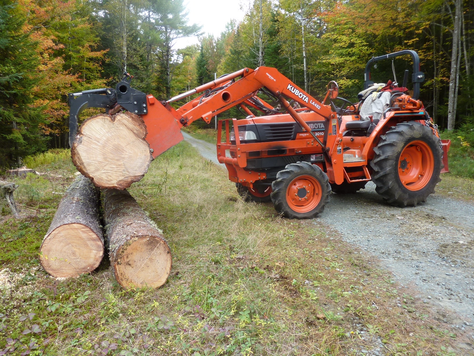

I have a 5' pin-on bucket on my 2001 L3010 and bought a ATI grapple kit for it a few years later. This was long before SSQA FELs were common place. It worked very well. Here is the original.
I have made some improvements since then. Mostly little things but the first, like others have said, was to add a tooth bar. That made a huge improvement in being able to grab stuff easier and quicker. I also lengthened and added some curvature to the tines.
It is a very useful unit. You want to mount it to maximize the distance between the bucket sides and the grapple tines while keeping the tines parallel, as much as possible, to the edges of the bucket sides. It is harder to grab and securely hold stuff if your tines are angled with the bucket sides like a scissors unless there is a good hook on the end of the tines.
I wouldn't be without this grapple on my pin-on bucket but that being said if I had a SSQA FEL I would buy a dedicated grapple. I have two tractors and a graple for each. The L3010 with the pin-n bucket with a bucket grapple and a M5640 with a SSQA FEL and a dedicated grapple. The dedicated grapple is more capable especially with the amount of brush it can handle. Just my opinion here.
