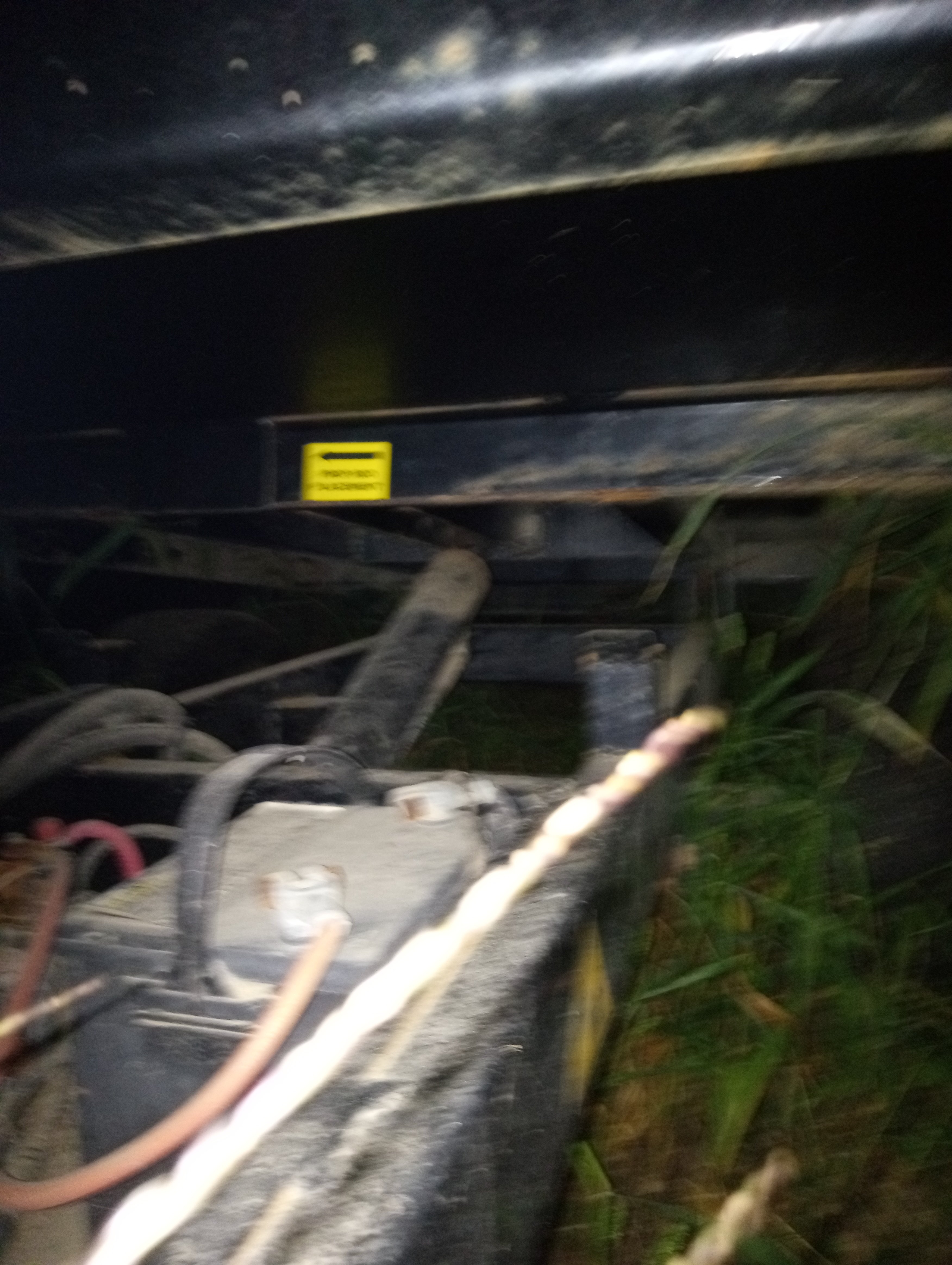

I just saw this. My Suretrac dump trailer is very similar except that it does have 3500# springs and is street legal. I would like to add brakes for when I'm pulling it with my Colorado. The problem is that it only has 10 inch wheels which are too small to fit brakes. Increasing wheel size would require me to cut the bed and add fenders, as the frame is too narrow to put in a wider axle.
It may be a good IMG_20241001_185710681.jpgwinter project.
