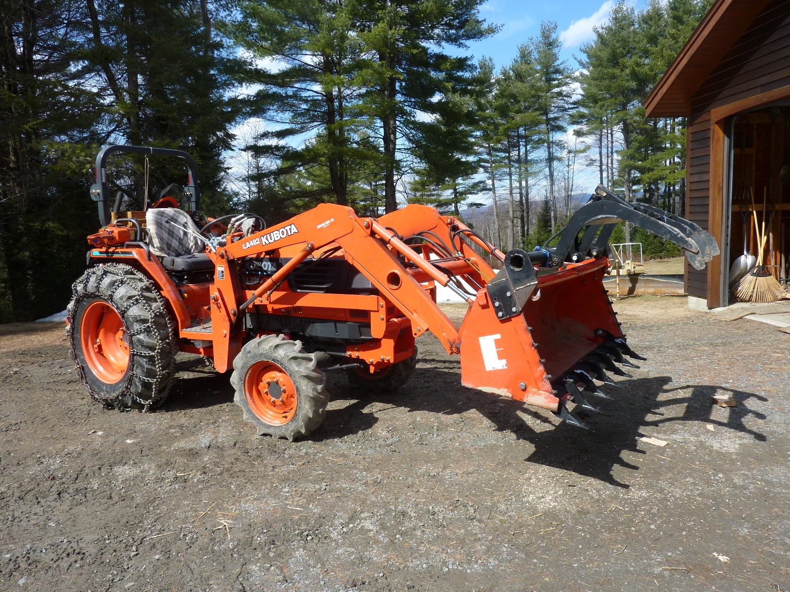

I purchased my Land Pride SGC1560 grapple and WR Long 3rd function from the local Kubota dealer. He did the installation - at no added cost. It's a very well thought out fit, for the 3rd function.
I checked my paperwork. Grapple - $3175. 3rd function - $1195.
This was in 2013. I'm quite able to do a lot of things. However - hydraulics is not one of those things.
I have pics of the 3rd function and how it was fit on the tractor - if you would like to see.
Good dealer.
Glad to hear that.. I am already dreaming about the tree limbs and tops I'll be able to move around....
And absolutely, I'd like to see photos.

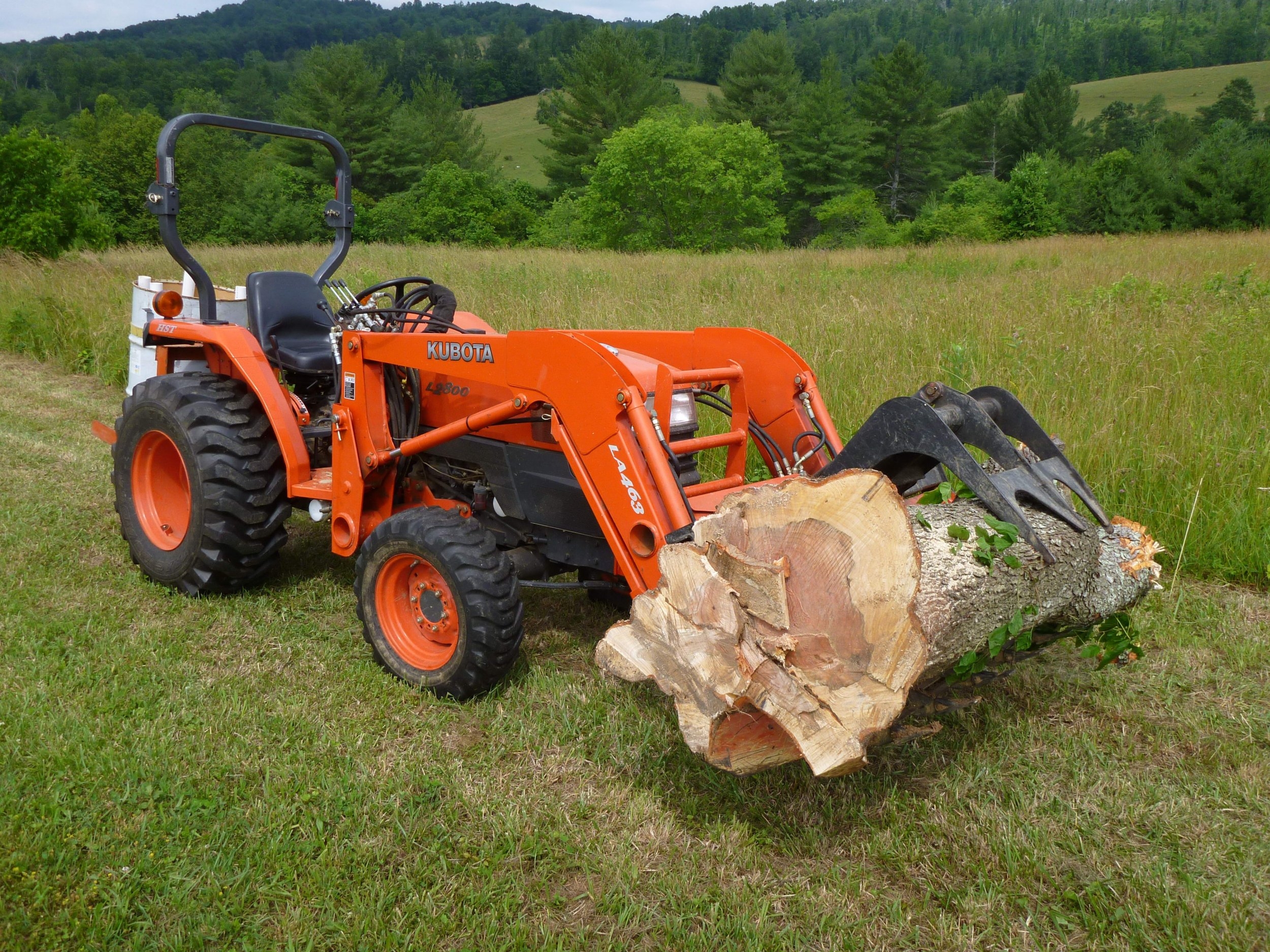

My LA504 has a pivot pin capacity of ~1,000 pounds. I suspect you are moving a lot more than 1,000 lbs... I have a lot of ash tree logs to move around.. I hope my FEL can work as good as yours..
My loader is an LA482 with the heavy duty curved bucket - 1060 lbs.

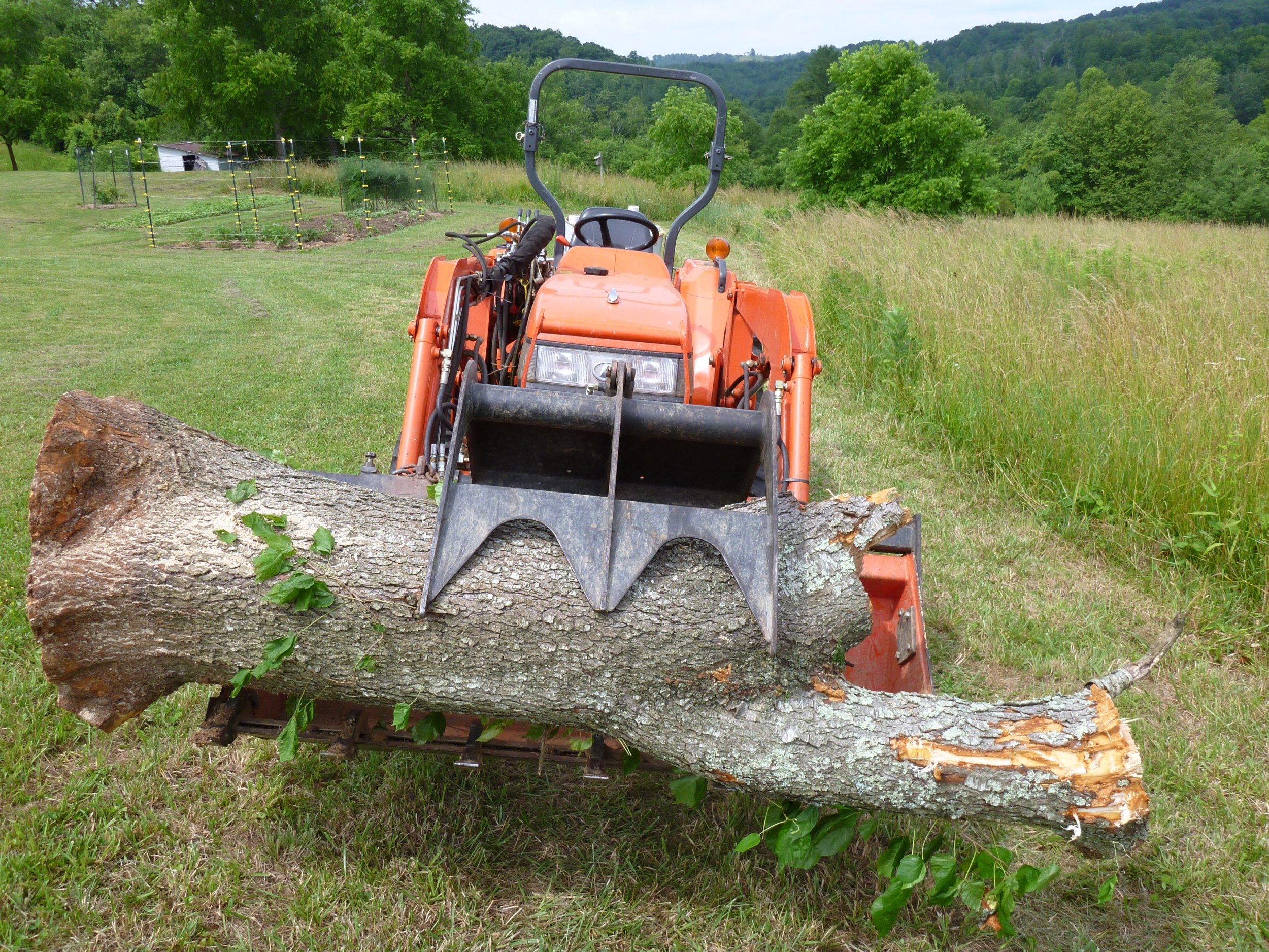

Just for reference, talking green wood, a 10' white ash log 12" in diameter weighs 375 lbs and at 18" diameter it would be 850 lbs

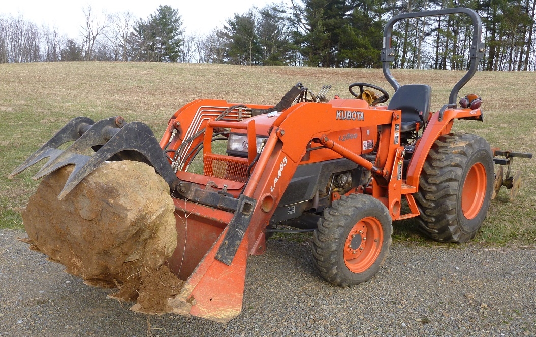

One Lid has been more than enough for me (60" bucket), I can not see where I'm going sometimes if I grab too much.
Two grapple lids weigh #230 for $1,415 - the OP has a 60" and somewhat limited lift capacity.
The single, Light weight one is #133 - mine is 143 pounds and fits nicely with my capacity.
I would imagine your TC45DA can handle 2... no problem.

I can confidently say that a 10' ash log 12" dia feels like it weights about few thousand pounds when you are trying to move it without a tractor. I joke you not.
But really glad to know that a possible future GOB should be able to handle moving some logs! This is great news. I thought it was out of question.
