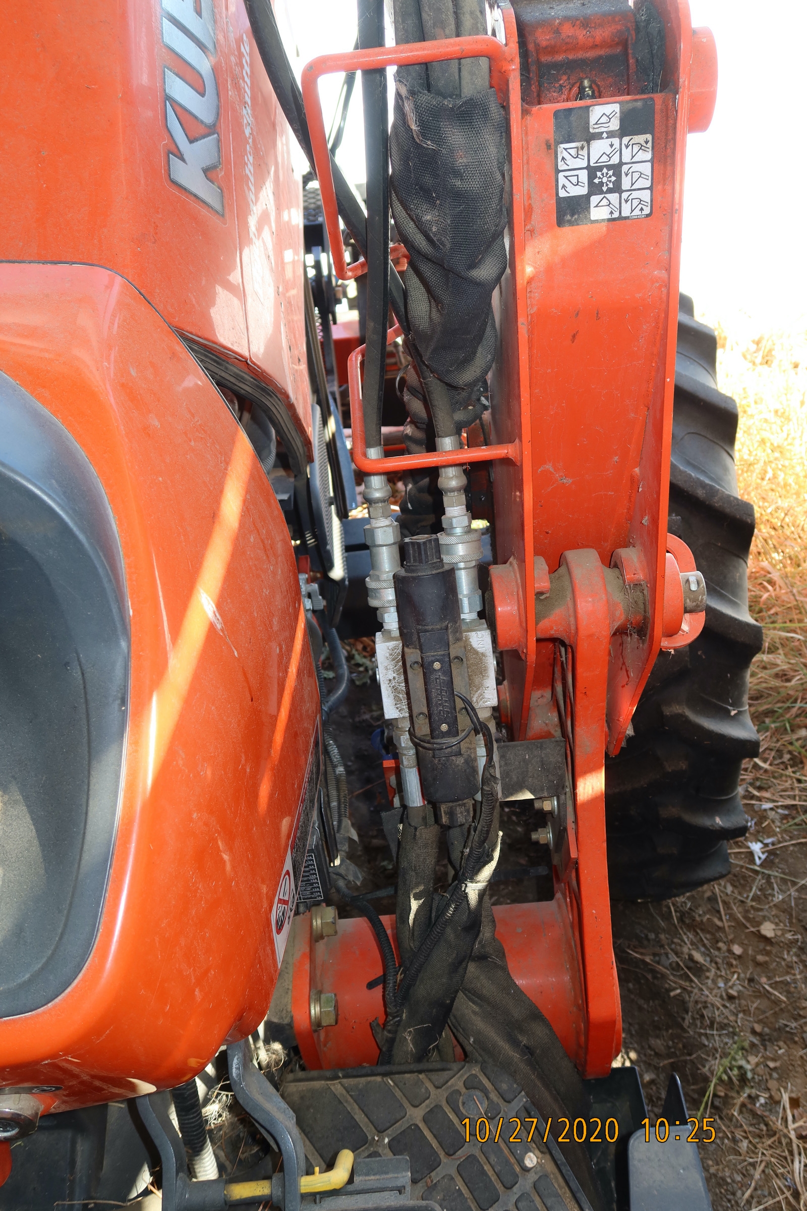

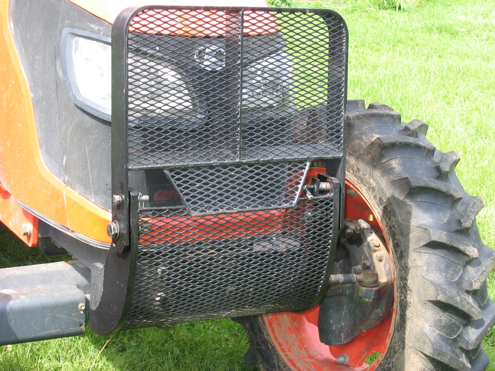

- now the pictures. You should modify your grill guard to protect your grill, radiator and battery. Limbs, sticks and stobs have a very nasty way of poking holes in things. There are several posts here on TBN - showing what other members have done. The dealer had specific brackets that allowed the 3rd function to be tucked in between the tractor and the FEL vertical member. It's been a very good location for me. Nothing has ever got suck there or caused any damage.

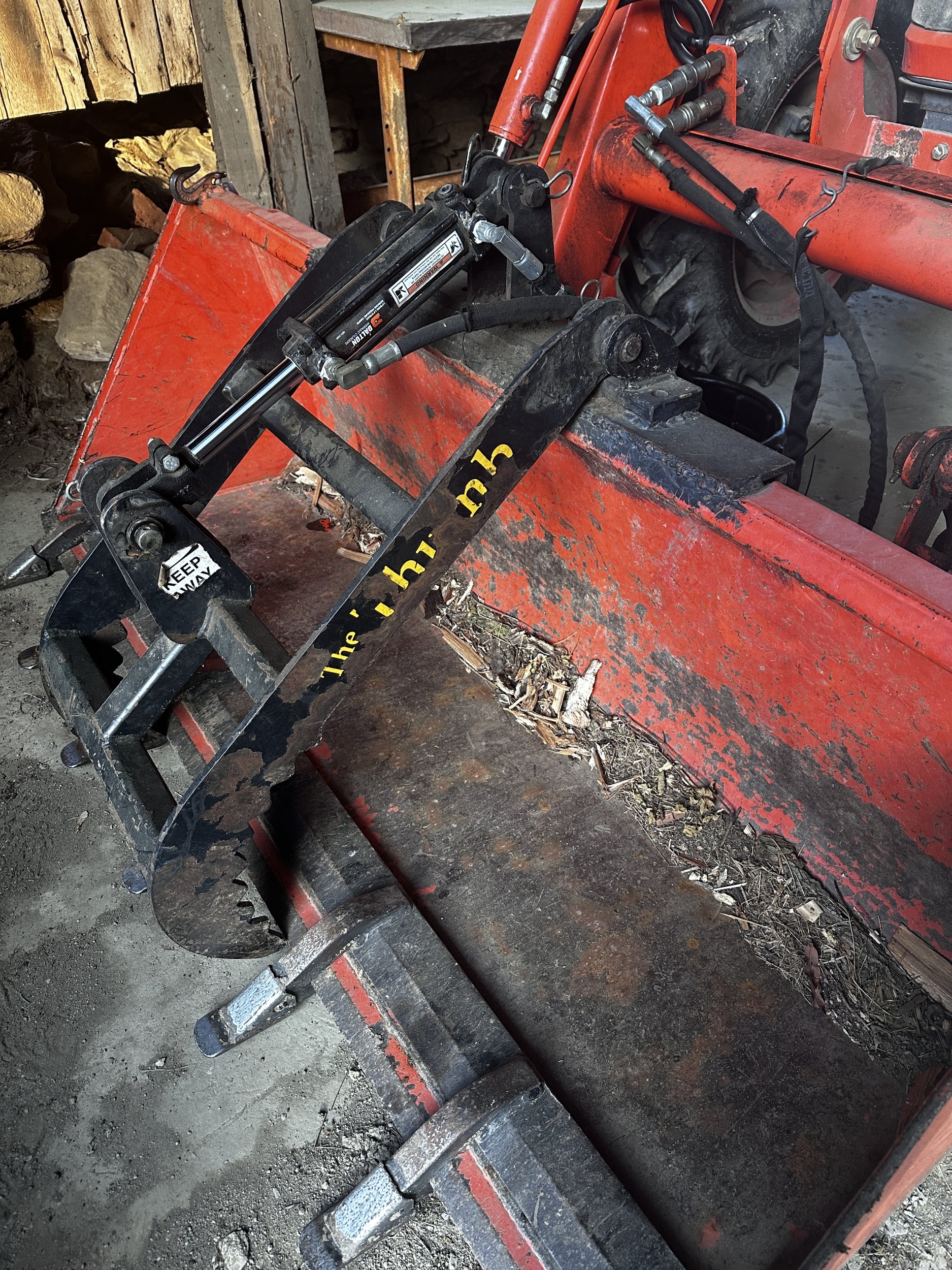

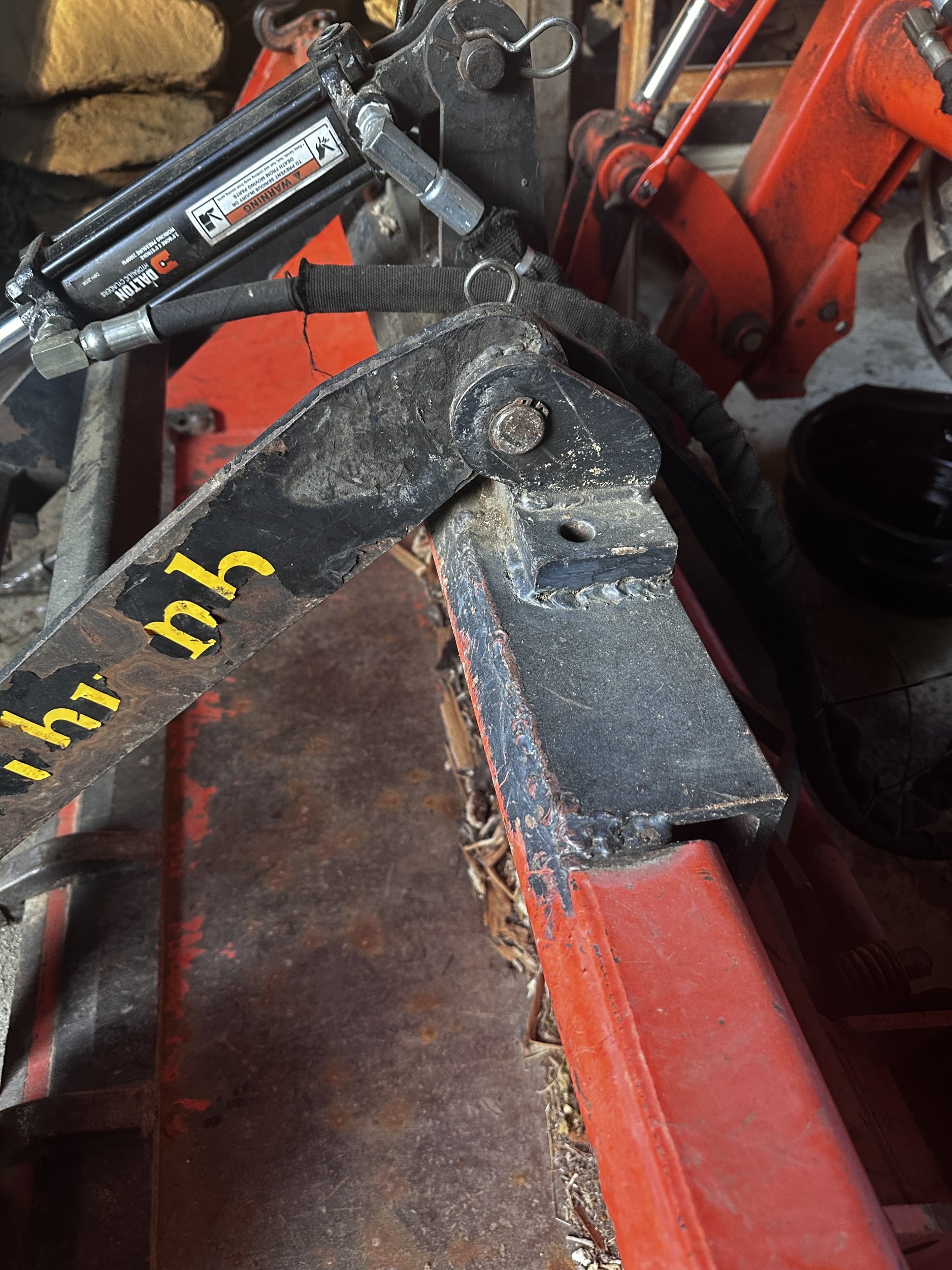

Welded on a short section of angle iron to the top of the bucket to mount the Thumb. It has functioned very well and used for rocks and logs weighing several 1000 lbs. Easy to take off just remove a couple of pins
