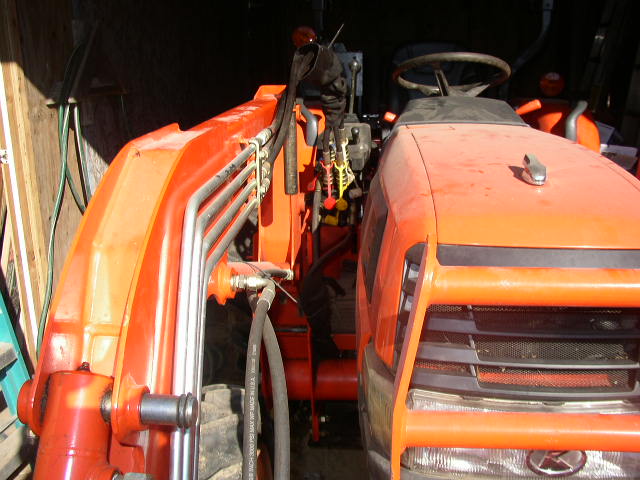

I'am about to get started on set of grapples for my L3130.The mast an arm setup is a little different than yours but I do have room on the inside of the arm.
Since mine is tubular I was wondering do you think its ok to drill through or maybe weld some bolts on and slip the valve onto them with nuts an washers.
   / Added Remote to FEL...
#37
Sanman,
I am hesitant to answer that question without seeing the setup you have, any chance of posting pics of the loader mast?
I did not pre-plan the location of the diverter valve, I ordered it and then when I had it in hand, set out to find the best, most out-of-the way place to mount it. If you are sure you are going to do this, go ahead and order just the valve.
Good Luck
   / Added Remote to FEL... #38
kenny:

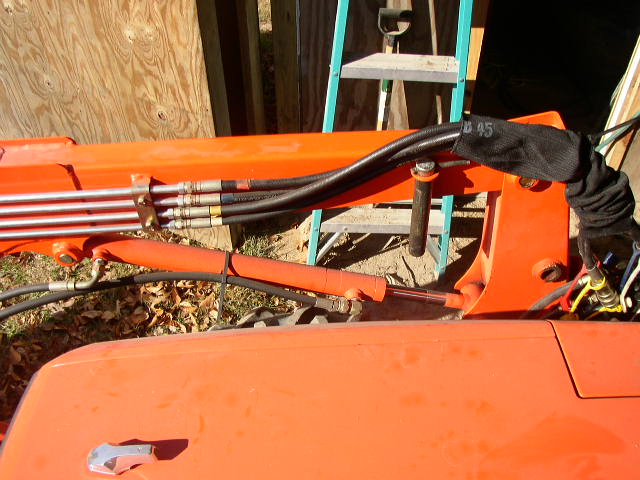

the loader frame is raised alittle bit to get a better view.the top two hoses are bucket curl, and I was thinking about mounting the valve between the loader pin and metal connectors which is about 12or13".
L the loader valve hoses to diverter IN, loop short hoses from OUT to the metal line connectors and L lines from diverter ports to grapple cylinder QD's.

   / Added Remote to FEL... #39
as you can see, there's not much room anywhere else.
