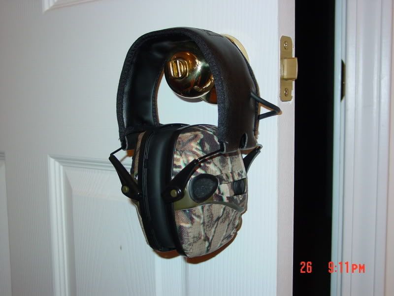

Pat, I bought a set of Howard Leight electronic hearing protectors to use when I deerhunt. You can turn up the volume all you want, or way down if you want. The areas I hunt if I see a deer, I typically have time to put them on before I shoot. So, I don't usually wear them for a 3-4 hours at a time like during an entire hunt. Although, they do help keep your ears warmer! These were a highly rated product for the price and you can probably google the reviews on them. Here is what they look like but I ordered mine from cheaperthandirt.com
Howard Leight Impact Sport Earmuff
Sorry, but haven't learned all the in's and out's of this site yet and how to post pic's. I had some camo tape left over from when I did my truck and so I put camo on them:
