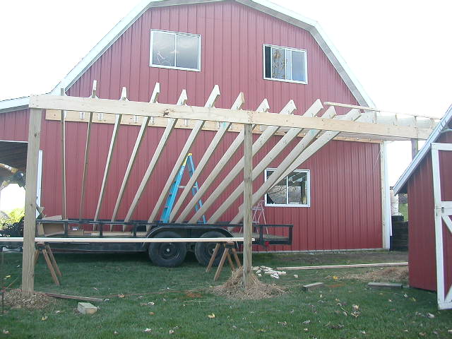

I finally started on the lean-to last Tuesday. I have it all framed up & ready to start putting the steel roof on. I have a few pictures & will post them when I get a chance. (at work now).

Here's one not so good pic.

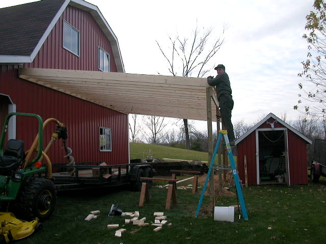

Another. I was planning on putting up the roofing tomorrow but it looks like rain for the next two days.

nice looking place, the 2x8 should be good for our areas, mine west of you 70 miles sowest of clevelan, snow load is not bad for metal roofs as the actualy roof is not that heavy... mine is all wood with 2x6 on 16, with 7/16 roofing with clips between rafters. setting on dual 2x12 striners. felt & 30 yr shingles... only spanning 10' out from wall though. snow load wasn't calculated on mine, but it faces north, and had a lot of build up last year, about 12" + for a month almost as sun didn't reach it, high gambrel roof prevents sun from reaching the basic corner between the roof vertical & low pitch of the over hang.
anyhwo it looks like a nice place to play, I would remove one of the upper wondows and put in a slider then add a deck for shooting off of, and it don't matter if you have agun or not all you need is a beer and something to soot! lol

Thanks Spiker, that's one heck of a nice looking barn you have there. The dump trailer looks darn good too. I envy the flat ground that you have.

One suggestion - It looks like you used a single joist running between your posts. Over time you'll likley get some sag in the middle (looks like 2x 8's?) Add another one on the inside of the post the whole length of the lean too, then add a few vertical pieces that will run between the two joists and attach to the rafter. Maybe every third one. Ties everything together and helps reduce the side force on the posts. (Apologies in advance if you planned on doing that and just haven't gotten that far yet!!!)
