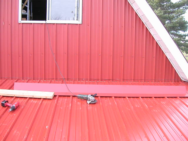

Here's a few pictures of how things turned out. First is putting the sheeting on the roof.
   / Adding a lean-to
#39
Putting the endwall flashing in. This was a little tough. I cut the wall siding with a Metabo. I had to take a row of screws out above the cut to get enough room to slide the flashing in. I probably should have made the cut wider.

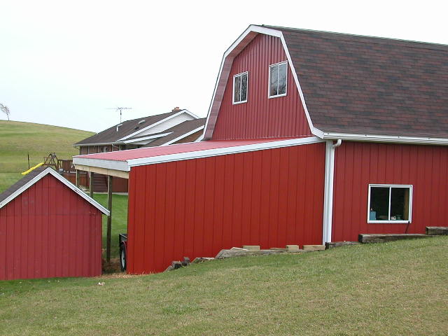

The backside that I put siding on. The other two sides I left open for now.
