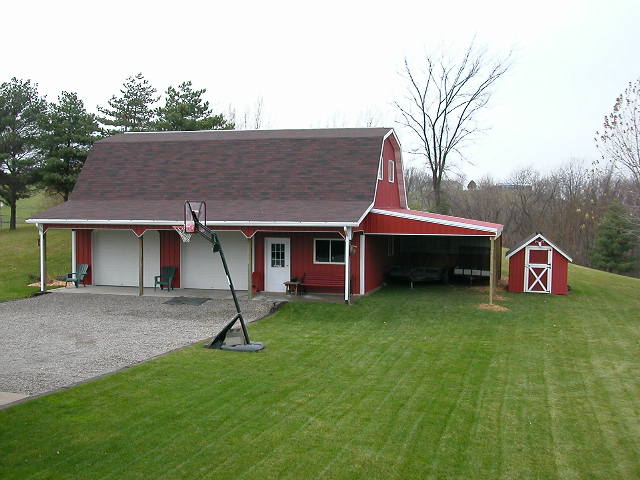

#42
If your not tired of it now, here is the last one. The little shed needs to be moved. That was a goat barn that I made a few years back. It is on skids & the object was to drag it to different places that the goats would be keeping the weeds trimmed. Didn't happen & the goats have long been history. Especially after they got loose & trimmed everything but the weeds. /forums/images/graemlins/tongue.gif

   / Adding a lean-to #43
That really looks nice. It gives me some motivation, because my barn will be gambrel-roofed with a shed roof on one side, like yours. I'm even leaning towards the red color. I like your barn a lot!
One thing that I took notice of was how nice it looks with the metal siding. I was leaning towards hardi-plank on sheathing because I realy didn't like the look of the metal-sided buiildings I've seen. But, you've done such a nice job with the trim, etc., it really looks like a traditional wood-sided barn. With the cost of sheathing gone so high, you've given me something to think about. Did you insulate/finish the inside? If you get a chance, could you take a snap or two of what it looks like inside?
I'm not building a pole barn; mine will be stick-built on a monolithic slab with engineered trusses on 24" centers, one of the reasons being that it was easier to get engineered to the required 110 MPH wind load around here.

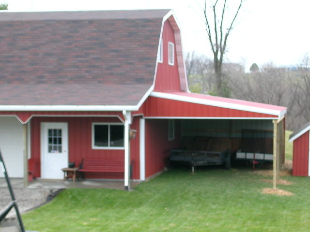

   / Adding a lean-to #44
Good job.
Question: How did you handle the flashing up against the originonal building. The fact that the buidling siding is not flat makes this complicated to get a good seal?
Fred
   / Adding a lean-to
#45
As you can see in one of the pictures the flashing is pre-bent to a 120 deg. angle. It fits up in the building siding 5 inches. On the roof side there is a foam piece that fits the profile of the steel sheets. It goes down first then the flashing which is supposed to prevent any water from going back.

   / Adding a lean-to #47
Can I ask how you attached the upper header to the exsisting building?
Nice pics, looks like you did a great job.
--->Paul
   / Adding a lean-to
#48
Paul, thanks. The place where the board is attached is the same location as 2nd story floor joist. I just used alot 20d nails.
