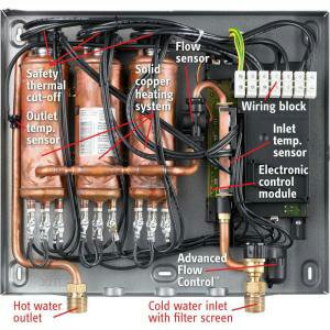

Tankless won't work without new wiring. Your little 12-3 wire will barely run a hand sink tankless at less than 1/2 gal per minute. But it will get hot, just runs slow.
There are tankless whole home systems that will do whatever you want but they run into 36 KILOWATT. That's probably triple 4ga wire or bigger and it gets expensive quickly.
They are the best and will work in any climate. Just depends on what you expect and want to spend. Remember they only run when the water is on. Not having to heat 50gal of water 24/7 in the winter while you're at work.
   / Adding a second water heater #53
This one from home Depot will raise incoming temp 65 degree at 3.03 gpm. That's well over shower use.
It's rated at 120 amps, 28kw. You'd probably need another panel just to use it.
It's 773.00 plus wire and breakers but you'd never run out of hot water again and probably save money on your bill.
