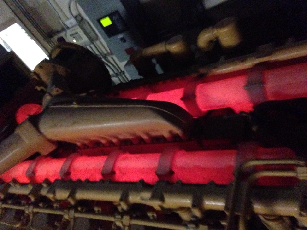

At full load the exhaust stream will be 1200 degrees or more. There is little change from one end to the other due to the volume of exhaust from an engine and it must be able to run at full load indefinitely.
OK then, that blows my thoughts all to pieces LOL, I honestly didn't think it would get that hot...........Mike

That’s a K50 Cummins but pretty much any commercial genset engine looks like that at full load and is expected to be able to run like that indefinitely.
Commissioning testing requires running at full load anywhere from 4 to 24 hours and occasionally 48 hours but within an hour the far end of a 100’ insulated exhaust pipe will be 1000 degrees. The exhaust stream doesn’t change temperature much from the engine to discharge.
