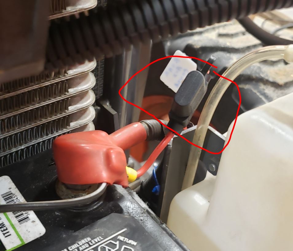

I used the work light plug located under the fender - only powered when key is on
and yes I fused that heavy line from the battery to the relay AT THE BATTERY. I used a 40 amp fuse - I'll never draw that much off the back relay. Your fuse should protect the wiring going back to the relay. If you run 18ga I would use a 3amp fuse, I used 10ga.
Most definitely...
And wire gauge should be calculated for "maximum" load....
