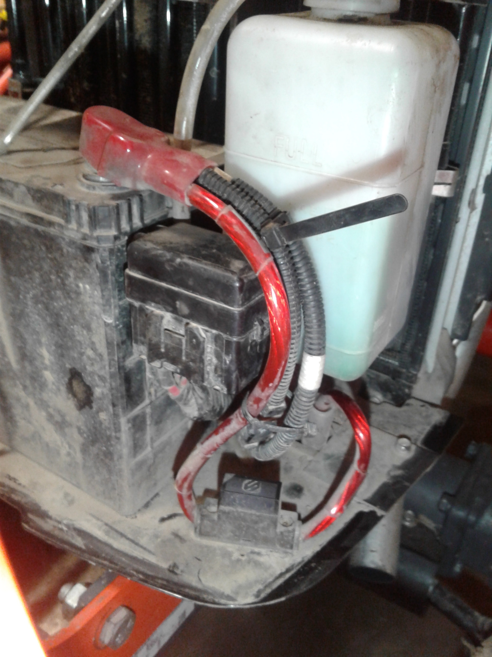

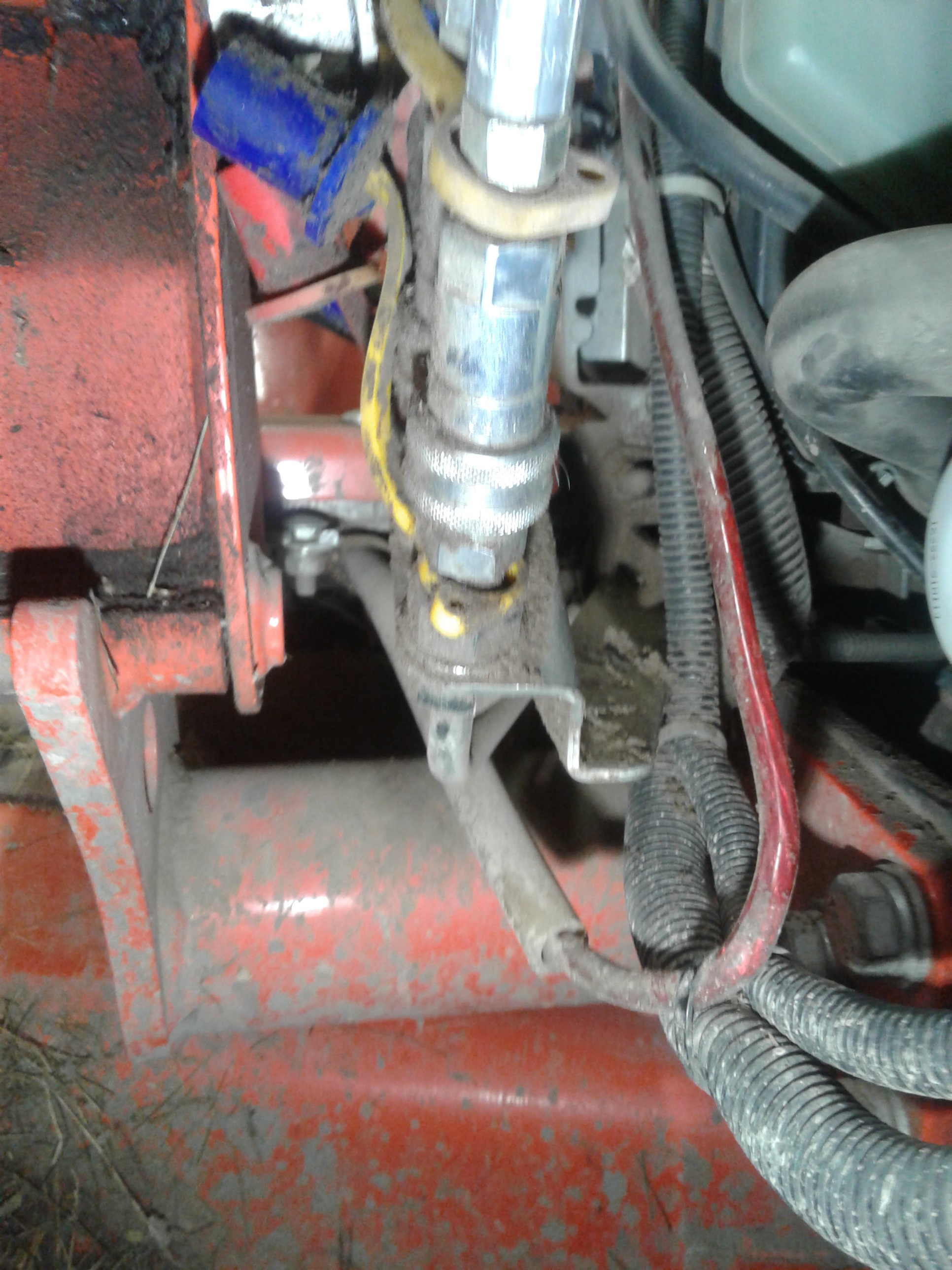

Purpose of post: to provide general ideas to fellow tractor owners wishing to add lights, electric sprayers, even some high current accessories for short term intermittent use (think winches, jump starts).
I'll start with the high power preparations.
#1 good heavy duty wire, at Walmart you can buy power amplifier wiring kits (reason: high quality multi-strand wire with flexible insulation). I bought the heaviest one, 1600 watts, I think. It comes with an 80 amp fuse block. Replaced 80 amp fuse with 60 amp fuse. Winch has it's own 50 amp fuse.
#2 extra protection for high current wire. Farm stores sell spraying equipment bought chemical rated hose for it's abrasion resistance.

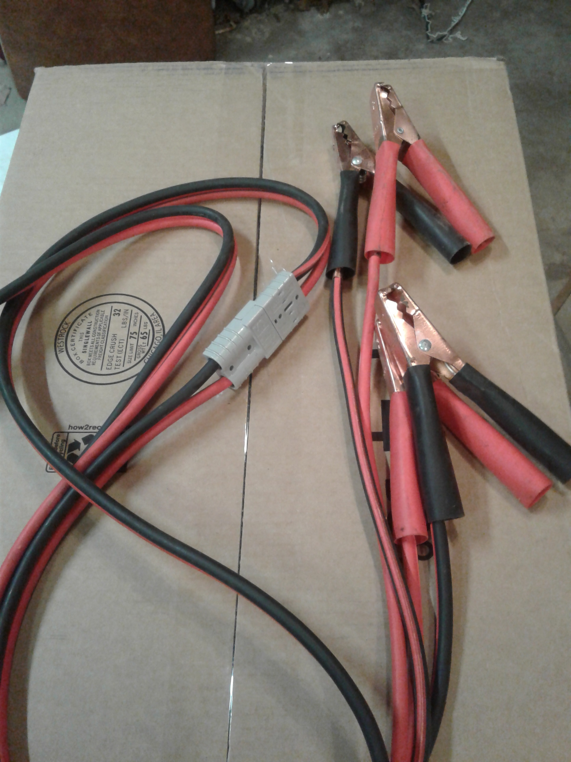

#3 power connectors. Farm store wanted $21 for a Superwinch power connector. Electric pallet jacks also use these connectors. At a local Hyster dealer I can buy 3 for $22. You don't have to be a rocket scientist on this one. They also sell rubber dust covers for the connectors.
#4 optional extra connectors for winch, jumper cables, future expansion needs (lights, radio ect).
#5 locate somewhere close to battery for master fuse block, small mounting hole will need to be drilled. Run wire through sprayer hose and route from battery to rear of tractor. Use cable ties to secure to factory wiring, hydraulic lines, frame, ect. The power connectors have 2 small mounting holes (#4 machine screws?). Use caution, don't drill into plastic fuel tank (thought about it on BX until I realized what the black plastic part was)

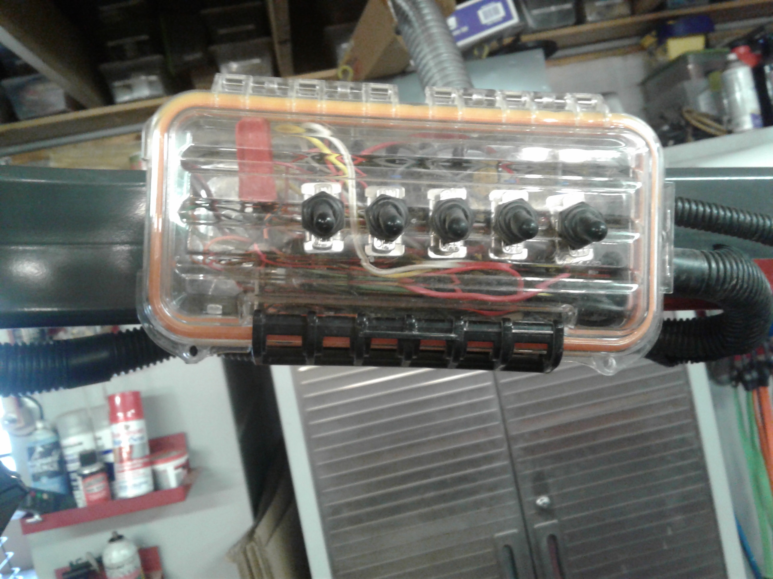

#6 Waterproof switch box, fuse panel, switches.
#6a electrical distribution panel - maybe hardest part to locate. I found a 10 circuit fuse panel at NAPA. Like trying to buy controlled drugs - none on display have to ask "parts dealer" for one.
#6b went to outdoor camping type store for waterproof box (typically larger selection)
#6c determine electrical needs - motors are easy - rated in amps.
lights rated in watts 3 amps * 12 volts = 36 watts
4 amps * 12 volts = 48 watts
5 amps * 12 volts = 60 watts
10 amps * 12 volts = 120 watts - buy swiches and wire that can handle load.
also consider total amps for all circuits - you will need a master feed wire for fuse panel.
#6d electrical department of farm store had waterproof switches and rubber switch covers and wire.
#7 assemble fuse box, I used 2 95# Harbor Freight magnets on rear of box, mounted fuse block inside.
water can not flow uphill, drill holes in bottom for wire access.
#8 adding lights - where to mount, how to mount - up to you - leave some extra wire under fuse panel for drip loop.

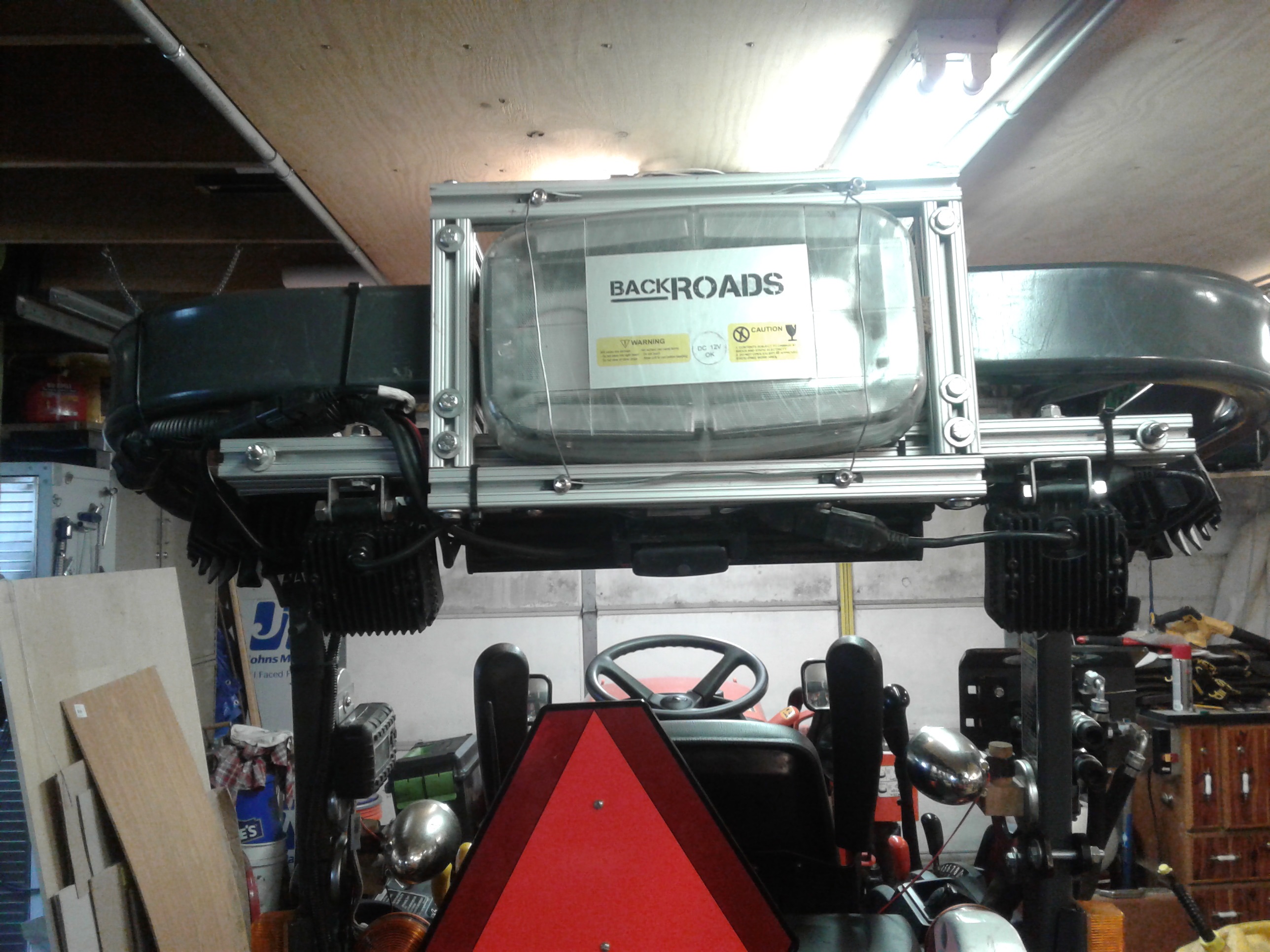

This is how I modded a B2650, did something similar on a BX2360. After buying the 10 circuit fuse block I did find 5 circuit units. Since I am only using 1/2 of it, I installed spare fuses on other side. The cable wire wrap makes mod look more professional. I my case using wire that can handle 10 amps makes light upgrades easy. replace lights, upgrade fuse.

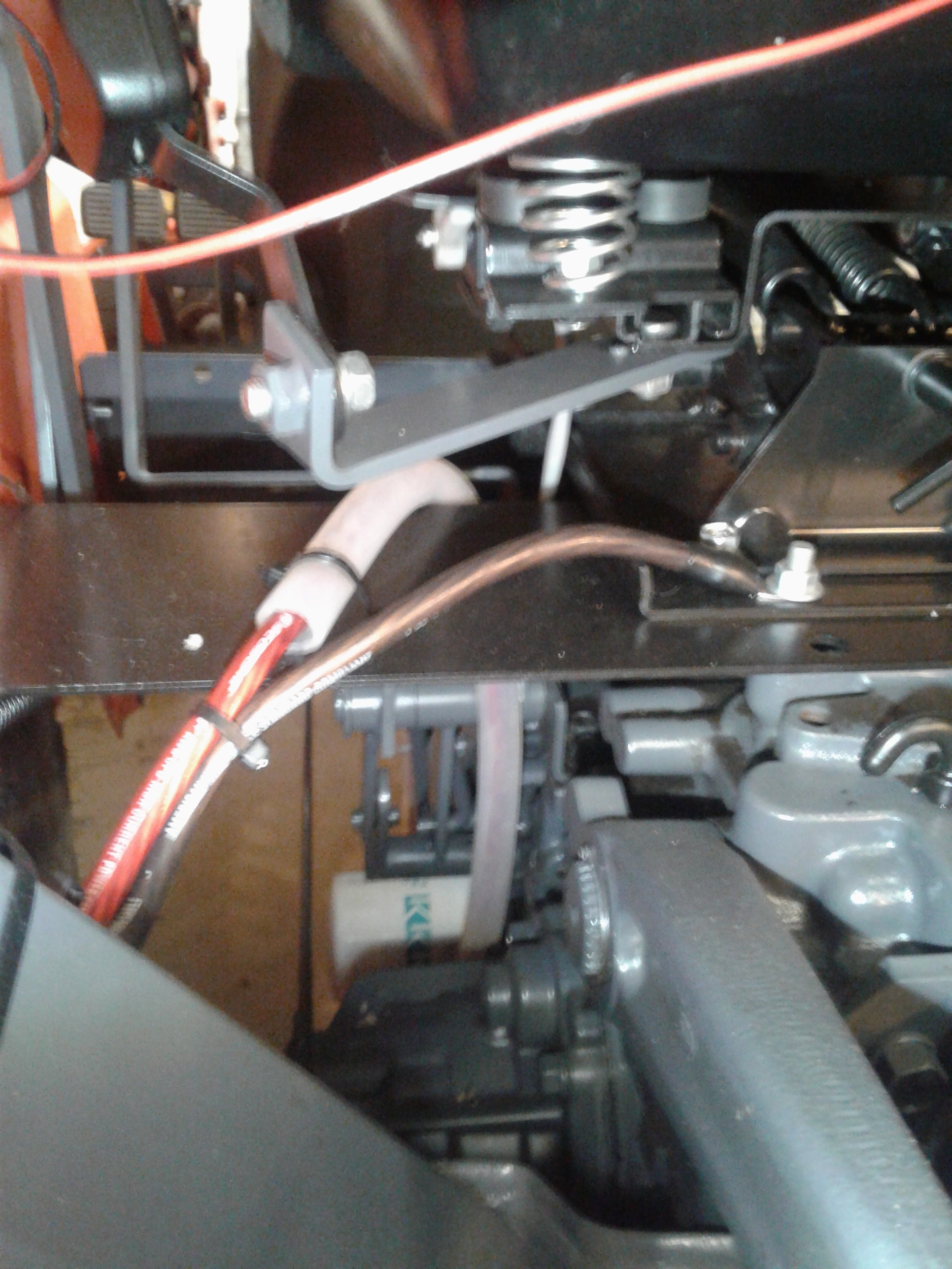

Here I've added photos of my added winch wiring to a BX2370. Steps 1,2,3 in my first post provides the raw materials for this mod. I ran the red power wire thru the sprayer tubing and routed tubing from engine area to top of 3pt assembly. I used scrap aluminum stock to make a rear bracket for the power connector and connected black wire to frame. The fuse for my mod is an inline fuse in front of the battery.

Charlie, this is power amplifier cable kit. Approx 4 gauge wire, came with 80A fuse (I de-rated it to 60A, winch has it's own 50A fuse) multi-strand cable very flexible. I ran it trough sprayer tubing for extra abrasion resistance.

The power connectors are what superwinch sells and cost around $20+ each. I recognized these as the same connector used on electric pallet jacks and purchased them from a Hyster dealership.
Since then I found these on Amazon and they are rated at 50A. The weak link in my mod. Larger connectors are available for those wanting to replicate my efforts.

Time to revive another thread. I'm planning on adding a fuse block to my tractor. Lately, with lights and now a third function going in, I'd like a clean location to bring all my fuses to. Can someone tell me the easiest way to tap into the "ignition"? For everything I'm adding, I do NOT want them operational unless the key is in the run position (IE: the tractor is running).
/ Adding electrical devices to tractor #18
Depending on how much power your added fuse block will be distributing you may NOT want to depend on ignition switch alone due to amperage rating of switch.... You might consider a relay (contacts) directly powered from battery through a fuse to power fuse block and just tap off any "on" position from ignition switch with key on to energize relay.....
I usually go to these places for any electrical devices as relays and fuse blocks and bulk wire and such.... Lot better selection than off the rack at FLAPS...
Waytek | 12V Electrical Components Distributor
Del City - Electrical Supplies & Professional Grade Wiring Products
Dale
/ Adding electrical devices to tractor #19
Let me see if I understand you correctly. I have a leftover BlueSea 6 slot fuse panel from my last boat. I can surely tie that directly to the battery. Are you stating, any wire I run thereafter, be tied into an ignition power source? Sorry for my ignorance, but where does the relay come in?
#20
Battery --> Master fuse --> Relay --> Fuse block. Every circuit added to fuse block will only work when relay is engaged - if using 6 10A fuses a 60A or larger relay needed
NOTE: if you use more amps than charger makes, you'll run down the battery. Relay should come with wiring diagram.
add a circuit fuse - Bing can be used to power relay coil
