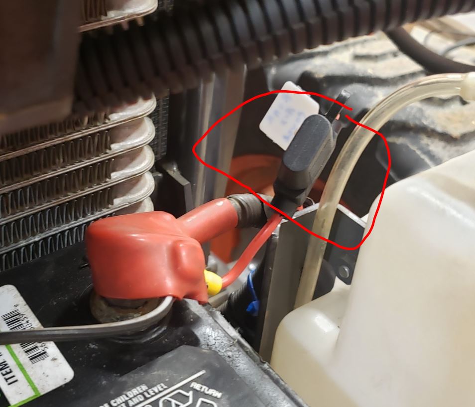

LittleBill, I started this thread, if you look at the photo in post 1 the bright red wires and the fuse block came from walmart. It was a wiring kit for an 1800 watt power amp, replaced 80a fuse with 60a. Speaker wires saved for future projects. Relay can also be in battery compartment. The fuse block in photo is factory block (B2650).
Everything I added is attached to ROPS. This is why I used a waterproof box (camping store or department) to mount a remote fuse block and switches. Easy access to fuses and minimizes wire runs to accessories.

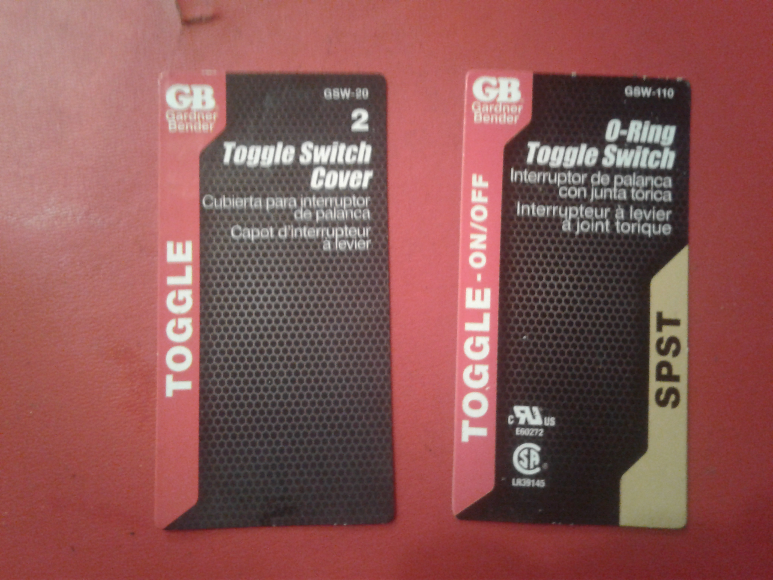

Switches are 20A motor rated with o-ring moisture and dust resistant. Added rubber dust covers hopefully to increase reliability.

Is switch DC or AC rated? There is difference you know....

20A at 120v, 10A at 240v running at 12v shouldn't be a problem

although you prolly won't have a issue, dc creates a bigger arc on connection or break, generally if a switch is dual rated, dc is usually half of the ac rating. you may experience a shorter service life with a ac only rated switch/relay
