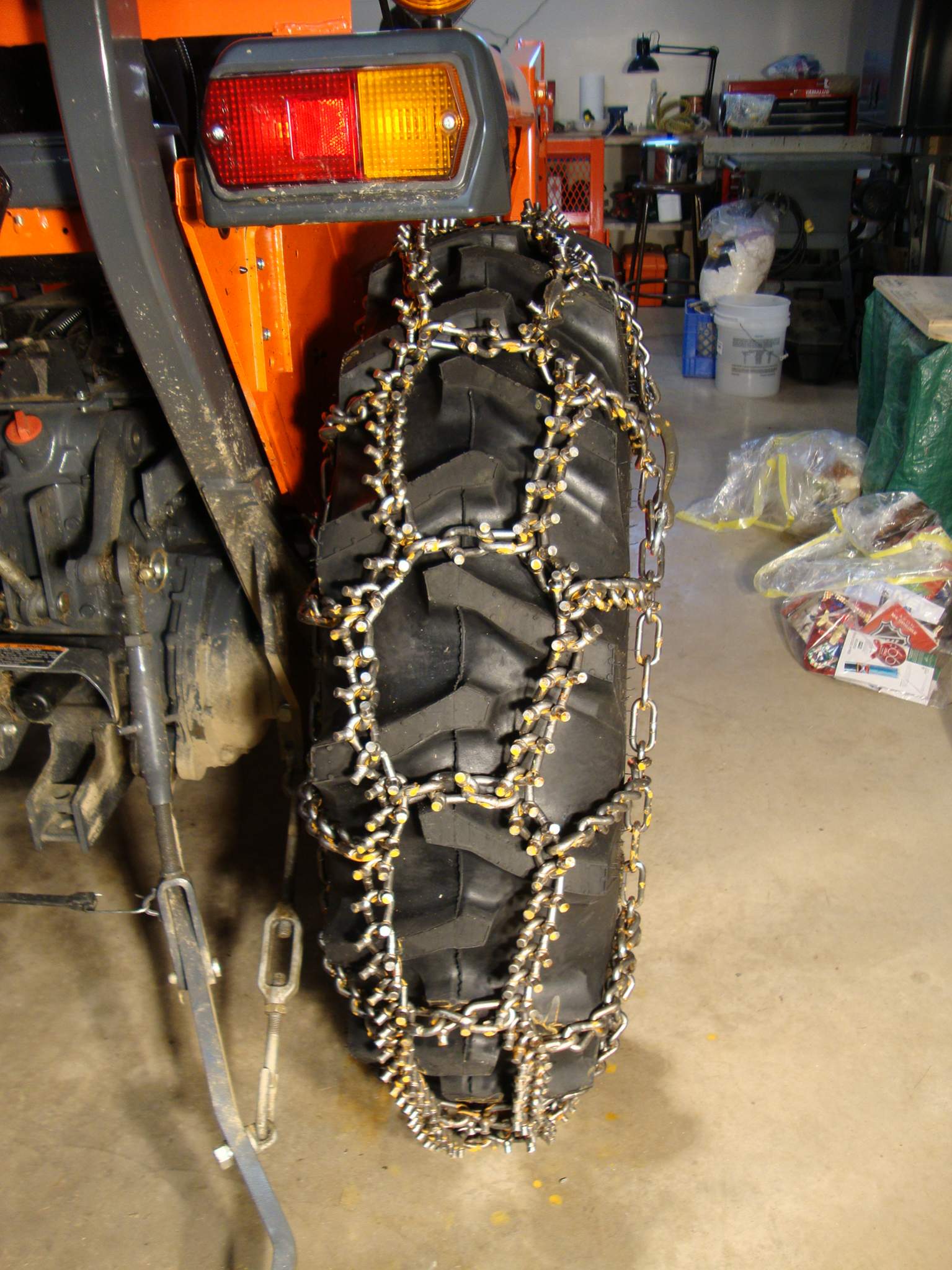

/ Adding extra chain to tire chains #7
While it would be a lot of work and time, creating an H pattern chain will definitely help with smooth ride. There's really no difference in mine between bare rubber and running with the chains on pavement other than the jingle of the chains. Plus, the grip is excellent.

/ Adding extra chain to tire chains #8
Sean
Oh I agree.
Mine were originally that H pattern and the traction and ride great.
Problem was that the H grid was assembled using S hooks to join up the corners.
All to often the S would open up and I was left with that tangled mess.
With turfs I have lots of choice.
Unfortunately industrial and ag tires there is not much choice.
