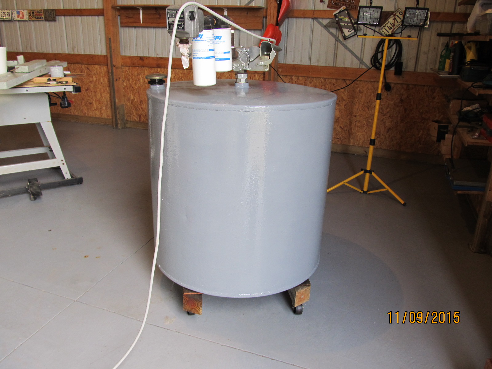

Here's my dual fuel filter setup. Hose is off because I just painted the tank. It's a 12V pump, a waterblock plus a regular filter and all is good. The waterblock alone is likely enough but I already had the parts. It works for me.

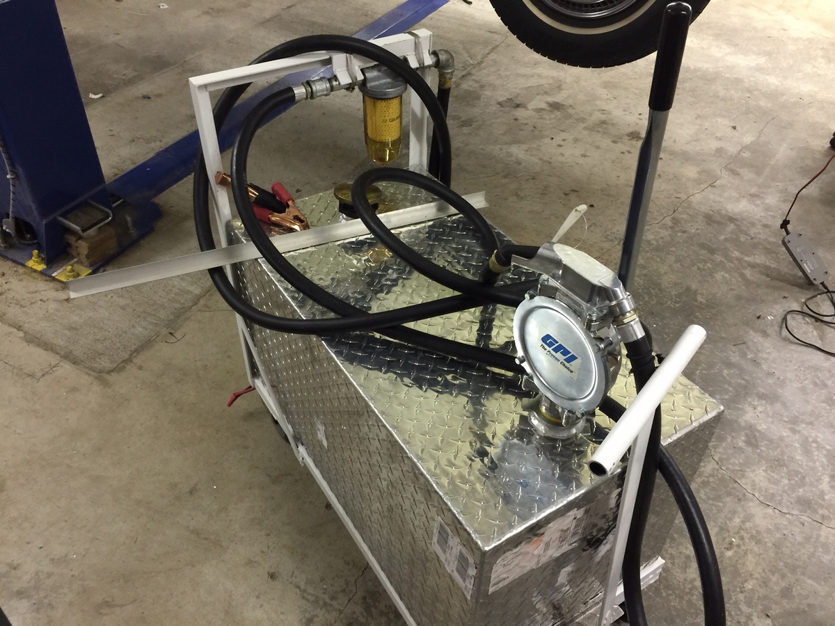

The attached is for non-ethanol gasoline for vintage cars and motorcycles that I just completed welding this week, but obviously would work for diesel. This uses only a single filter.
Scored a 'used' aluminum 50-gallon gasoline rated tank off of Amazon. I had never seen a used item on Amazon before; I'm sure someone didn't like that it was shipped unpackaged with just stickers on it, and returned it. Given I used rubber wheels, I included a static discharge strap and use the jumper cable to connect it to my truck metal when filling. I punched marks on the aluminum angle to make a dipstick for measuring.
I installed the Goldenrod 496 water-block filter which uses a higher micron (17 micron) rating than the non-water block version (10 micron). The filter housings are available in either is 3/4" or 1" NPT fittings. I don't like the inevitable tugging on hoses applying torque to the pump, so mounted it to the frame.
Someone on the forum recommended this company- Circle C Country Supply. They had the water block filter for $35, which was cheaper than Amazon at that time. Free shipping if over $50 order, and no business presence in my state, so did not charge sales tax. Consider ordering a spare filter element at the same time, as well as a filter wrench to get over the $50 limit if needed. And no, I do not get a kickback, but one would be much appreciated.
Goldenrod 496 Water-Block Fuel Filter 5662
