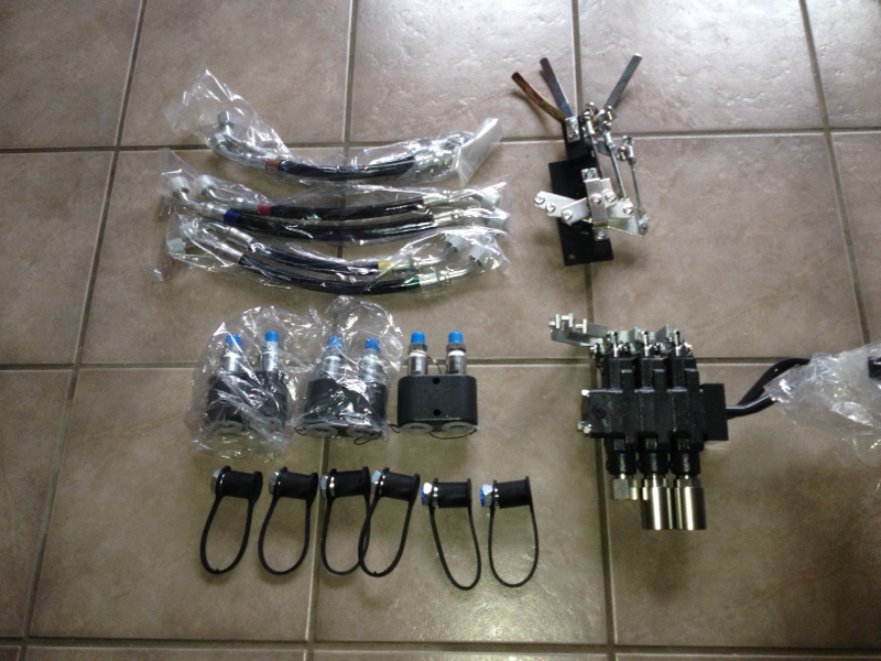

L8308 for the double acting valve and L8309 for the floaters. I've got 2 float and 1 DA.
L8348 for the 3rd lever.
Here is a pic of all 3 valves assembled along with the triple lever assembly.

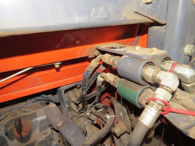

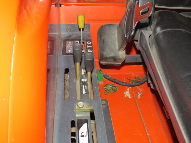

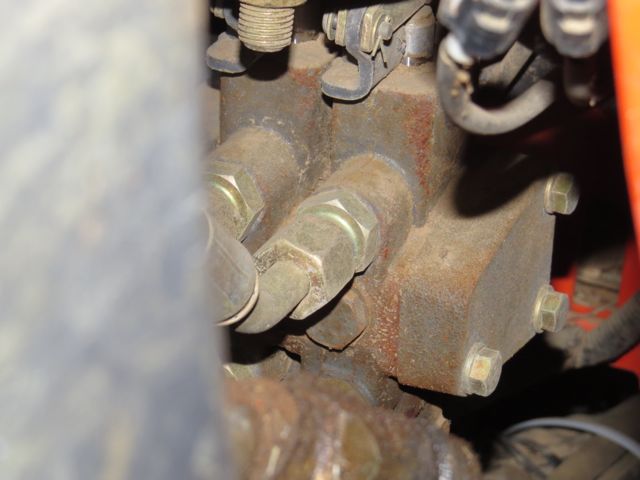

These pics are on a Kubota L5030HST
The first picture shows an open slot for my third rear remote below the PTO to the left of the two levers.
The second picture is the two remote valves below and connected to the levers.
The third picture is the rear hydraulic connections. They are attached by a short hydraulic hose.
