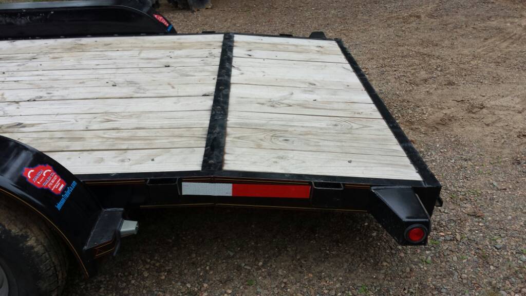

Yeah, that looks like way too new and nice of a trailer to be adding on to. Even if you were a pro with all of the equipment in the world at your disposal it will still likely be obvious that you hacked it up and put it back together. Since it is newer and in nice shape, what I'd do first is get a price from a local dealer to trade for what you want - Not saying you should do that, but at least see what the difference is, and then start subtracting out the materials you need to buy to re-do yours. You may find that it's just not worth it to start cutting and welding. I'm pretty well equipped and capable, and I wouldn't cut into a nice trailer like that. My 20 year old homemade one - well, that's another story.

While I tend to agree it would be best to sell it and buy another one a competent welder could extend the trailer and move the axles in a couple days. Do you have more money or more time? I moved axles on one of my trailers and relocated the fenders. It would be hard to tell it is not factory it turned out nice. Extending it wouldn't be super hard either I would just cut it right where the dovetail starts, add a straight section, and reattach the dove. Certainly doable but when you figure in your time and the materials it would probably be better to trade. I like welding projects though and often tend to do crap like this even though it doesn't make a ton of sense when you sit down and analyze it.

I am the competent welder! I just looked underneath it........... piece of cake!

I would not hack up a great looking trailer like that. De-values it in my opinion. I have had owner modified trailers in the past - NEVER EVER again. I think others would feel the same. Good luck and keep us posted.

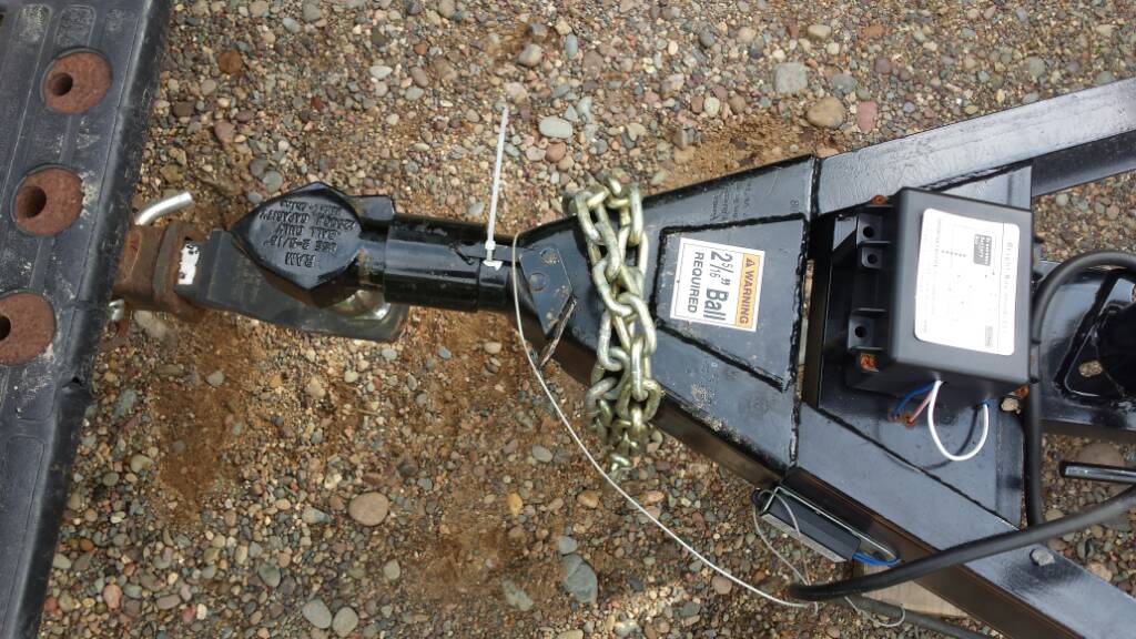

One reason I drive about 2 hours out there is because of the coupler when it's on the ball it's tight I never seen one like it before.
/ Adding onto a trailer lenth #32
Its a round tongue coupler. Has a sliding collar to lock it. I usually see them on horse trailers. I think they are rated up to 12,500 lbs. Don't usually see them on equipment / utility trailers.
