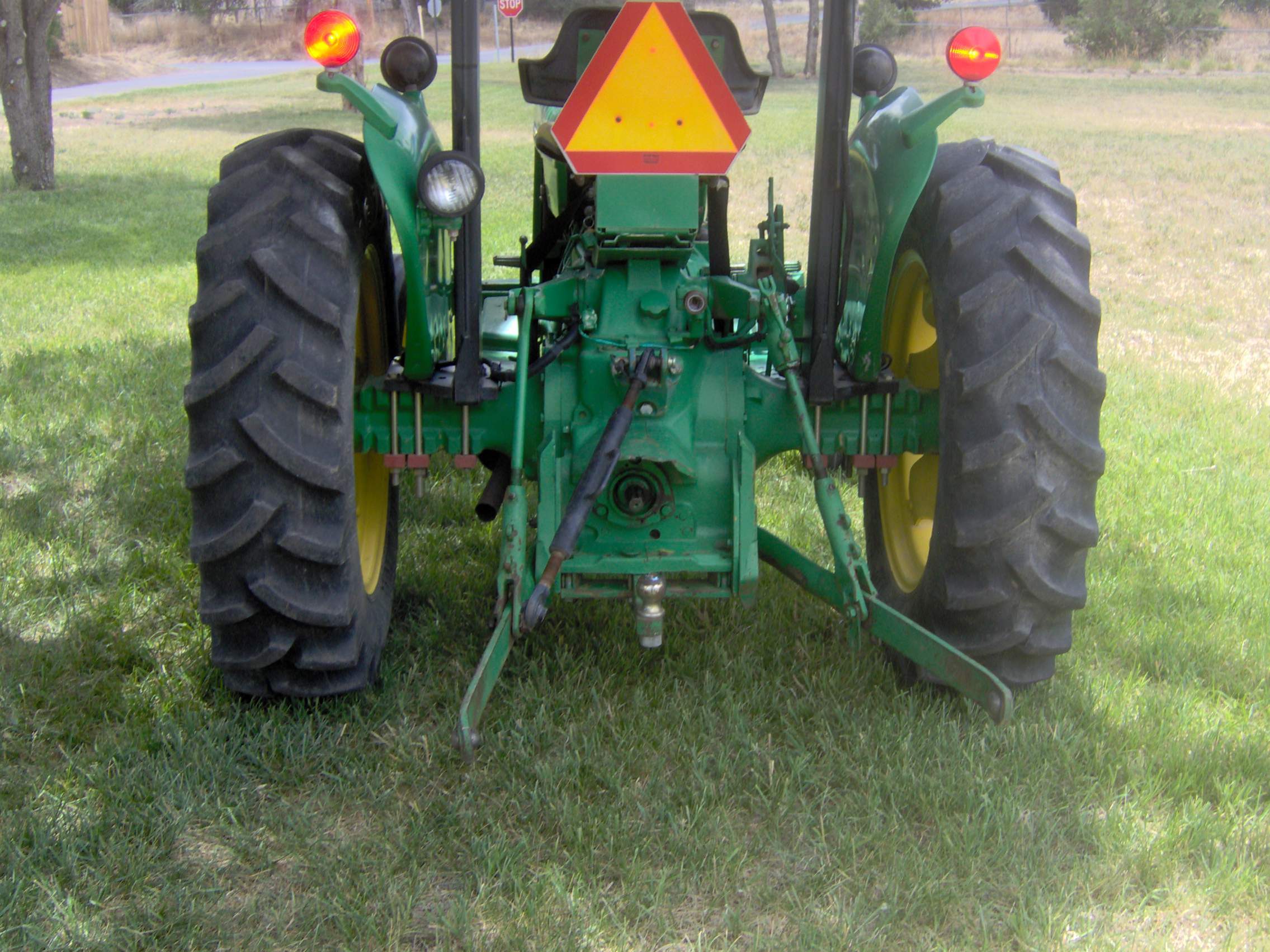

I added a canopy and rops to my Deere 820, makes me feel a little safer. The shade is a real plus too.

I ordered this through the dealer. The canopy is a newer style with insulated roof and hazard lights. The rops is a folding model.
