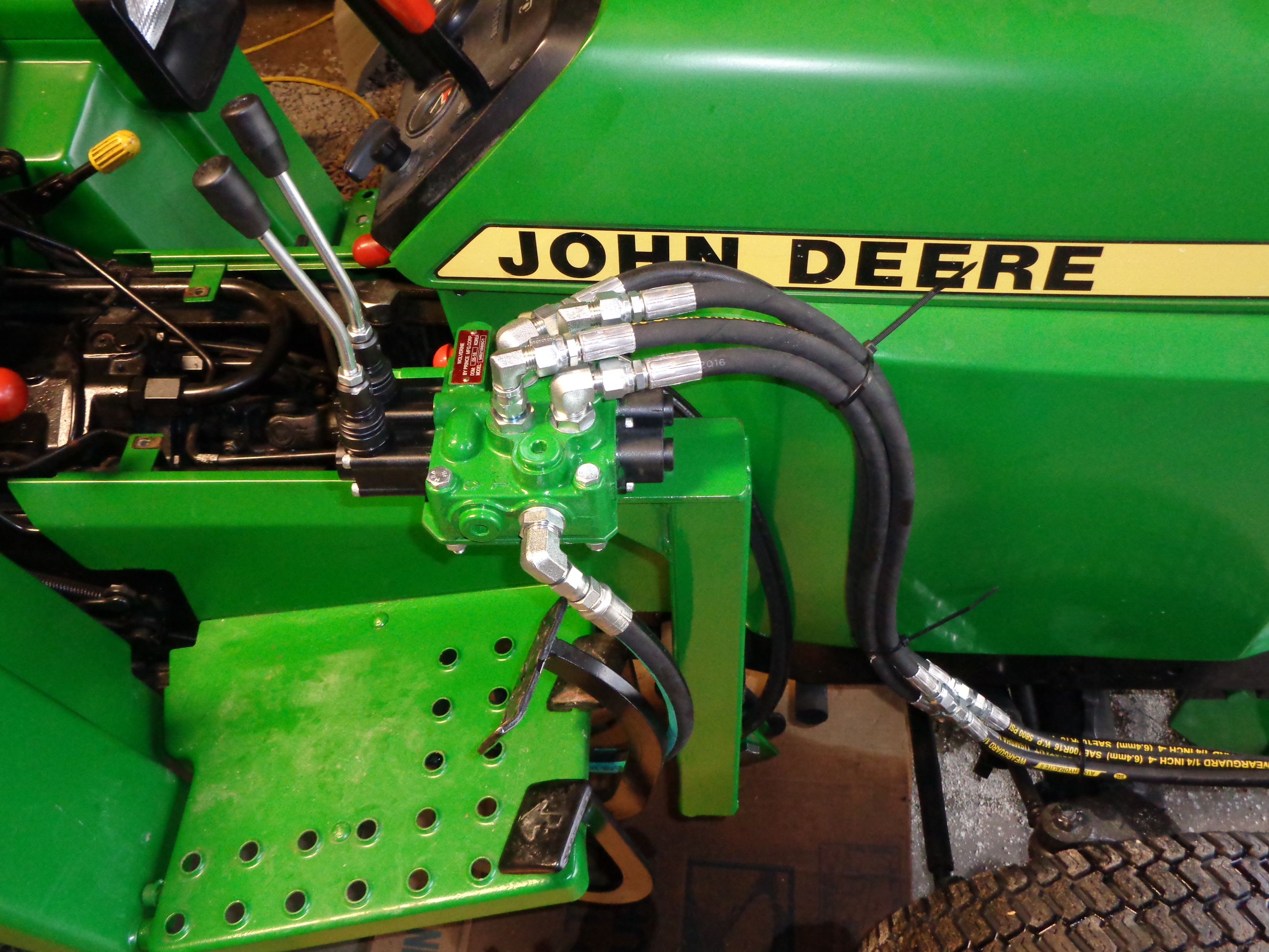

I had a very similar problem with my 655. I built a front blade and needed to add a hydraulic valve to control it. My tractor didnt come with the dual selective control valve so I added an aftermarket one that has power beyond capability. The tractor comes standard with a flow divider to power the steering and rockshaft functions. I removed the factory metal line from the pump and had a new hose made to feed the new valve first and then another line to power up the factory flow divider from the power beyond port thus powering up the whole system. Here is a valve that would work 2 SPOOL COMPACT 1 GPM JOYSTICK CONTROL VALVE | Directional Control Valves | Hydraulic Valves | Hydraulics | www.surpluscenter.com Hope this helps

Here is a few pics of the valve and hoses on the 655

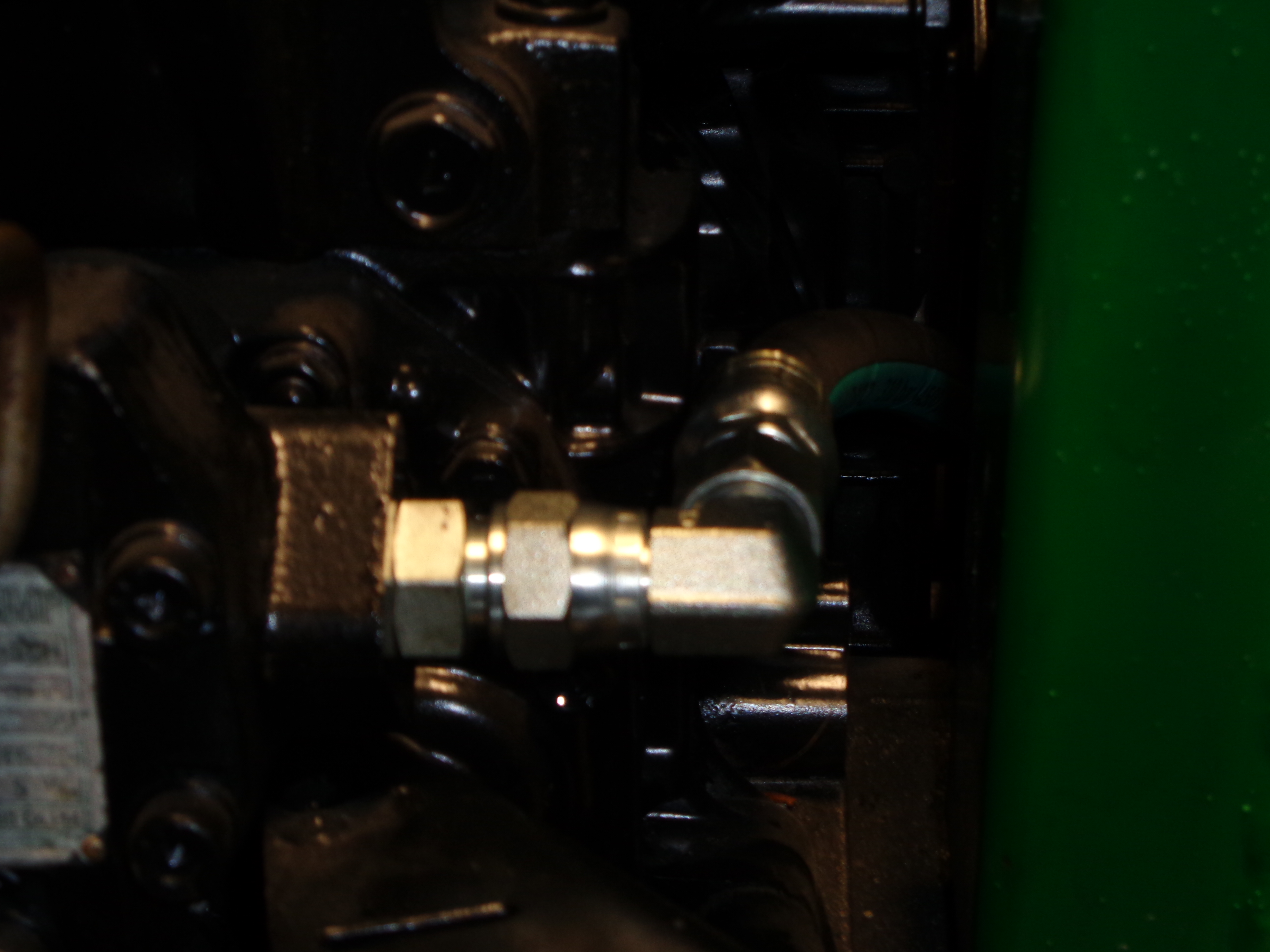

I received my Cross joystick loader valve from Surplus center. It is nothing like the stock JD SCV so I have to make a bracket to fit. If anyone has added an aftermarket valve to a 650 or 750 I would be interested in how you mounted it. I also have to plumb it. The controls ports are all SAE 8. I have the service manual that shows where all the hoses connect to the tractor, and it says a plug must be installed in the auxiliary outlet port of the rockshaft piston cover. Does anyone have the part # of this plug? Also, if anyone has a 650 or 750 tractor without power steering I would be interested in how the hydraulic lines are run and what type of fittings and size of hoses are used. I did get the plow and cutting edge sanded and painted while waiting for the control valve. Next pic I'll keep my big, fat finger out of the way!
