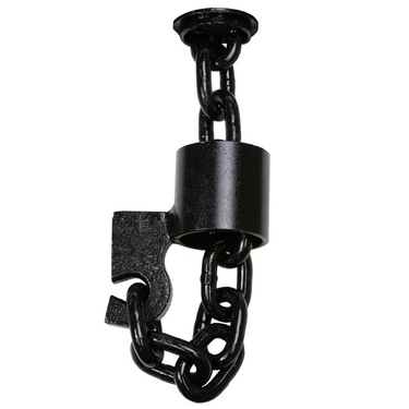

Lots of people don't know about these. Weld to the inside of the trailer frame.
Trailer Bed Chain Tie Down, 6600 lbs. #1901006
Floor Chain Tiedown - Grade 70 chain - Load Binder Chains
Floor Chain Tie-Down - G70

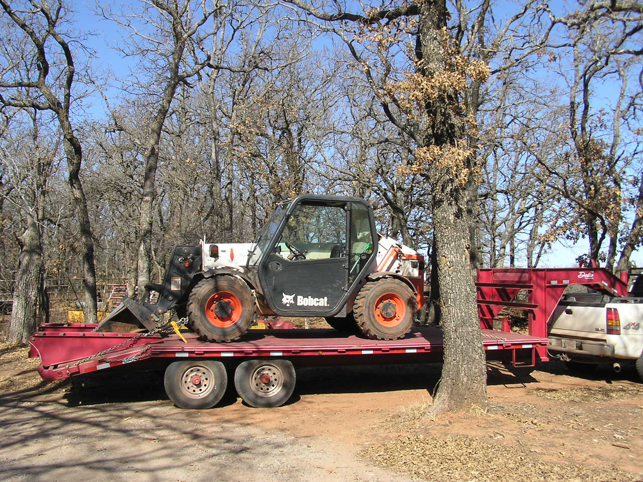

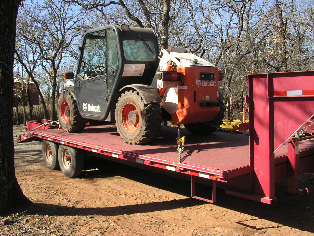

Our trailer has 4 loops (made from round rod) that are welded to the lower rail (the one that the wood floor sits on) that we fasten to. Works very well for us.
