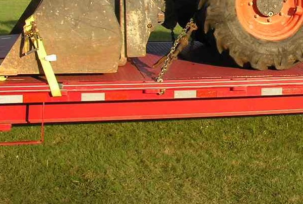

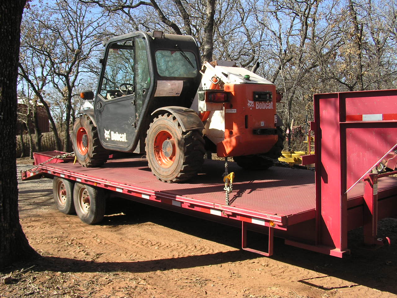

my smaller 5x10 trailer had those metal loops on the sides in a couple of places, but this 16' dble axle has nothing. it does have stake pockets, but I didn't think they'd be very strong anchor point... think i'll try those Chain Tie-Down items listed above, bcp; I use this to move my 2305 and/or Ranger sxs for service, mostly, so it'll be infrequent, but I wanted to be safe. the bed tie downs mentioned in hslogger's post was what I thought I'd do, they have a 5,000 lb rating. rethinking the plan. thanks for the input!
The stake pockets are a good anchor point.
Drop the hook in and bring it up and hook it on the top edge. That way it won't fall off if it gets loose.
   / Adding tie-down rings #14
The rings I used had one grade 8 bolt thru wood and steel while the other was just thru wood. I don't see a problem at all.
