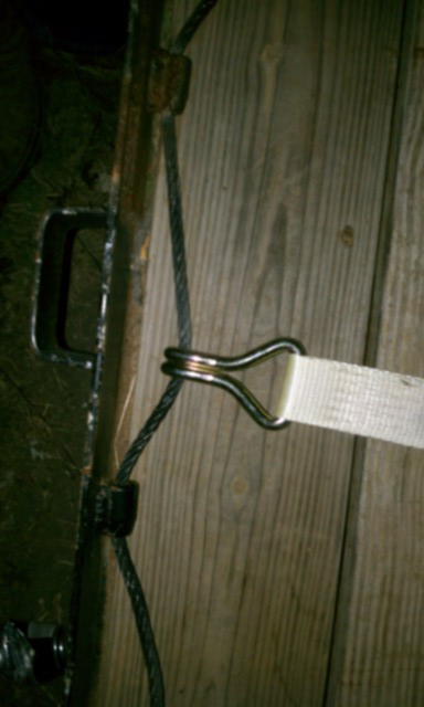

On one of my trailers I welded D rings in the area where the fenders are, then welded stake pockets and flatbar from the front of the fenders to front of trailer, same from rear of fenders to back of trailer...basically a tie down rail like you see on G/N and big truck flatbeds. if you go that route be sure to use 3/8"x3" flatbar, will not flex easy when using 2" ratchet straps and tightening down hard.
On my other trailer I came with the system I really like, I use 1/2" wire rope approx 22' long for my 20' trailer. I pressed a button every 12" on the cable, then I started at the front of the trailer on inside of frame, welded button.Then I used a piece of pipe laid under the cable and welded second button..giving enough slack in the cable to hook my tie down strap or chain to. I have a tie-down point every foot, the tie down point is flexible/durable enough to set a load ion if you have too, but rarely does that happen as the cable sticks out only a few inches from each side. For vehicle or heavy equipment I use the stake pockets I welded to the outside of the frame, but for ATV's and small stuff the cable works great. Have had that setup for several years now.
Here is a pic

Thanks guys! Lotta good ideas. Yeah, my son is a welder so I can get that done cheaply. :cool: And, I'd forgotten but I've seen the US Cargo Control website before and told myself I'd remember it but I didn't. I probably will go with the welded ones but that cable idea is very slick too!
