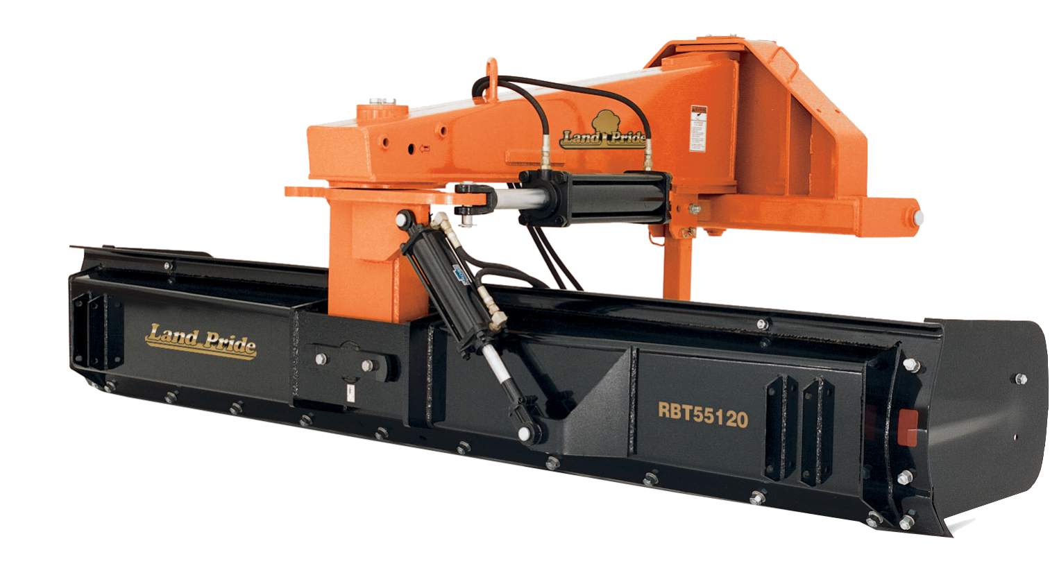

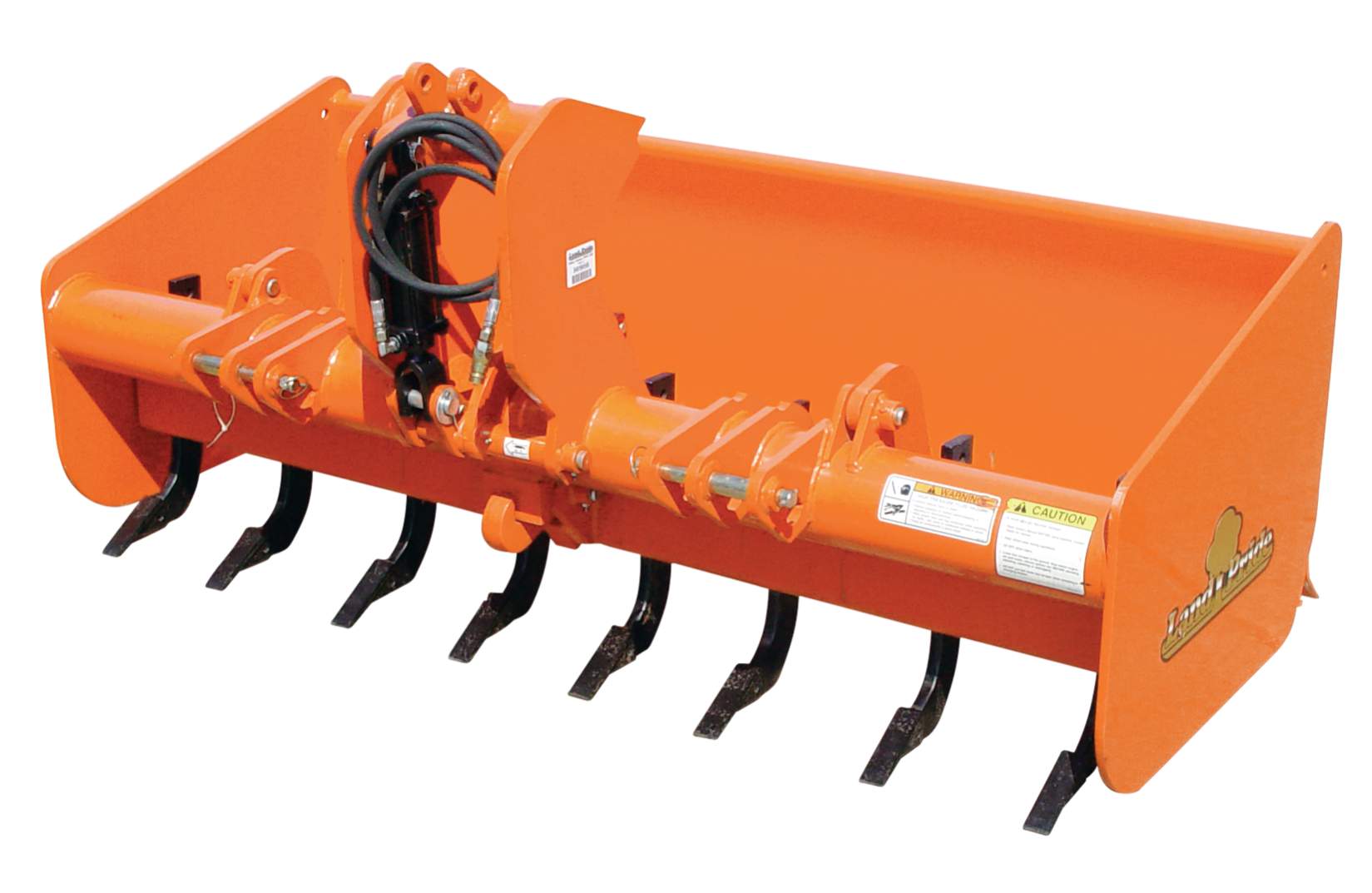

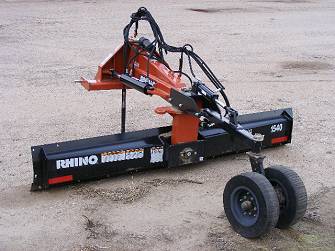

Here is one reason for three remotes, .
And 4 remotes.
