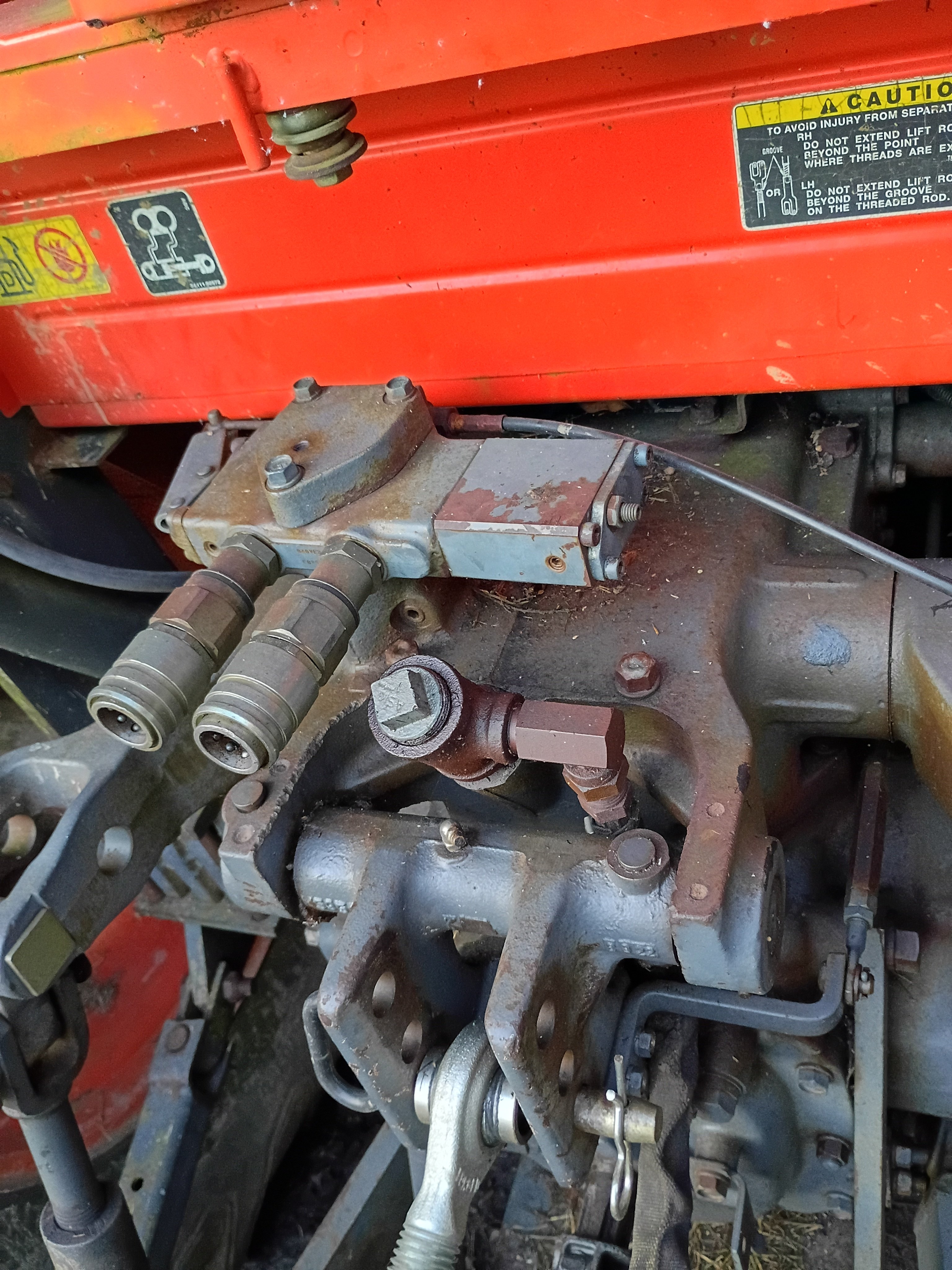

I'm trying to id the PB port on my m8200. Attached is a pic of the controller which I'm hoping to replace with a Summit valve b/c the bucket acts like a tilt a whirl ride. None of the ports on existing valve are labeled.
The side ports go to a block near the pump which has rigid lines running to the 3Pt controller. The open center port has a flex line running to the tank.
I have searched everywhere for Hyd info on the tractor. I think the joy stick valve is a Nimco.
thank-you

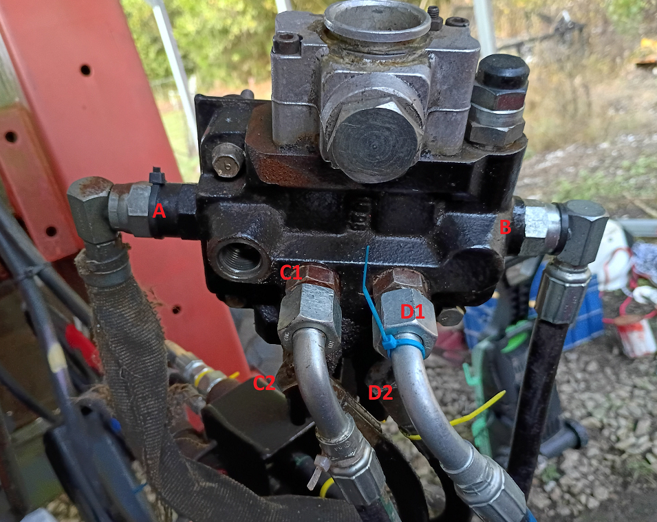

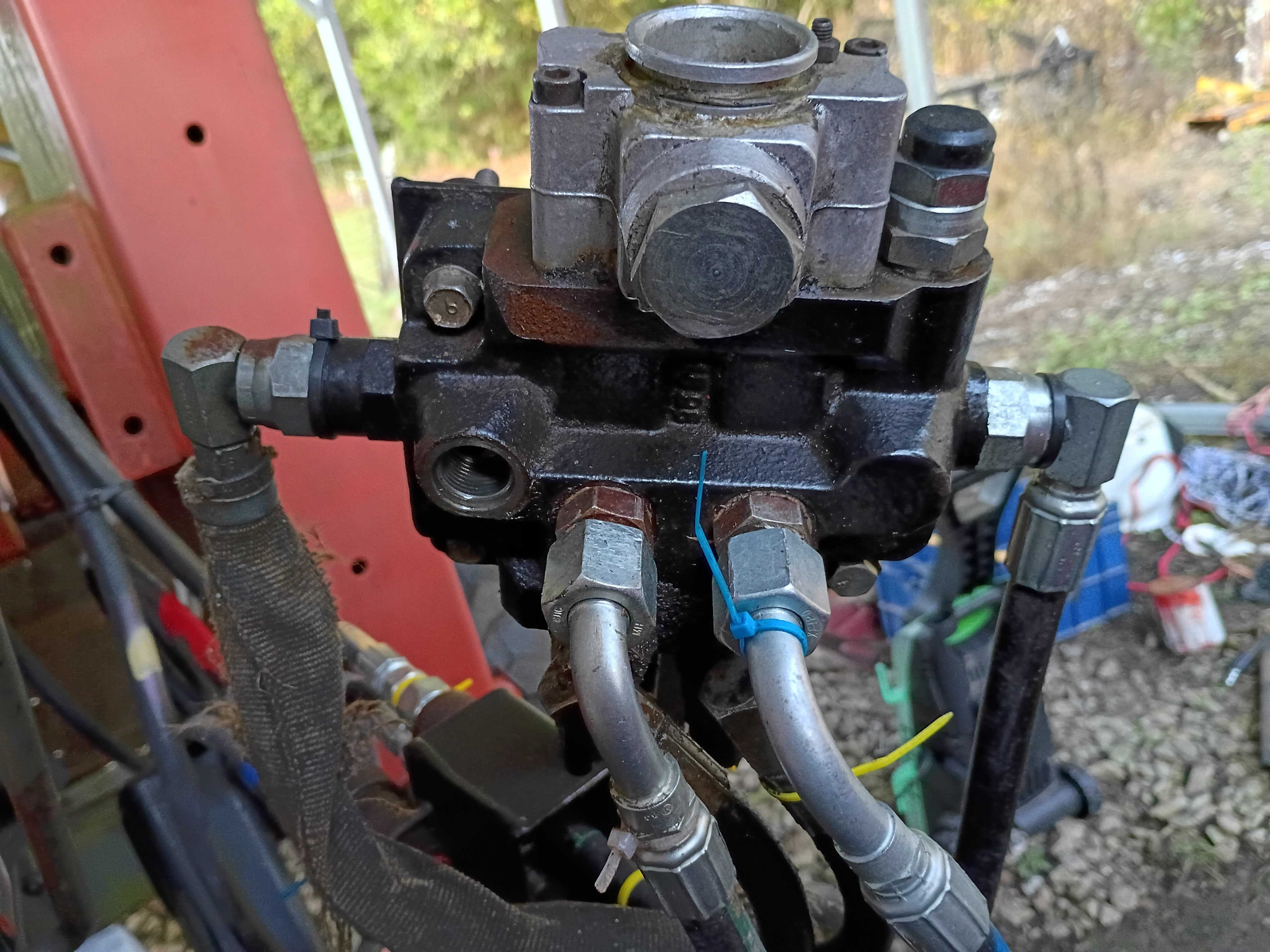

@yardbota How many lines are going into the valve?
If it has power beyond then it should have 7 lines.
*The flex line going to the tank is the drain is A or B. (guessing its A since both have a sleeve on them)
*The line with the blue zip tie D1 and the line with the yellow zip tie D2 are for the same function.
*The line with the clear zip tie C1 and the one below it C2 are for the same function.
So there should be one or two lines left. Can you take photos of them?

I was trying to determine if yardbota had power beyond. If there are 7 lines then it has power beyond, if only 6 then there is no power beyond. This would help him ID what type of valve he needed from Summit. If I am out of line, or posting bad information please let me know.
/ Power Beyond on m8200 #8
