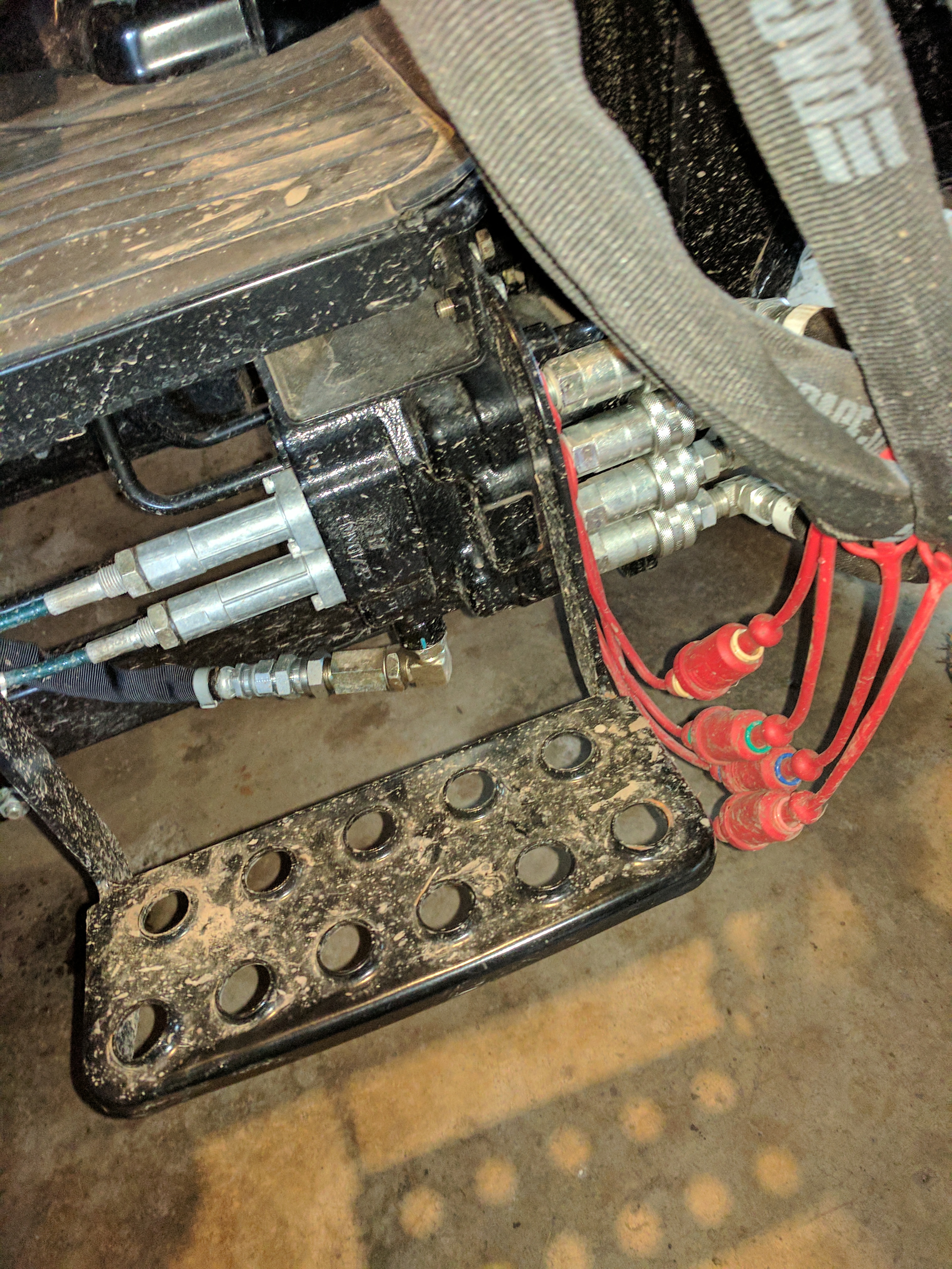

Been tied up so havent been able to get a pic until now.
First off , is this the valve with all the lines going into it?
   / Adjusting hydraulic pressure relief valves on TYM 454 or other. #25
Yes that's the valve, set screw is on back as your looking towards the bucket.. it's an Allen with a lock nut, I moved mine most of the way in(the pressure maxed out before the limit anyways) and it made a huge difference.. I tried to lift something that I estimate to be 400 lbs and it wouldn't pick it up all the way.. after adjusting screw it lifted a cat3208 engine that's supposed to be 1500 lbs.. so huge difference

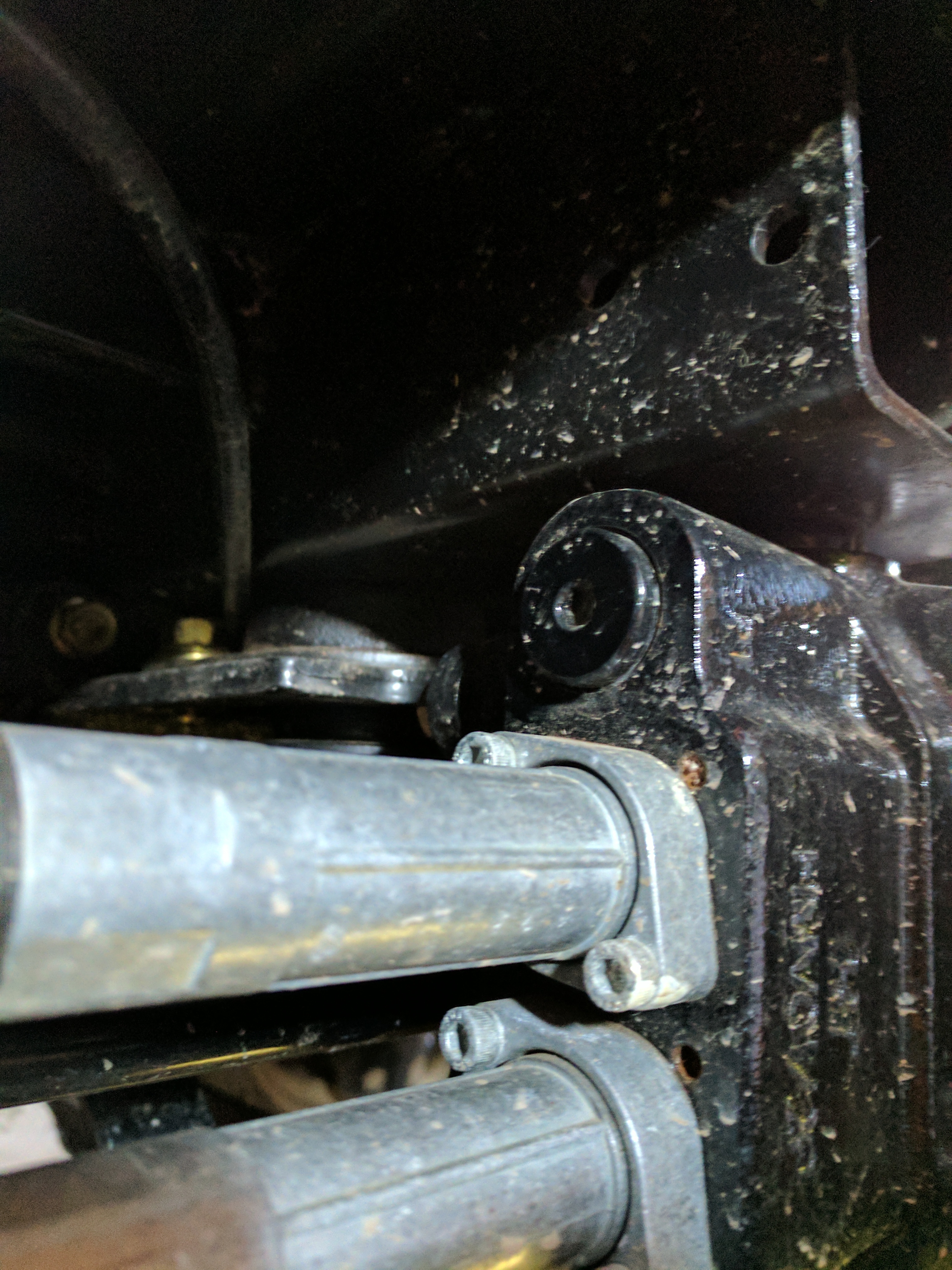

Hmm, this is the only allen on the back of the valve, it is directly above the 2 silver cable inputs.
   / Adjusting hydraulic pressure relief valves on TYM 454 or other. #29
No, that's a plug on the extra port.. its behind those cables
What year is your tractor? Mine is a 2015, also it came with a back hoe.. I didn't get the back hoe but it was plumbed for the hydraulics for it. Possible that the valve is different because of those two variables?

my loader valve looks just like that even though mine is a lm45. I will look at mine again today but jim is right. It was hard to get to. could only move the allen wrench a little at the time.
