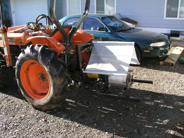

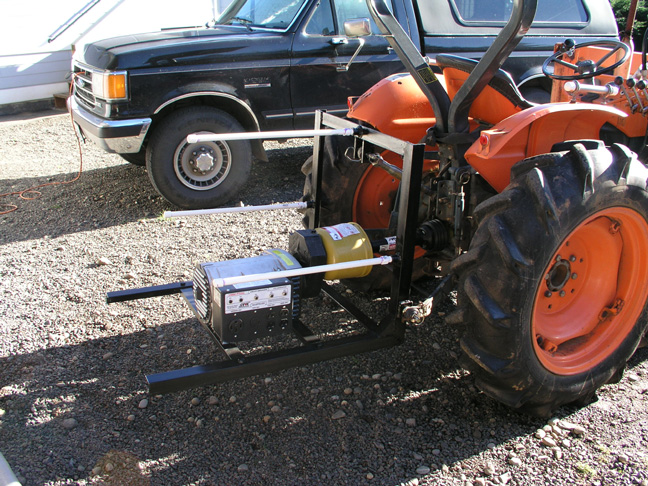

I recently got my Northern 12,000 watt generator hooked up and running using my L245Dt Kubota has a power source. It may be just a little underpowered to get the maximum wattage from it, however I doubt if I'll ever need all 12,000 watts. The one problem I've noticed is that when I am running it with, say a 5,000 watt load (heater)+ an additional 1,000 watts (lighting), and adjust the RPM to maintain 240/120 volts, when I switch off the heater the voltage will climb to upwards of 270/135 volts. Knowing that this could damage some electrical systems, I wanted to know if anyone else out there has experienced a similiar problem? Does yor tractor's governor self-adjust to make up for the differences, or am I expecting too much from my antique? Any advice as to what to watch out for? Thanks, Doug

I believe it is because your generator doesn't have a voltage regulator- not so much your tractor. As a general rule, most appliances can handle +/- 10% voltage. You do seem to be slightly higher.
My 5500 watt Coleman generator produces almost the exact same (high) voltage when not under load (also does not have AVR).

You might want to get a frequency meter. Set it at about 62 Hz with no load and see what it drops to. 58 Hz is about right for a bottom end. Your voltages don't sound real bad, but if you get the frequency to far out of line then you can also damage stuff. A lot of equipment has gotten damaged from frequency shifts. If you can monitor it in your house then that goes a long way to protect your appliances. Radio Shack and others sell a "Kilowatt" meter that measures frequency and voltage among other things. Try them out.

What your experiencing is typical and should be expected, You have to do what Bob said, with no load, (nothing drawing power) set the rpm's to the upper acceptable limit on your gennys meter, whether it' a HZ or volt meter.
Then when a med to large load is turned on the meter will drop, but hopefully stay within the lower acceptable limit, if not or a very large load is drawn then manual throttle input will be required.

The short answer is no, with a pto genny that is closely matched to tractors pto HP output the gov will not keep volts/hz within tolerance thru out the full range of gennys out put.

JB Thanks for directing me to that #49 post. I'm probably facing the same thing you were with your Ford. My tractor puts out 22 PTO HP, so I know I'm pushing the limits with the setup I have. An interesting side note is that I also have a Coleman 12 KW generator powered by a 24 HP Briggs Vanguard engine. It has exactly the same generator head as the Northern model. However it will easily adjust to the different loads. But does it burn through the fuel. The reason I'm trying to use both generators is that one will be used for powering a house/garage, while the other would be used for powering a shop which also powers my well. I suppose this means I need to go out and get a new tractor! Now to convince the wife!

Yeah I agree, that 12 kw genny is not the problem, as long as you know you can't get the full 12 kw out of it with only 22 hp pto input, using the accepted 2 HP per KW formula. Most agree that the larger/heavier spinning rotor helps maintain output thru the fly wheel effect, I wish I got the 12 myself.
Our tractors would really shine with these PTO setups even at or near their max rated output, Only if it was a constant load with out those wide fluctuations in demand, unfortunately that's not real world use and if you're gonna have loads equal to 50% or more of the max rated output coming on and off then you're going to have to watch things closely and probably have to do some power plant management.
Some day, maybe not to far off in the future, our tractors will have some type of PCM function to keep a rock steady PTO speed, that could allow you to truly just set it and forget it.
As far as the portable Coleman goes I guess the simple answer is, that engine and gov system has only 1 job to do and is engineered for just that, unlike the tractor's unlimited possible applications where any one can not take precedence over all the others, basically a trade off.
