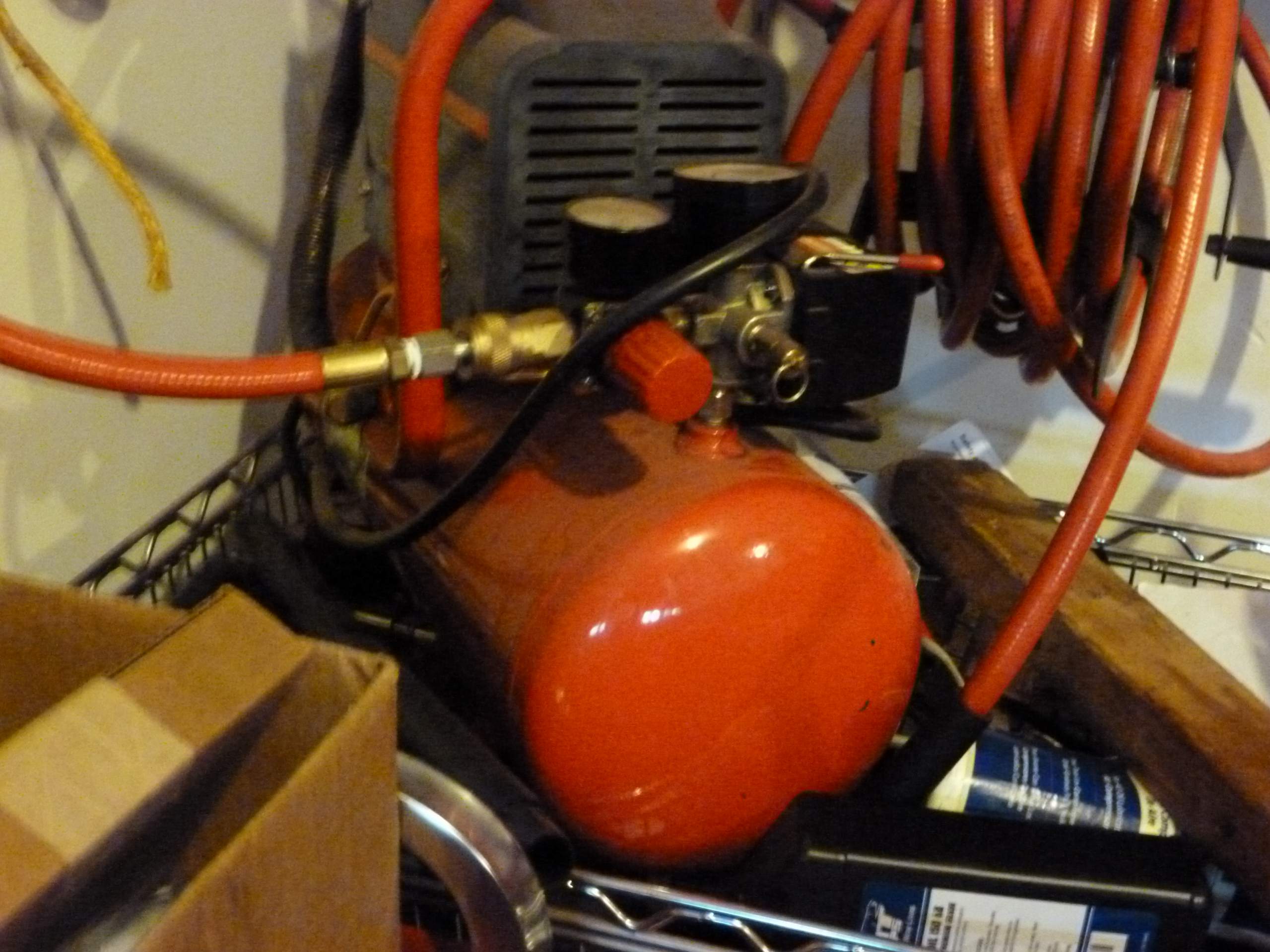

I currently have a small Craftsman 1hp 125psi 3 gallon 15 amp 2.4scfm@90psi air compressor I bought a few years back to upgrade from the typical Air Station tire filling pump. It's oil lubricated and seems to work ok, but puts up a terrible racket when running. Almost too much to take inside a residential garage. But it appears pretty well made, like a Campbell Hausfield rebadge. But it clearly is not enough to run air tools, though I did get it to run a small air ratchet.
I'd like to "move up" to a larger unit, that could run a 1/2-3/4 impact gun, and be able to handle "light" farm work. I'm thinking of an impact gun in the 600 pound torque range, mostly for taking off blades and other odd jobs. But a main priority to me is finding a machine that runs quietly, or more quietly perhaps than average. I saw a nice IR impact gun rated at 600 torque and 82db. Most of the other guns seems to make more than 90db, and I'm sure my compressor is louder than that.
I don't need a large commercial unit., and at the moment don't have room for it. Is there a compact unit that will give me enough air, not make a lot of noise and hold up? I'd like to know what works for all of you, and what specs I should be looking for. I have a 350 pound torque electric Dewalt gun that works fine on my lawn mowers, but I'd like to start a complete air system. How much cfm should I look for? I was thinking in the 8-10 range, but would like your opinions. Likely to stay out of Harbor Freight on this one, the stuff I buy "for life" I'd like not to be Chinese... And I'm wondering if I really need to think about building a sound enclosure for the compressor instead of paying three times more for a quieter unit. Loud noises bother my ears and I don't want to have to wear ear protection while using air tools, if possible.
thanks Drew

thanks for all the advice. I've been studying the air tools and it seems that most are in the 5-6cfm range, but a few like sanders and paint guns are in the 10cfm range, so
I'm going to aim for 12cfm or close to it. And while I thought I'd like to stick with a 110V unit, they don't produce the power needed. Which brings me to my biggest concern. Hidden in a few
tool specs are the terms "average consumption". One said 5cfm average but a whopping 12 cfm at full load. So I wonder if the specs usually given are just "average". So does one's 600 pound torque impact
wrench only put out 400 trying to get a frozen bolt off? Seems to suggest that going a little larger here makes the most sense, which means at least a 3.5hp motor, and likely a 5. So I'm looking in the range of 3.5hp with a 60 gallon tank to 5hp with a 80 gallon.
I like the Quincy line, all US made, though I wonder if their least expensive stuff still is, since they have a factory in China now, which may only be for local consumption there. Quincy and a few others make super expensive air compressors for hospitals and industrial use, so I think any company that knows how to build very high quality equipment must have some trickle down high standards they apply to their lesser spec equipment, assuming they just don't offshore production. And then, I'm sure, there are good Chinese air compressors, but part of me still wants my money to stay "at home". I had two of my next door neighbors laid off three years ago when the economy took a dive, and it made a real impression on me. So I'm sure I'll pay 20-30% more, but if that's only a couple hundred bucks, spread out over the next twenty years, I'm willing to do it. The Puma compressors also looked nice, and I'm sure there are Ingersoll Rand and Campbell Hausfield units that would do ok too. So I'll study cfm and db ratings and go eyeball the units at the box stores just to educate myself. Frankly they all look pretty similar. And I've read enough blogs where units melted their plastic covers from overheating so I think the enclosure idea is out. Though the bigger ones are all metal, the cooling problem remains.
so far this one looks most promising to me, and seems reasonably priced: http://www.northerntool.com/shop/tools/product_200479713_200479713
