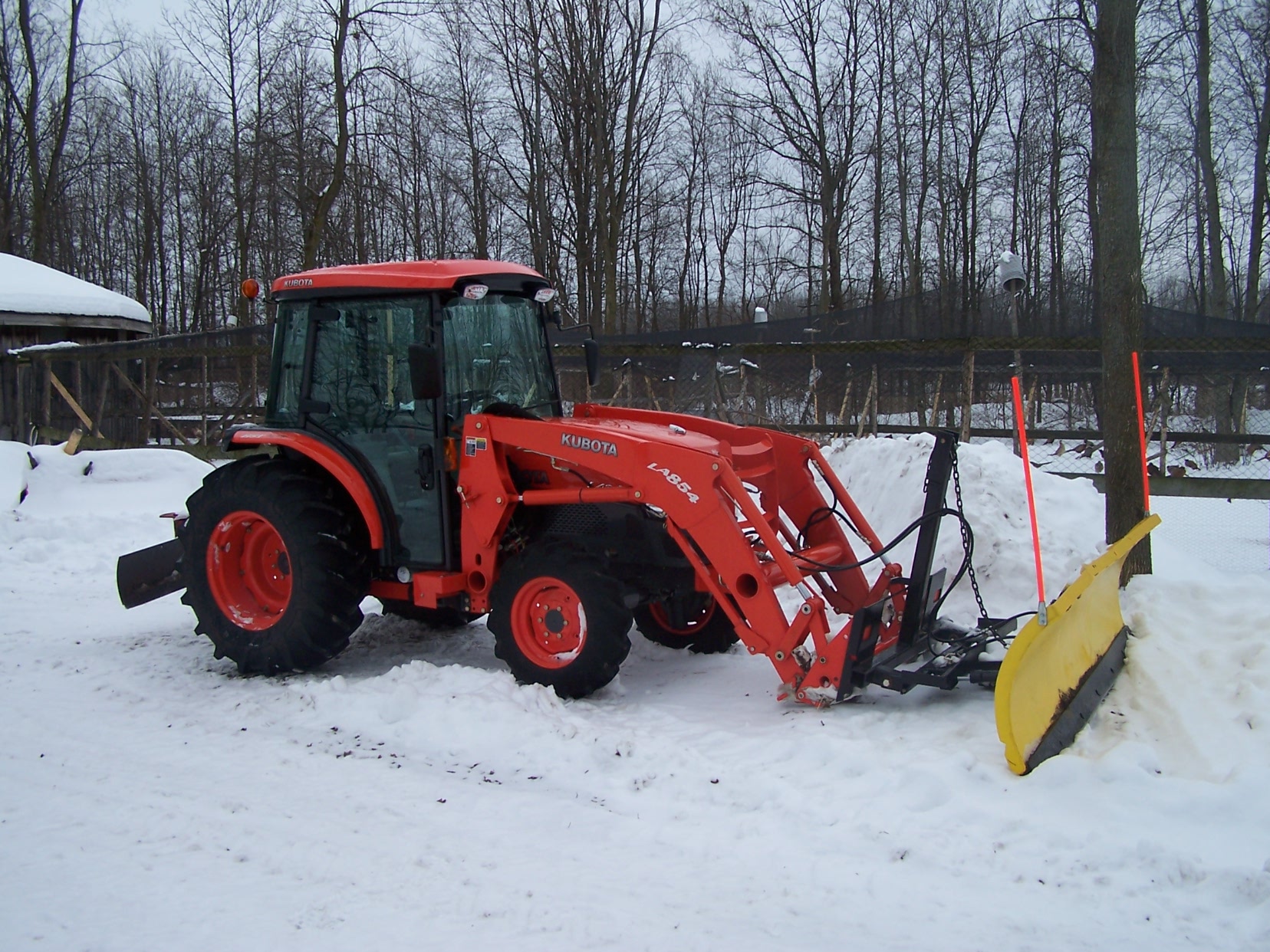

Some people weld plow pin mounts to the QA plate and a grab hook at the top for the lift chain so the plow can hang on the QA just like it would on a truck.
Mine is welded to the QA plate and I use the loader arms to set it level on the ground. The angle on mine is controlled from hoses off the rear remotes. The plow has a built in trip edge.

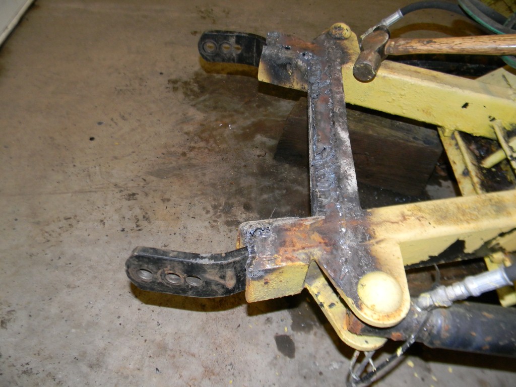

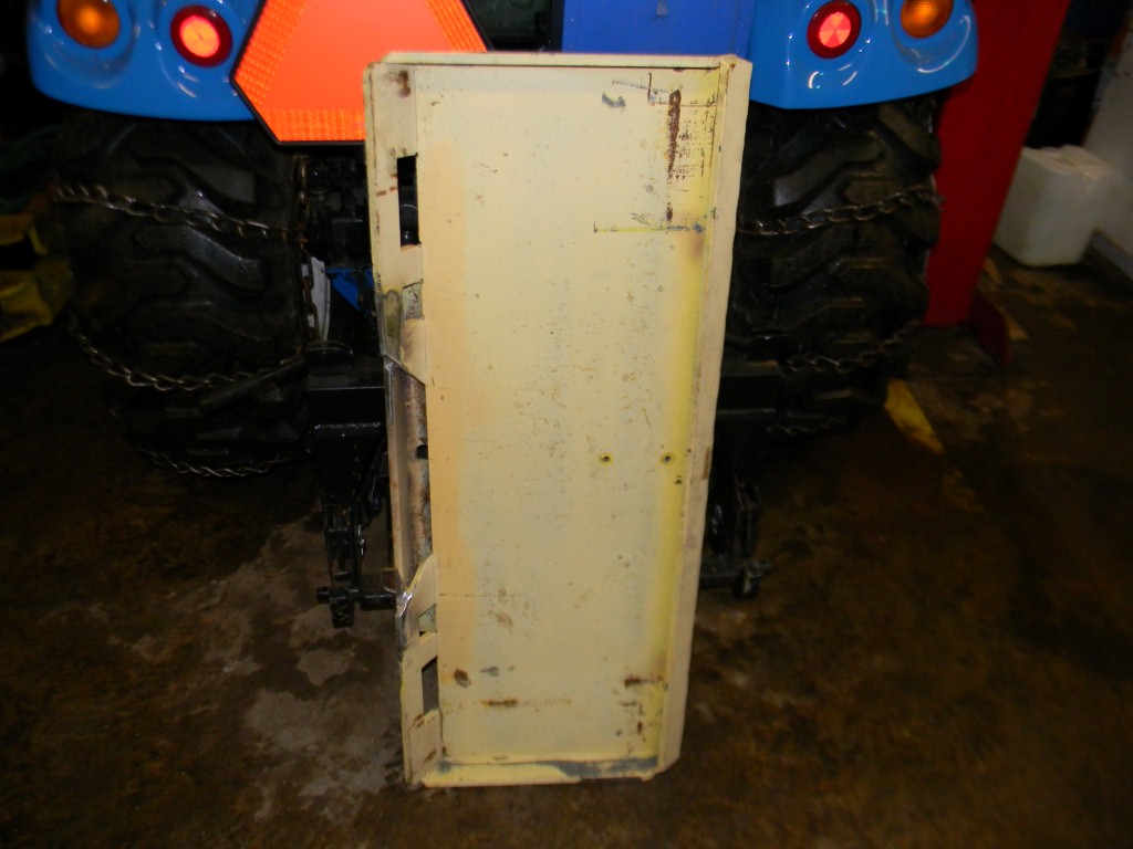

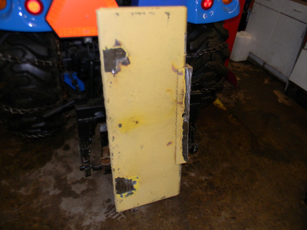

I had some spare time today and no major snow in the forecast so I decided to start the conversion of my plow from fixed blade to floating blade. I got my welds cut off to separate the QA plate and used the grinder to clean it up the remaining welds. Man, that 1/2" thick QA plate is heavy. Tomorrow I have to buy some hardware and build or buy a new pair of saw horses. The weight of the plate broke my cheapie HF ones. They are supposed to hold 200 lbs. but I found they wouldn't even hold my 150 lb. plate. I made some 1/2" thick brackets that will slide in the plow as shown and be bolted in place (the original eyes were cut off).
