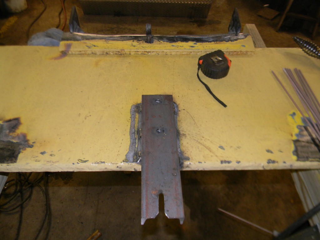

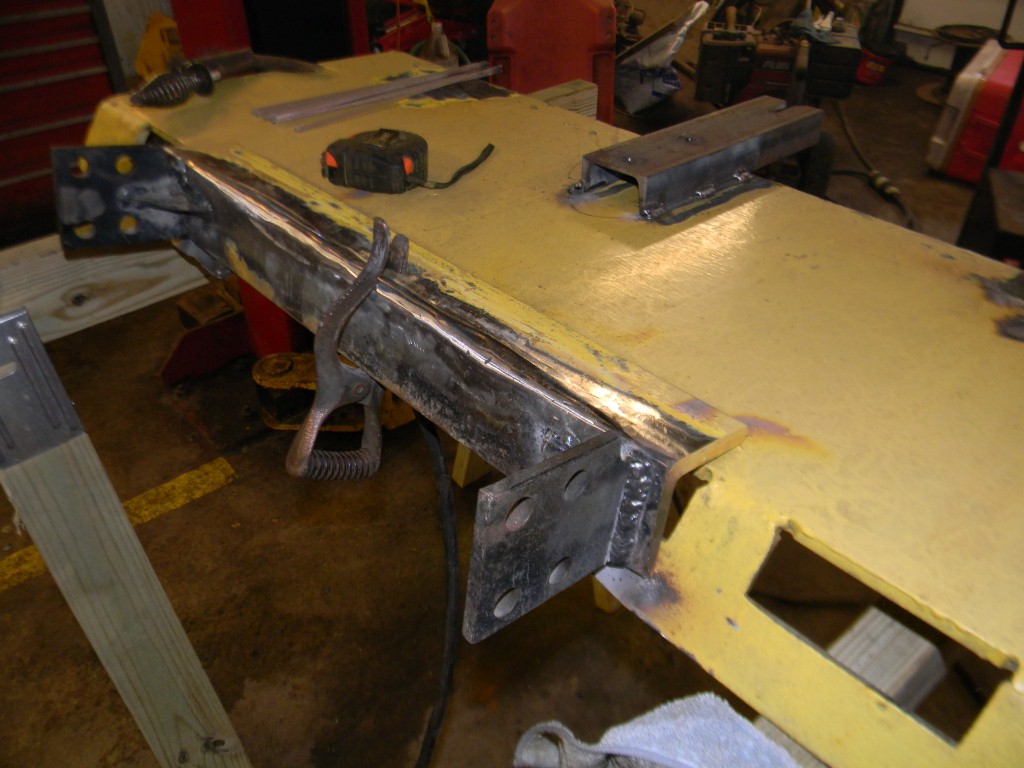

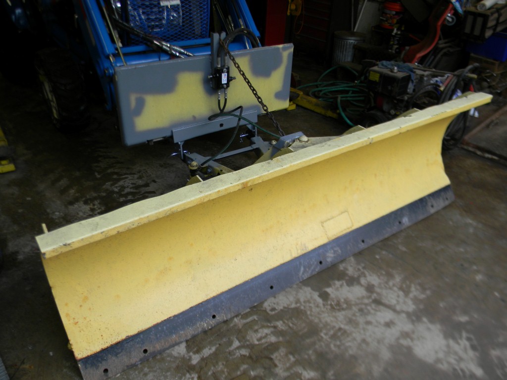

Finished up my snow plow mods. In my original design the plow was fixed (welded to QA plate). Now the plow hangs on pins under plate and chain lift on top just like a regular truck plow and will float.
First pic shows tabs welded to bottom of QA plate.
Pic 2 is a piece of channel welded to top of plate with slot cut for chain.
Pic 3 shows A-frame with new cross brace welded in, holes drilled and brackets bolted in.
Pic 4,5,6,7 test fit hanging A-frame to bottom of plate and remount cushion relief valve.
Pic 8 ready to test on next snowfall.

   / Advice needed please Converting a Curtis snow plow pin frame to a quick attach #19
Thats basically how my old plow was mounted & it worked well.
My new plow has as solid mount... for now. I'm likely to unbolt the A frame from the SSQA & put a hindge on the bottom & chain or telescoping rod ontop to flex. Need to run it stock through at least one snow before I start modding.

George2615:Looks good;it will be interesting how you find it works for you.A direct comparison using the same tractor and plow.Let us know.
I am in Northern NY,St.Lawrence co. and have plowed exactly one time this year.Unreal year so far,plenty of rain lately and above freezing temps.My friends in Washington State are getting "our" normal winter.
