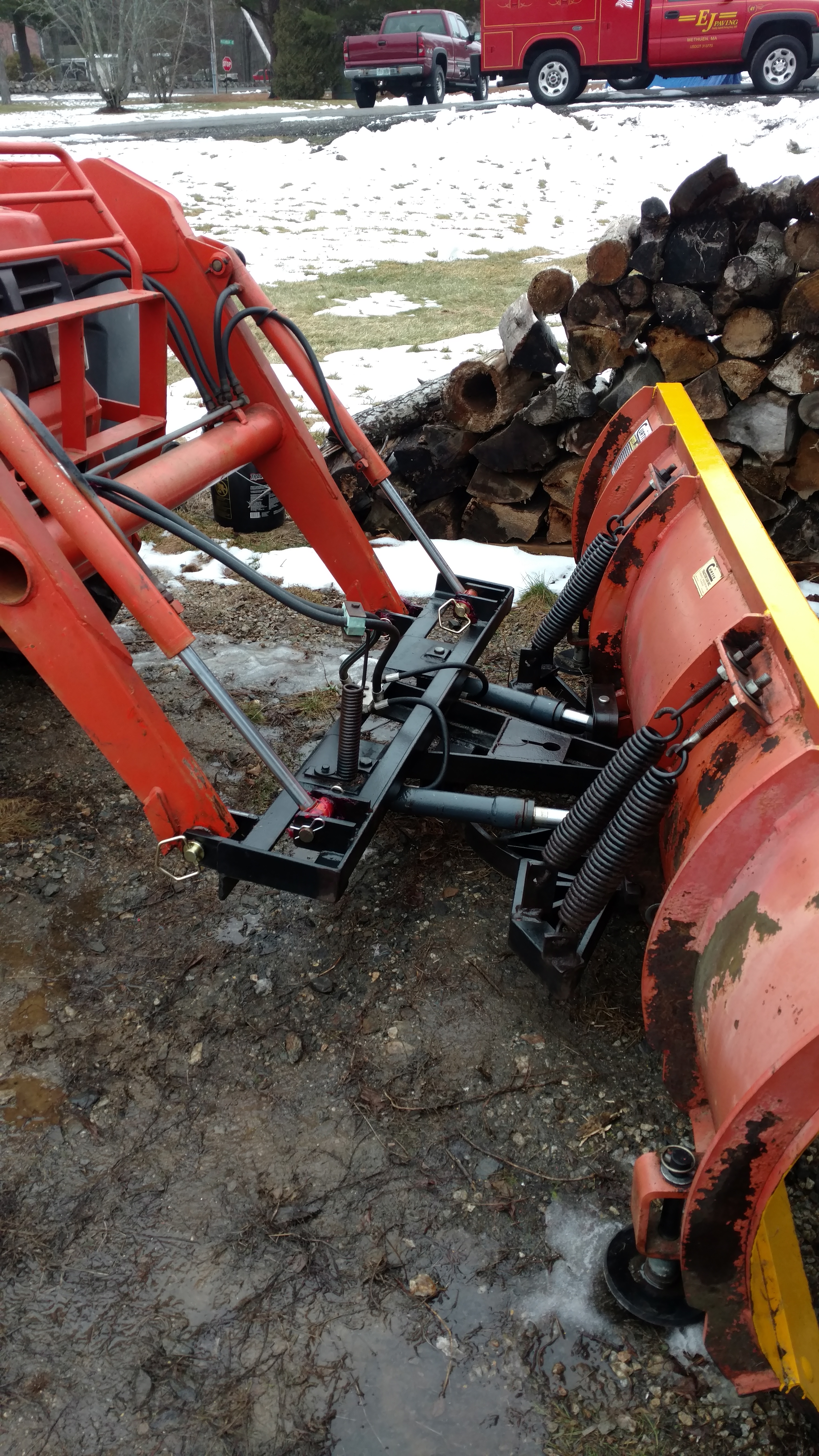

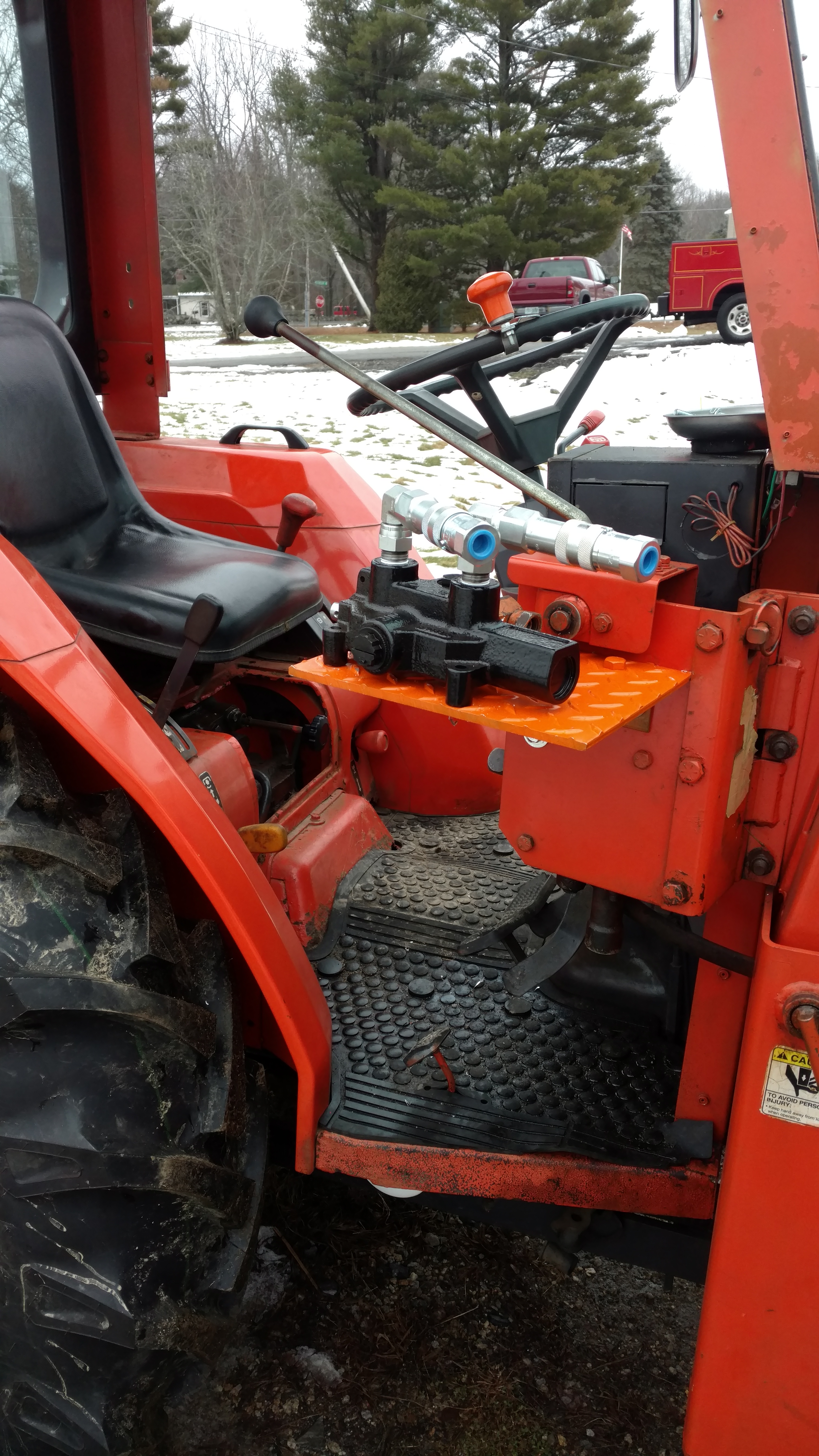

Here are some pics folks. Started the hydraulics today with a good friend who owns a mobile hydraulics business. He plans to tap into the power beyond and the loader valve. A $93.00 Prince 3-way, some fittings and hoses. Hope to finish the hydraulics later this week.
I will post more pics and details. Below is some pics that include the new second valve which will operate the two existing plow pistons. Here is a shared link..
Shared album - Joe Scotti - Google Photos
I will up load the photos shortly.
Thanks folks!

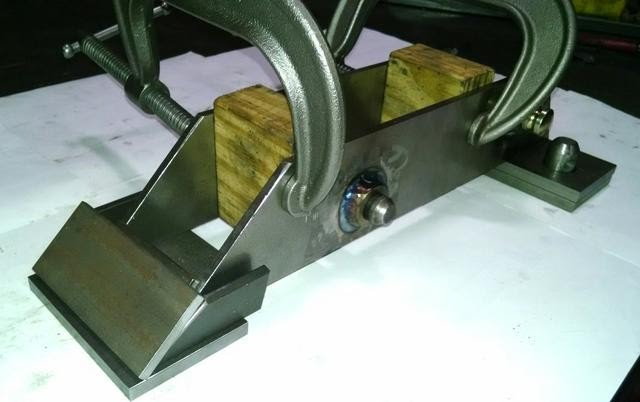

Here are my pictures. Suggestions on adapting the plow frame to a quick attach plate which should arrive tomorrow along with the quick attach adapter. I saw one member who fabricated a set of pin plates which I also in included as the last picture. Thoughts.... 1485112044707.jpg

Sorry the example is the first picture. I want to thank that member for posting his setup!

I think this is what you are talking about. With this type QA you would cut the tabs off your bucket and weld onto this so you can pin it on your loader arms.
Pin On to Skid Steer Quick Attach Adapter Latch Box Kubota Bobcat Weld On QTK
Then you need a plate like this to weld onto the bucket in place of the removed tabs.
5/16" Quick Attach Loader Cut Out Universal Mount Plate skid steer bobcat kubota | eBay
George, thank you. How would you approach the plow frame?
